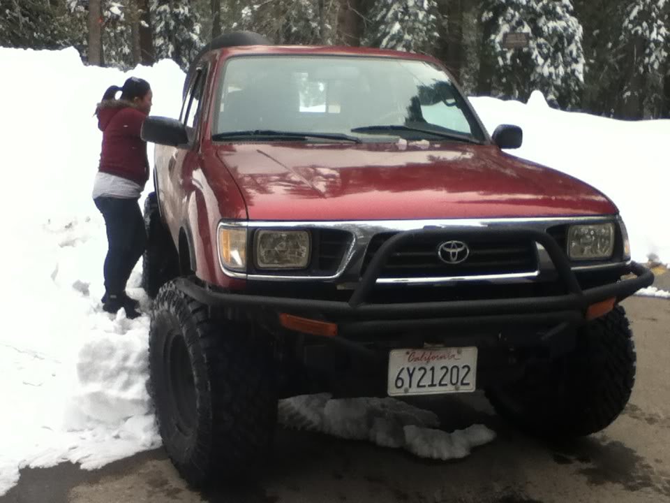

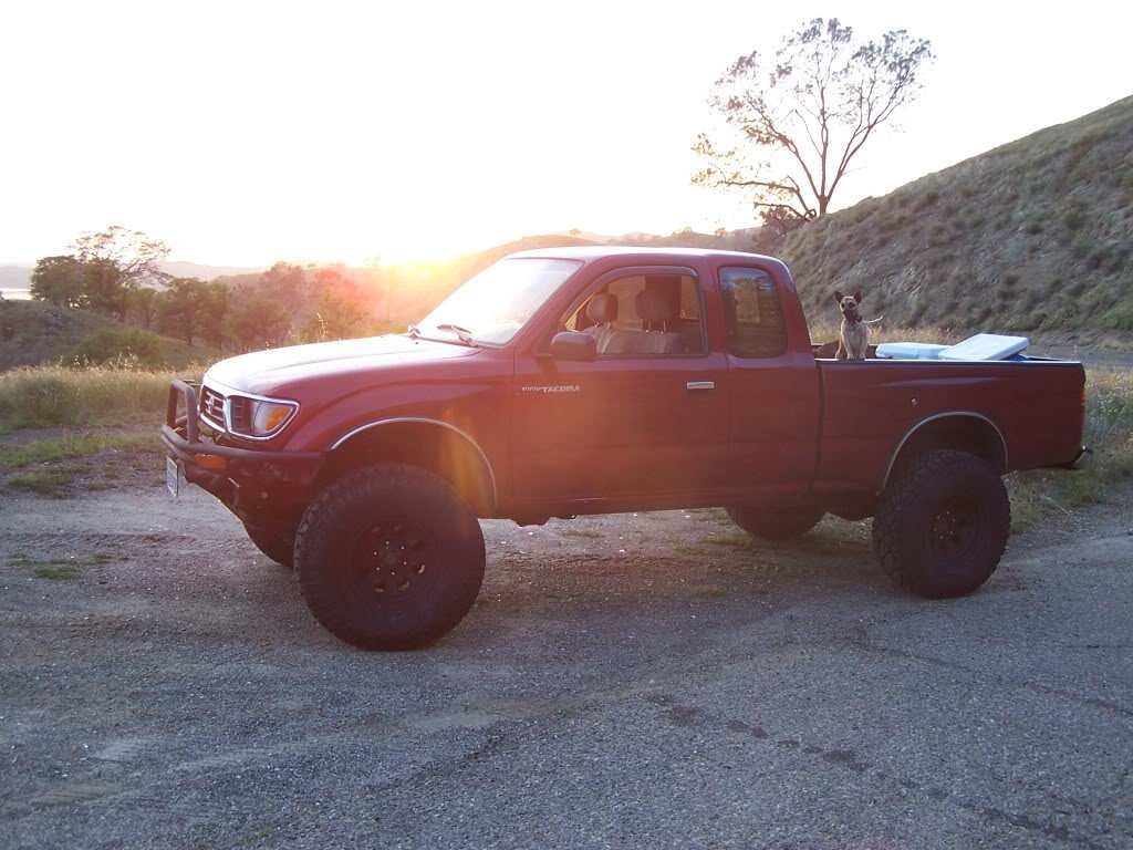

    I finally gotten to make a build thread of my rig. I never wanted to make a build thread, but I gotta post up all the progresses I had put into. I had this tacoma for 8 years now, before I had not thought of modding the rig. Until I found this TW forum and it expand my likes of this rig. Bought it at 69,XXX miles then and now at 205,XXX.

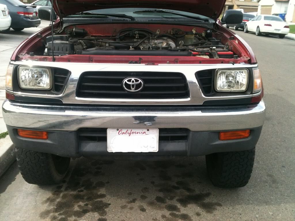

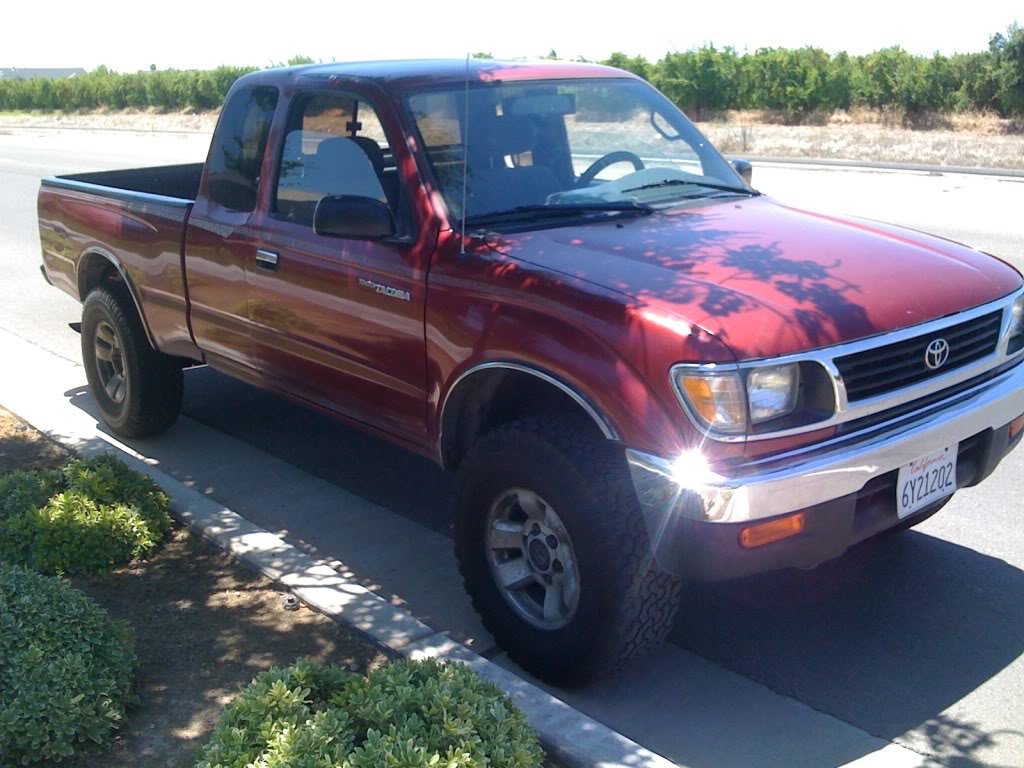

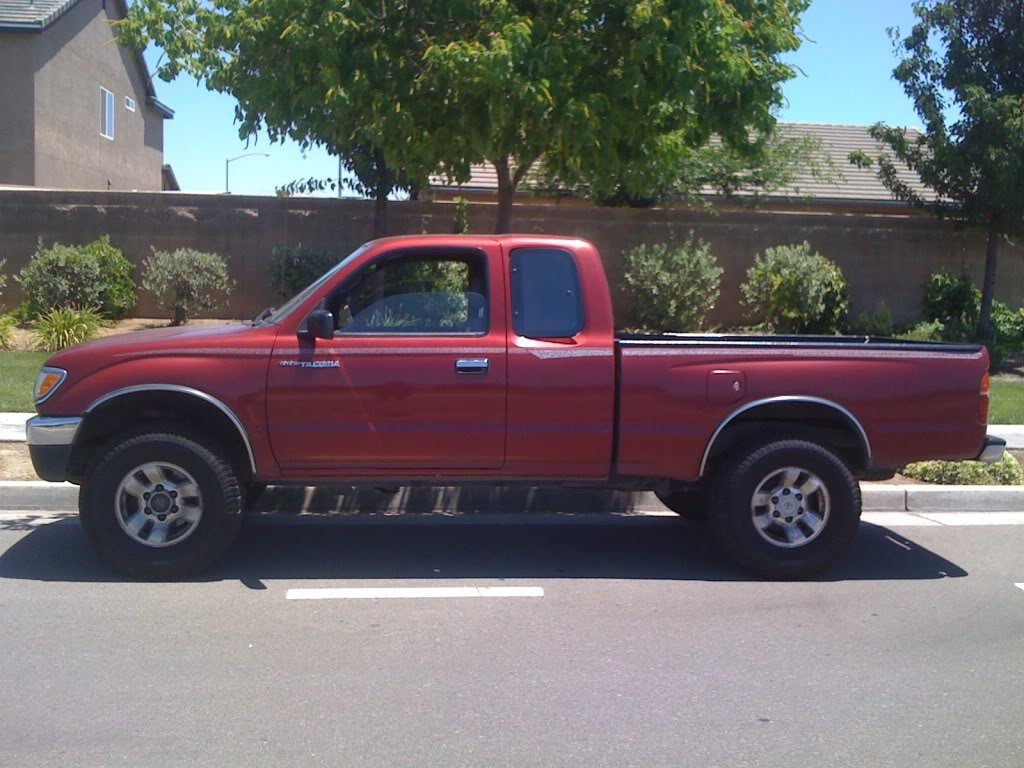

    before:
    mods:

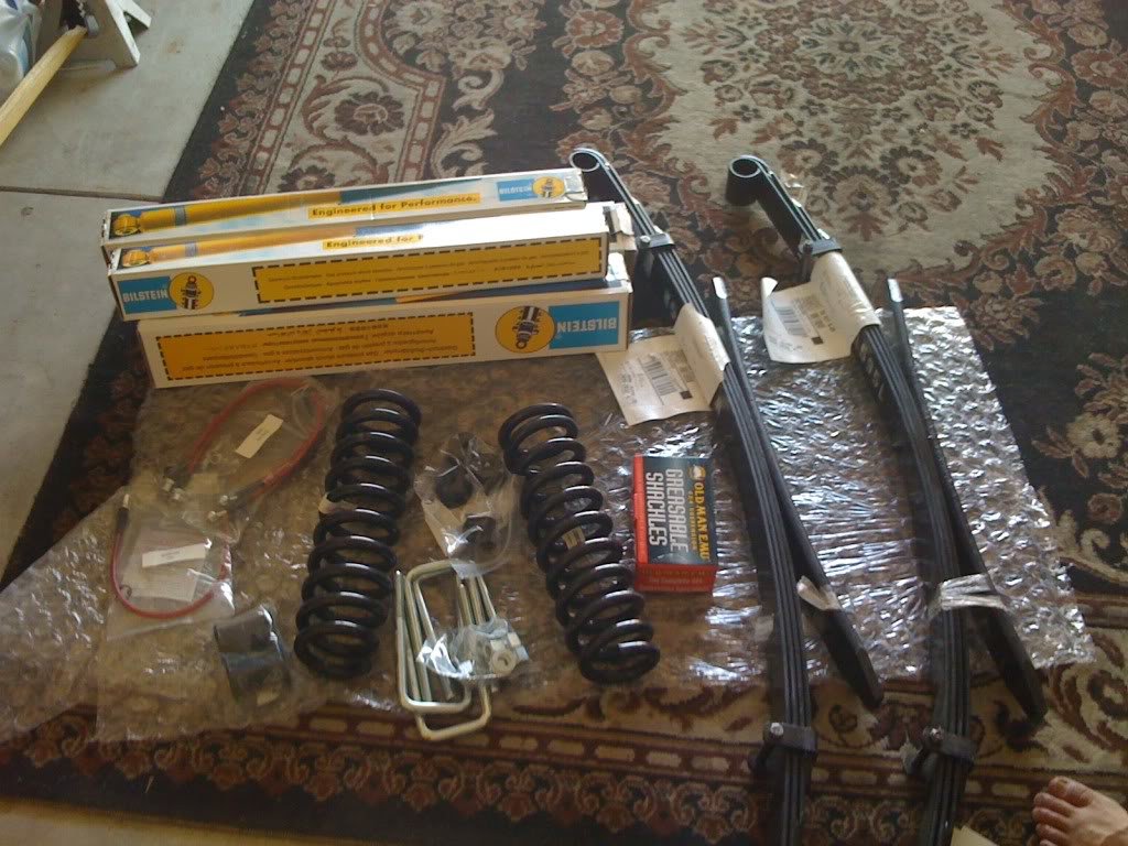

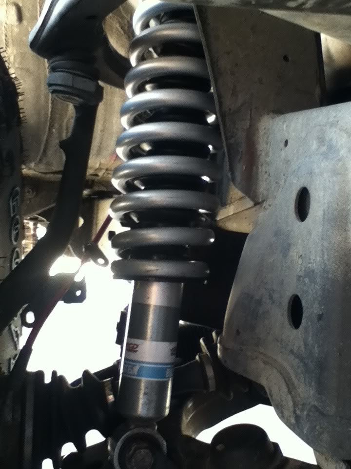

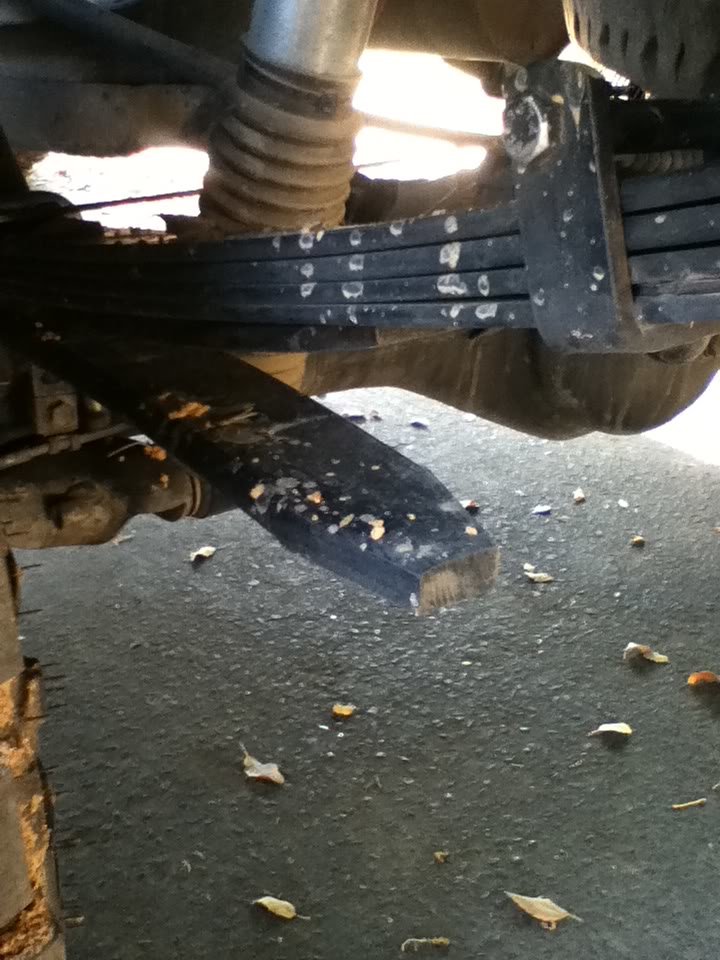

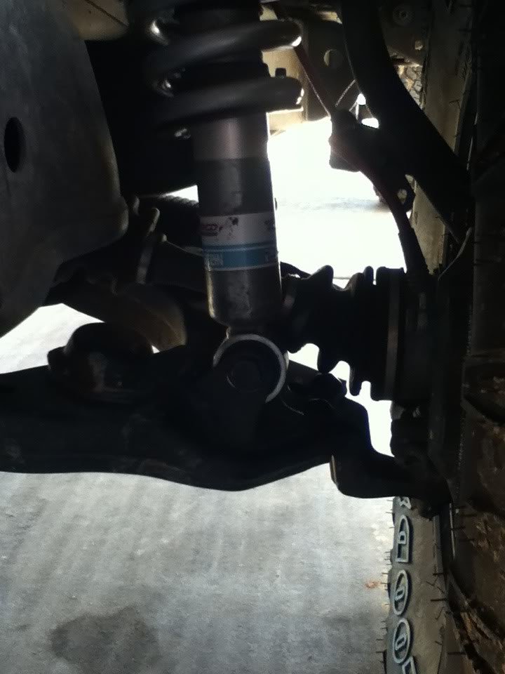

    suspensions lifts with bilsteins 5100s front and rear with eibachs springs
    had ome 881, sold it.
    wheelers 5 pack leafs with toytec 1.5 aal in the rear
    greaseable shackles
    stainless brake line replace on front and rear
    engine:
    deckplate mod
    exterior:

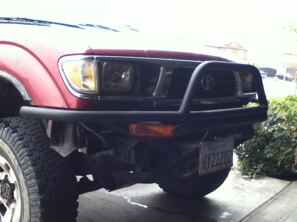

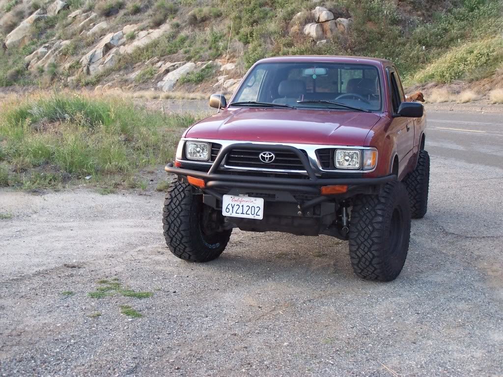

    for the front bumper, i got a TG low pro bumper with light bar.

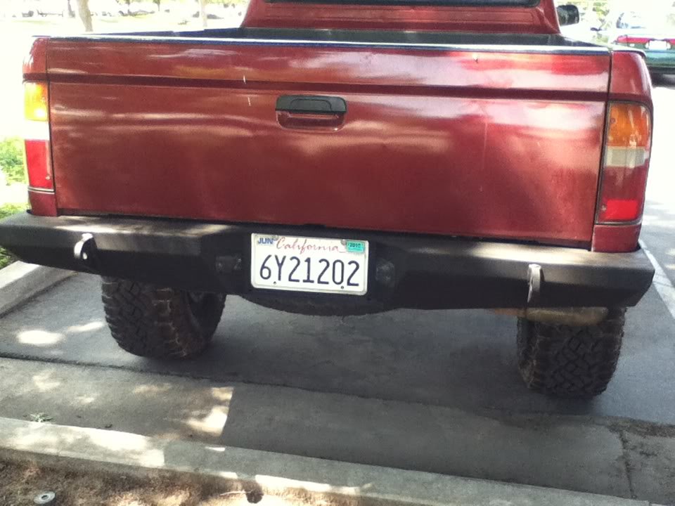

    BruteforceFab custom Rear bumper
    interior:
    apline headunit
    pioneer 3 way speakers

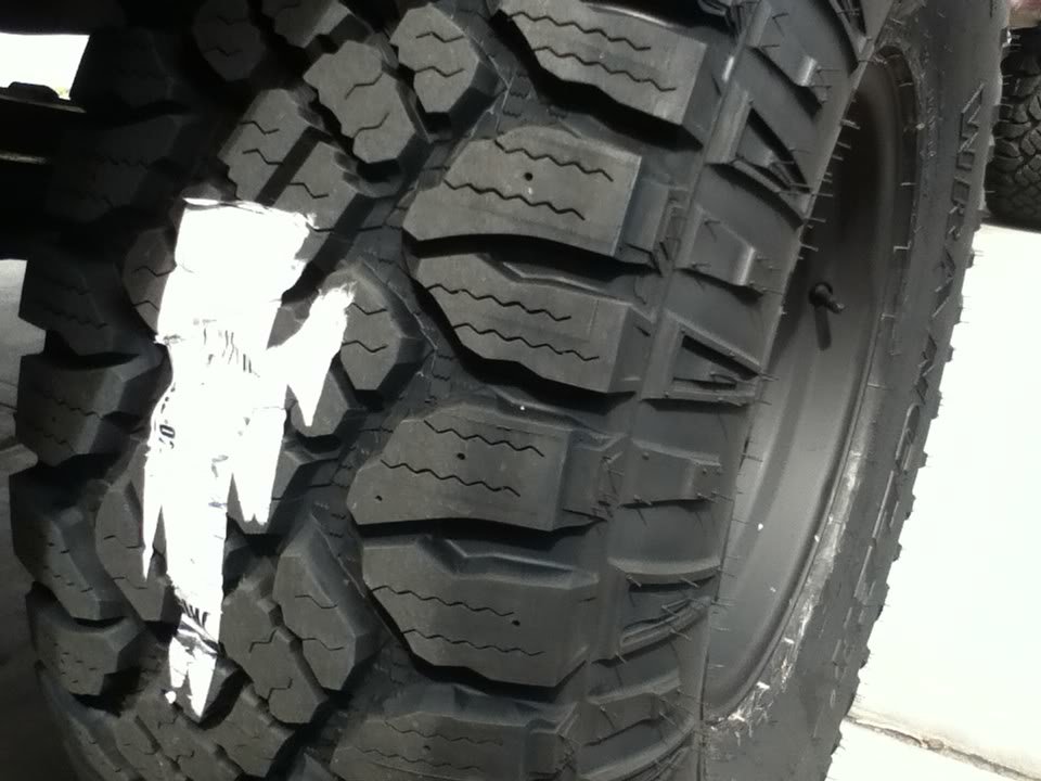

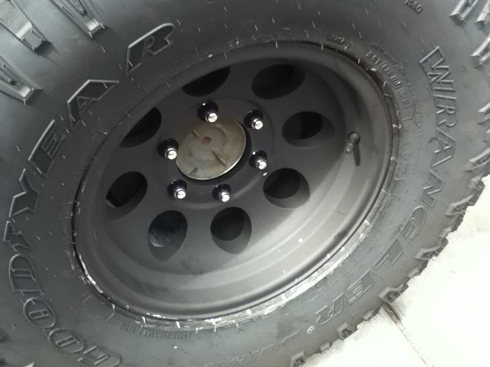

    wheels and tires:
    procomp 15x8 7069 series flat black
    with Goodyear Duratrac 33x12.5x15
    as i found out about TW, mods had started and drain my wallet.

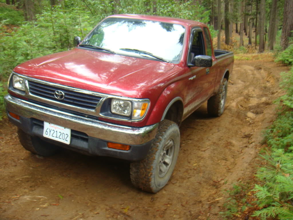

    did some little trail runs during hunting seasons.

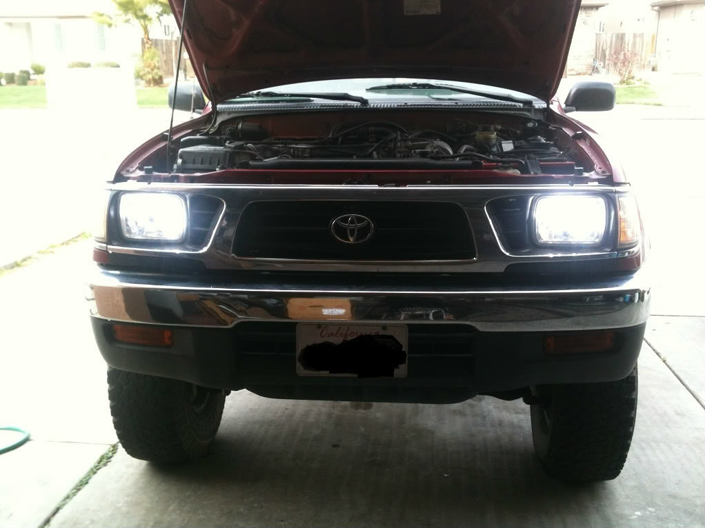

    swap out the sealed beam headlights to the 7x6 with 6k 55watts HIDS.
    swap out the front grille of 2wd to the 4wd original.

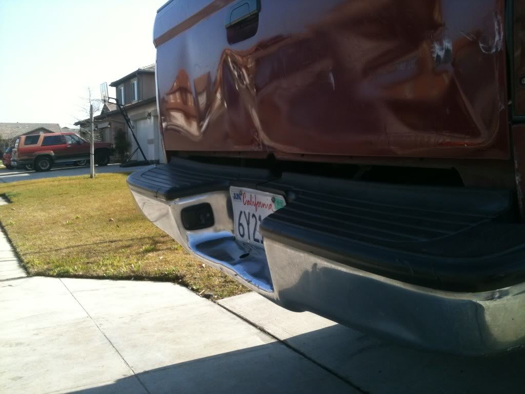

    one day, my tacoma was rear ended twice by the same woman and dented the tailgate and the rear stock bumper.

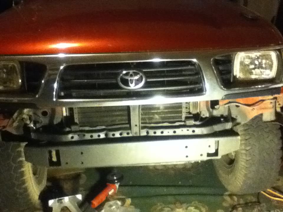

    so i got these,

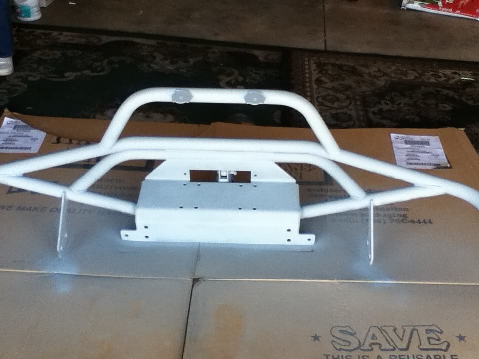

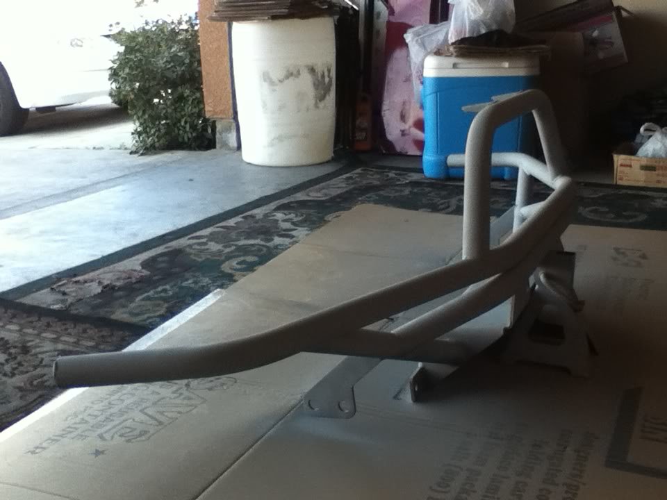

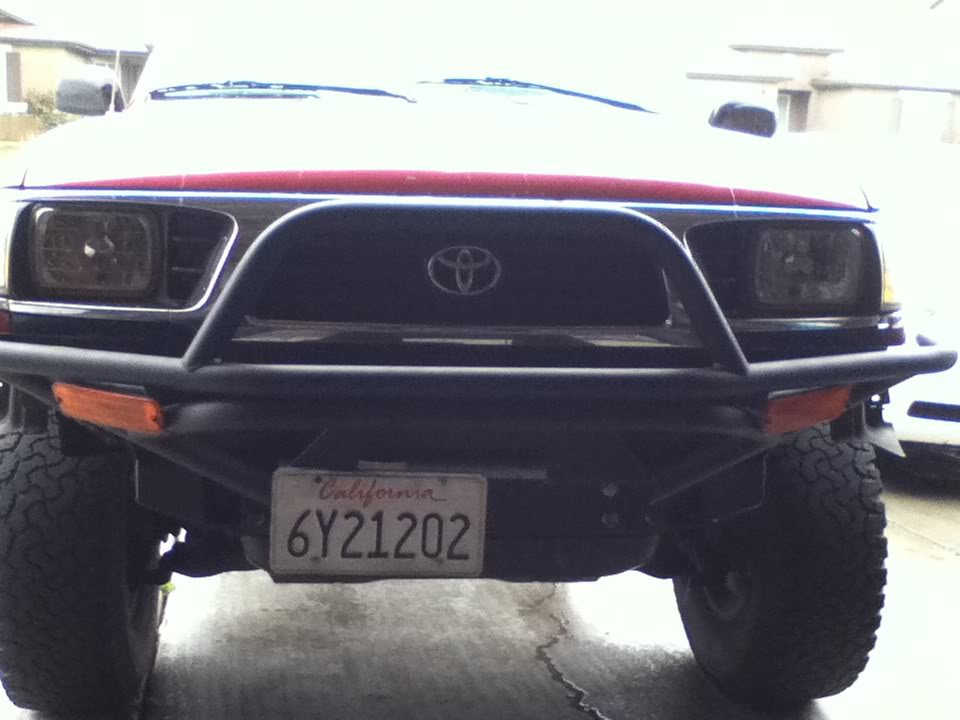

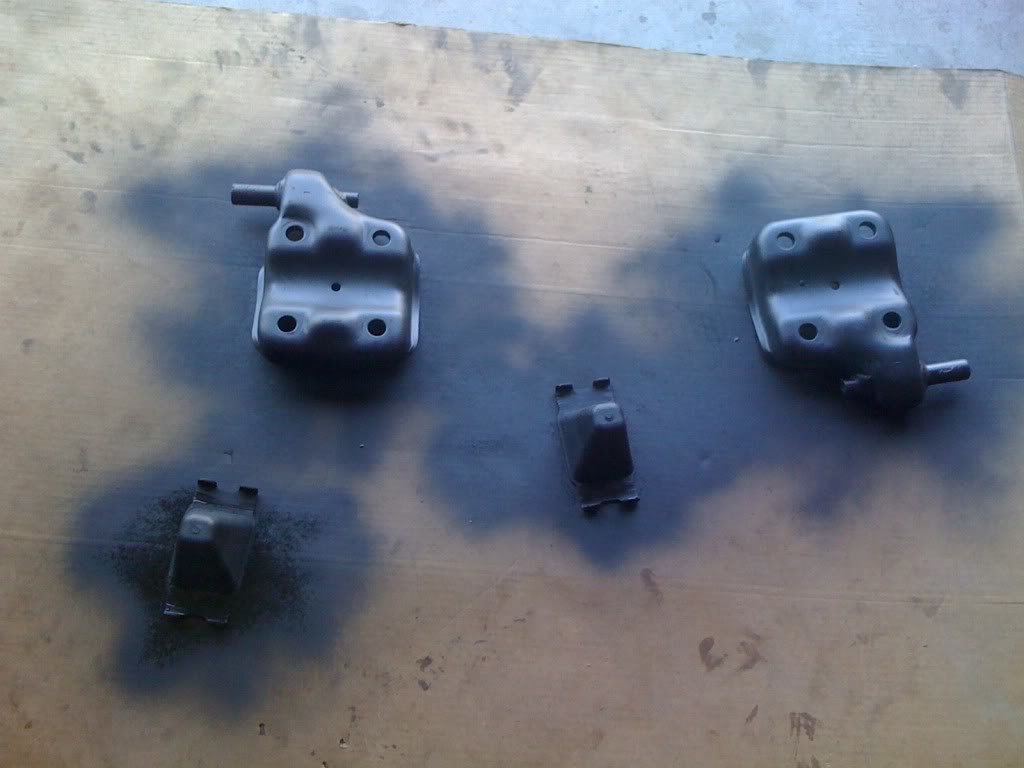

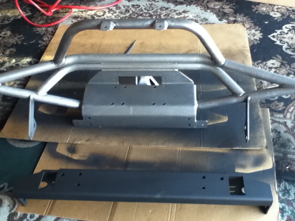

    TG front bumper low profile with light bar, sand down. primer and then use walmart truck bedliner to spray paint the bumper.
    installing at the moment:
    had it grind here and there to fit the bolt up holes, eventually for the driver side, one hole didn't line up with the bumper. i left open and one i use a different nut and bolt to hold it up.

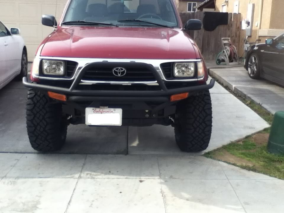

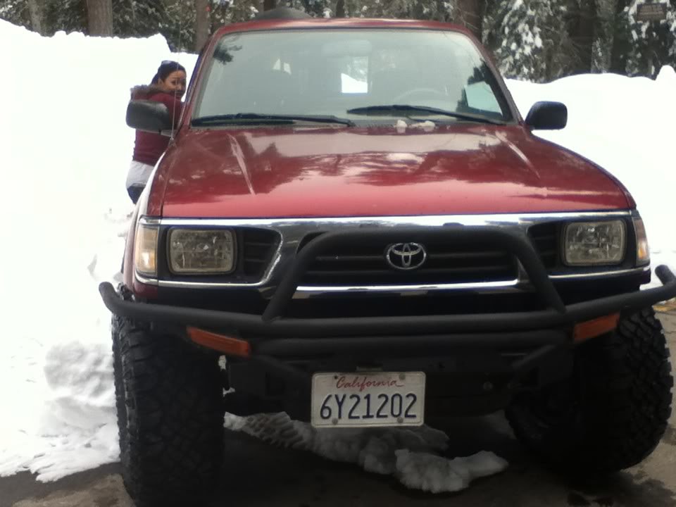

    bumper is finish and bolt on.
    wanting to get new rubbers,

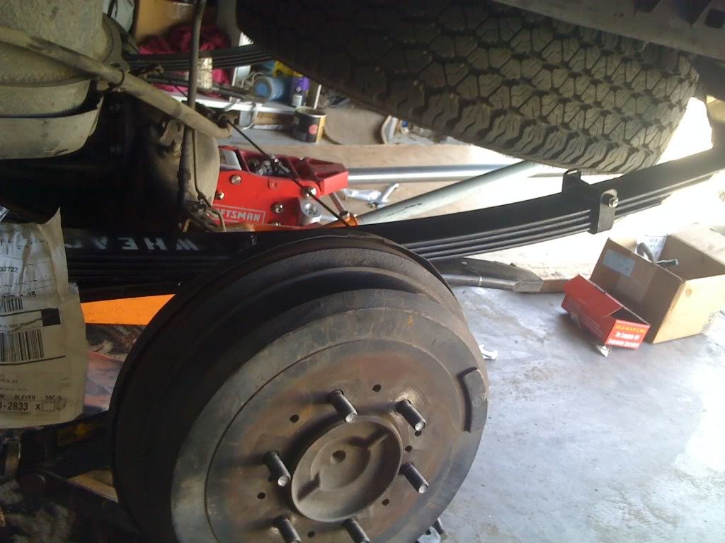

    i had replace the coils from my old set ome 881 to eibach, i get 39.5 at the front. add aal to the 5 pack and put back the greaseable shackle to get 40.2 inches from ground to fender at rear.

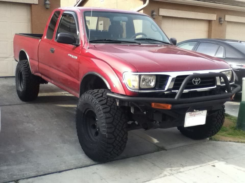

    after the eibach swap, cv axles are at a bad angle even with the diff drop.
    after a few months later, contacted

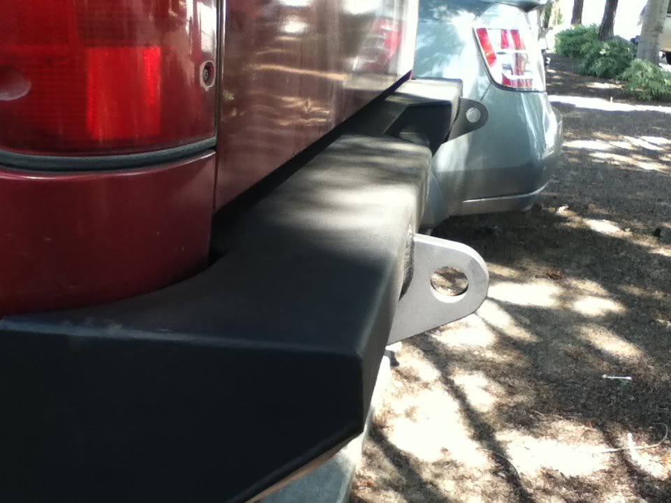

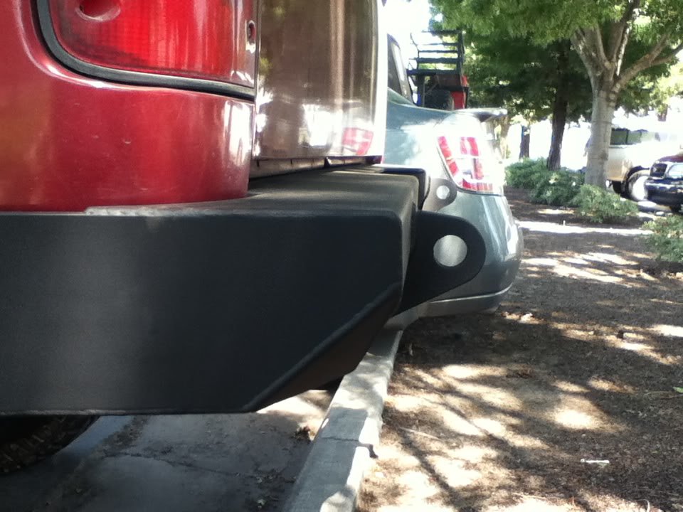

    Billy at BruteForceFAb and had him made a custom 1st gen rear bumper.
    solid and peace at mind.

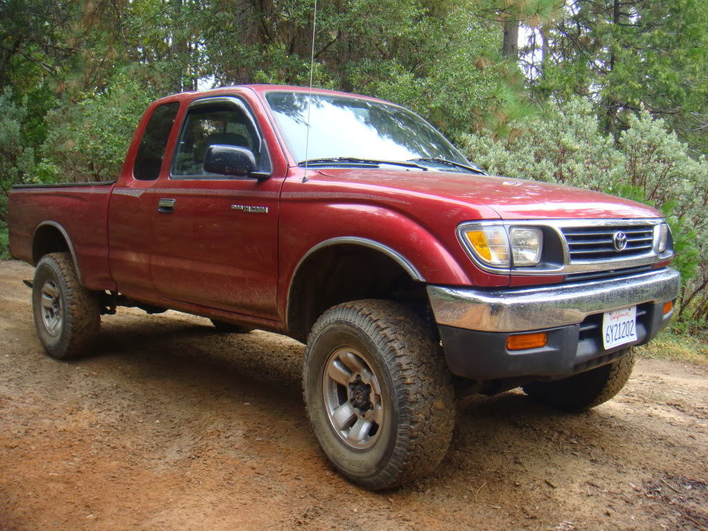

    some pictures
