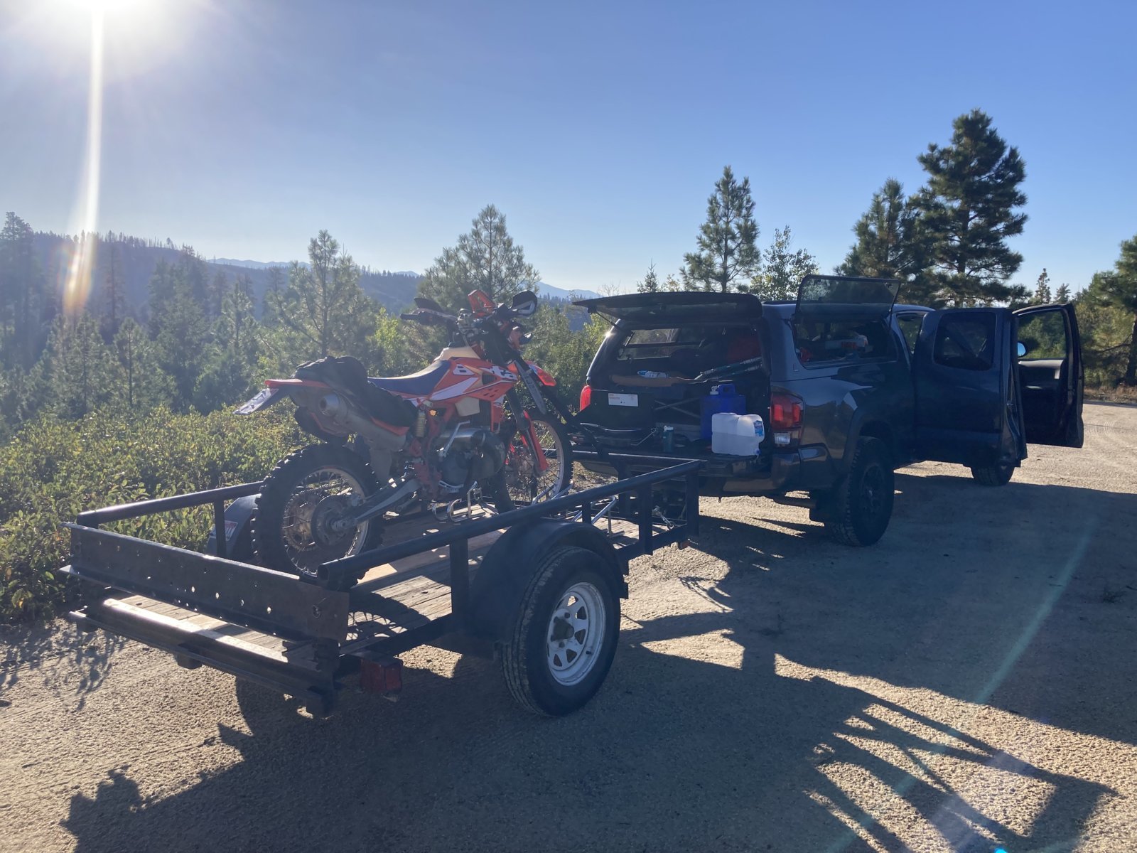

    While not in the exact same boat I can share my experiences thus far.
    I have a DCLB Tacoma and a R1250GSA.
    I would never consider loading and hauling a full size (or even 700-900cc) adventure bike in the bed of the truck. My only exception would be if you were always going to unload and load the bike at a location where the area to unload/load is at the same height as the truck bed. If I had to guess I would say this is not likely.
    The big adv bikes are simply too large for me to safely load and unload them. I am 6'3" with a 36" inseam, so I can straddle the 1250, even at the max suspension setting, and I still had trouble and concerns when loading the bike onto a trailer.
    We originally opted for a small tow behind trailer, just big enough to haul the bike.
    We have already ditched it. Even with (6) straps to secure it, we still had to drop our off pavement speed to around 5 mph. The bike just got too wild.
    [​IMG]Diesel Heater Install and Slider Repaint by Michael Rickerd, on Flickr
    For a size comparison, as I doubt there are many of these types of images floating around. The GS is just fucking massive.
    [​IMG]Trailer for R1250 by Michael Rickerd, on Flickr
    We now simply pilot both vehicles at the same time (for full transparency, my wife and I live out of our Tacoma, and she is a competent driver of the truck and currently building up her skillset for offroad motorcycle travel). This is the way to go for us.
    [​IMG]Vail AZ - Tacoma and GSA by Michael Rickerd, on Flickr
    [​IMG]Tacoma and GS by Michael Rickerd, on Flickr
    If you have any other questions just let me know.
    Also, your tailgate won't have a problem supporting that load while loading and unloading the bike, or while transporting it.
    If you do decide to simply load it into the bed of the truck, film that shit, as I want to see how tough it is. Just getting ours onto the trailer was interesting.

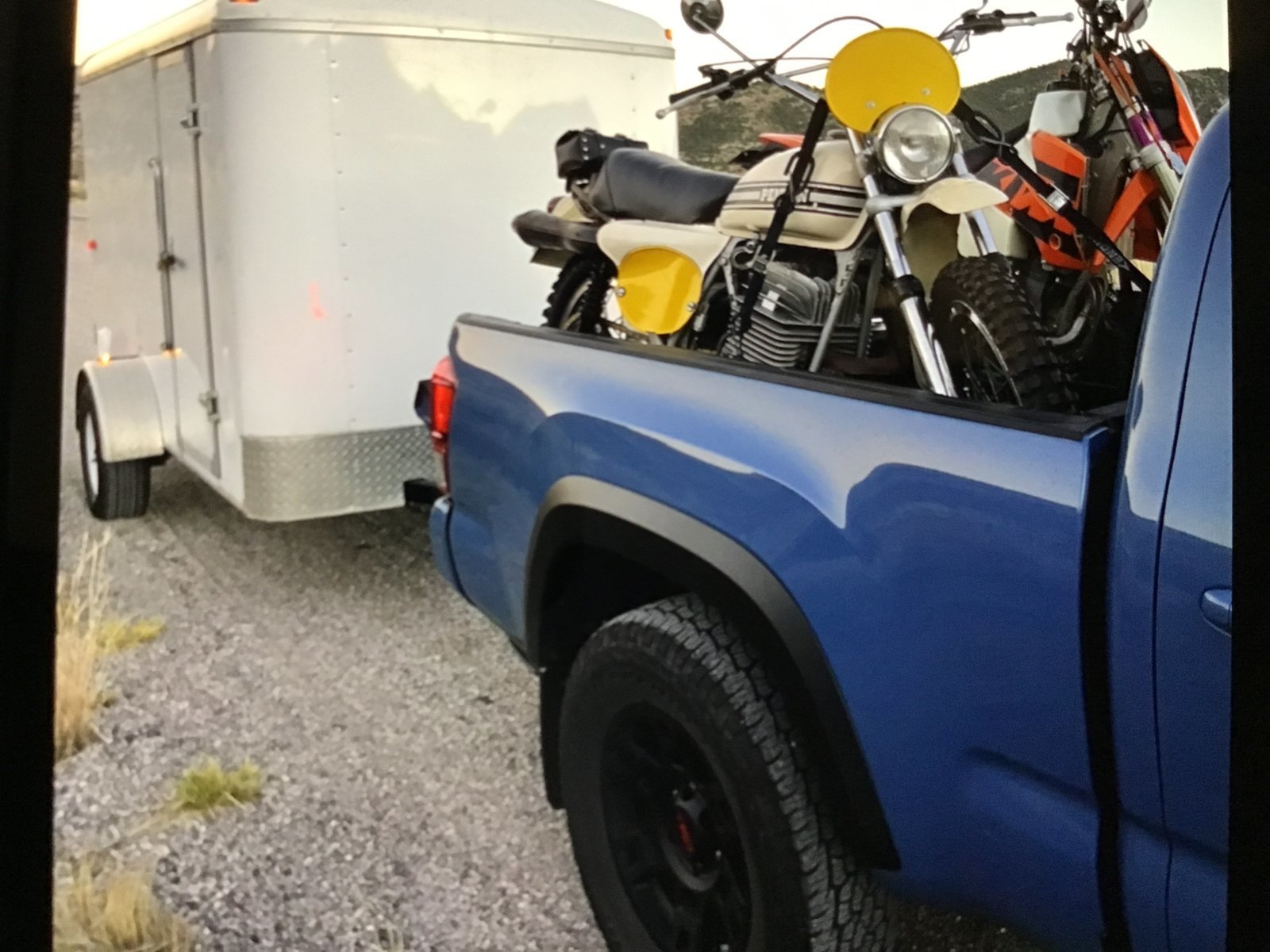

    I have a 2019 Tacoma DCLB and hauled 2 dirt bikes in the bed while hauling a 6x10 cargo trailer with 2 more dirt bikes inside from Oregon to Arizona. Loaded trailer weight approximately 1800 lbs. 2 dirt bikes in bed approximately 500 lbs. total. 65 mph average for trip about 12 mpg. Truck had no problems. For loading motorcycles into a truck bed the StepRamp made in Idaho is the safest method in my opinion. I do have Sumo Spring bump stops blue version on my truck. I towed with the tailgate down but the wheelbase of the bikes were short enough no weight was on the tailgate. image.jpg

    I confidently hauled a 2014 Yamaha Fz09 500+ miles when I moved from Ohio to New Hampshire. Plus I sit on my tailgate all the time and at 230lbs I never worry about it so I doubt it’ll be an issue for a 500lb bike. I wouldn’t be scared to put my Husqvarna Norden in as long as the bike isn’t too long for my short bed.

  10. Feb 19, 2024 at 7:31 AM
    Rapidfire1
    Rapidfire1 Well-Known Member
    Apr 30, 2016
    #185709
    126
    Shaun
    York Pa
    2016 Black TRD Sport DCSB MT
    Sweet Penton!
