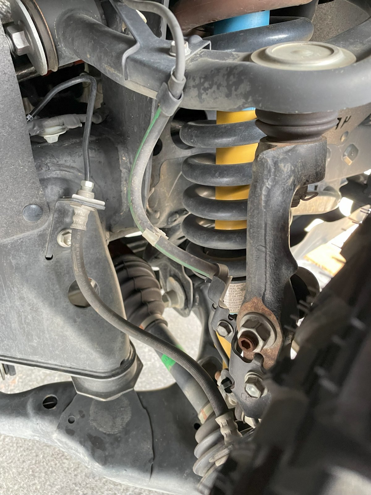

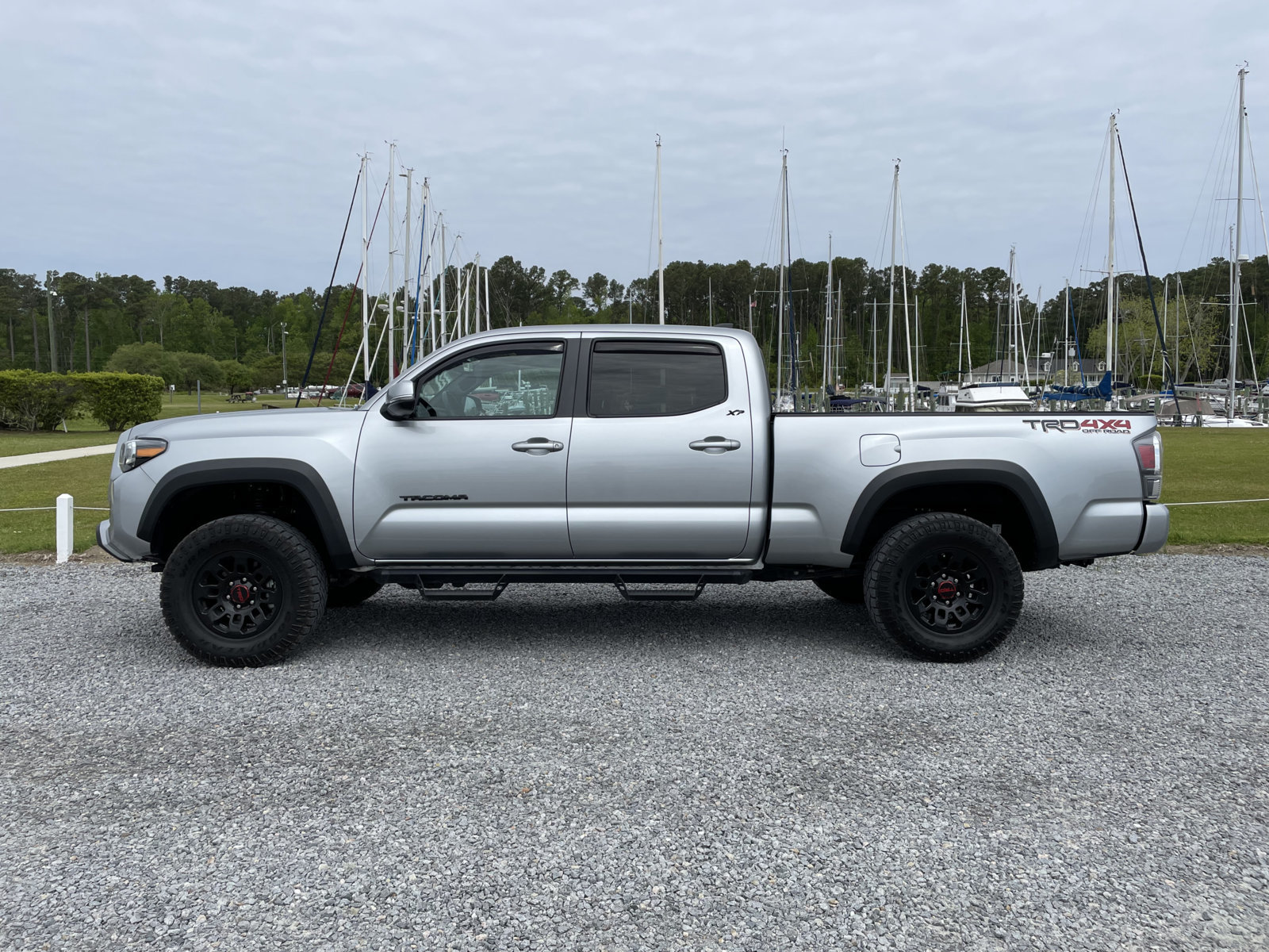

    I've had it for about 10 days now and thought that it sagged in the rear. Then someone else commented on it.
    I had the GS in the back, which is about 550 lbs. But the bed is empty in the pic above. Is this normal?

    It looks like the front was lifted to "level" the truck and Yes, it does look kind of squatty.
    Look at the front coils for a spacer, bet that's it. IF it is a front spacer lift, it is relatively easy to remove.

    Pics of the suspension are at the top of this page. If there is a spacer in there, I suppose it's just out of frame in the upper pic?

    Correct, it would be above where you took the first pic.,,, at the top of the spring.

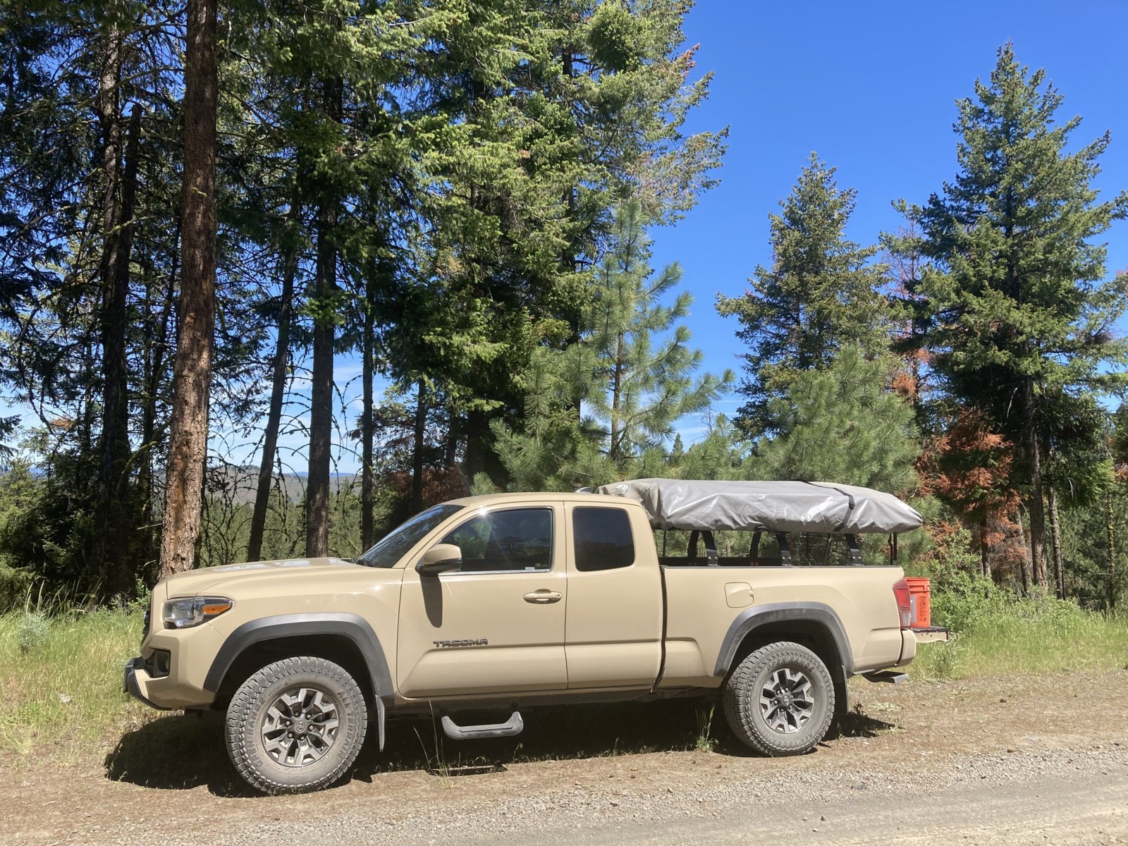

    Had them on my truck for several years. I’ve hauled rock and my RTT and these really do work.

    My RTT weighs about 125 lbs and with all my camping gear in the bed she still sits level. Seems to work fine off road as well.
