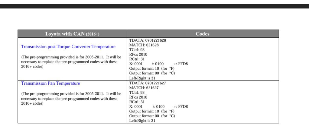

    I'm at a loss here. Can someone either post the ultragauge settings or confirm that the below are correct for a 2021 tacoma?

    There is another post on here that I found my settings on but I don’t remember who posted it. Those look like the settings that are on mine.
