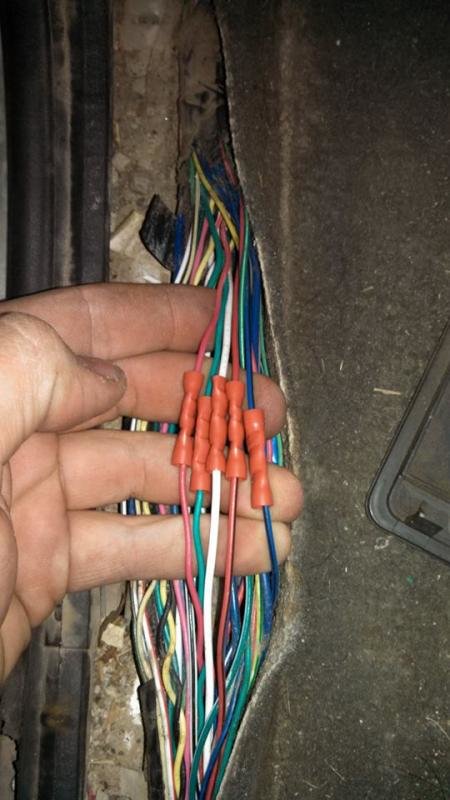

    I installed a sound system last night and everything was going great... I was finishing up when i tried to fasten down my plastic door trim piece with a self tapping screw. I remembered the bundle of computer wires underneath a little too late. I hit the bundle of wires under the drivers side kick panel with a self tapping screw... Because I'm a moron. I repaired the pictured wires but I think I fried a computer or something because now it barely starts and when it does the throttle doesn't work until half way down, and when it revs up it hits 2000 rpm and sounds like it hits the rev limiter. Not to mention I have more than 9 OBD2 error codes. All the error codes (that I can read) are for air flow sensors, throttle sensors, and stuff like that... It blew the breaker that controls my power locks as well. It's my own personal hell.
    I've checked every fuse i could get my hands on, I pulled the EFI fuse for an hour, and I pulled the little computer box out of the kick panel and visually inspected the circuit board inside and couldn't see any damage. I can't think of anything else to do except pull the ecu and take it to a dealer for testing... unless someone knows something else i can try.
    Here's the wires I hit.

    Maybe try nd take the negative battery connector off for a bit? It might reset the computer? :confused:

    Yup, easiest stuff first. Pull the positive post terminal for a minute or so. reconnect, Key then on and listen for a few seconds,,,then roll key to start.
    Watched our crew chief stab some wires on a $150K Outlaw 10.5 car,,watched the lightning race up the wires and start the meltdown procedure. Luckily, someone was close by and snapped the battery off within a couple seconds. It nuked a Racepak within those seconds. Racepak was very kind to us and sponsored a new one back. Didn't loose any sensors or ignition boards ,,it just got the unit. Racepak uses a 200 amp bar breaker on there big systems and it popped that no prob.
    It melted 4 wires together when it went. Traced those wires and repaired the sections that melted.
    It might not be as bad as one might think.

    Unplug battery for about 10 minutes might help

    It is never a good idea to disconnect the positive terminal first. Always disconnect the negative cable first.
    I agree that a good idea would be to disconnect the negative cable and wait about 30 seconds for the internal capacitors to discharge. Then reconnect and clear all DTCs before restarting. Remember that Toyota vehicles do not always start and idle real well after a reset, so give it time to self-calibrate.

    sounds like my plan of attack when i get back to my truck (it's stranded at work) is to unplug the battery. While it's unplugged i'll solder up the wires and heat shrink them. if that doesn't work it's probably time to drag it to a shop...

    Also make sure all the wiring harnesses are fully plugged into the ECU. When I was installing my remote start, I didn't push one harness back in all the way and my truck started and ran about how yours is currently starting and running. After I pushed it in until it clicked, it ran fine. I doubt you messed with any of those harnesses if you were installing a stereo, but its a quick thing to check.

    You have a 50/50 chance,,pray for a blown ECU,,sadly.
    Just from the looks of your wires you repaired,,and that general area. I think your odds are better and your headed in the direction I would,,fwiw.
    After that to no effect,,start tracing wires back.

    Sounds like you took out the 5 volt feeds to the sensors in the ECM.

    I hope that's all I did... I'm afraid I might have to start chasing down ask these sensors of i blew them too...
