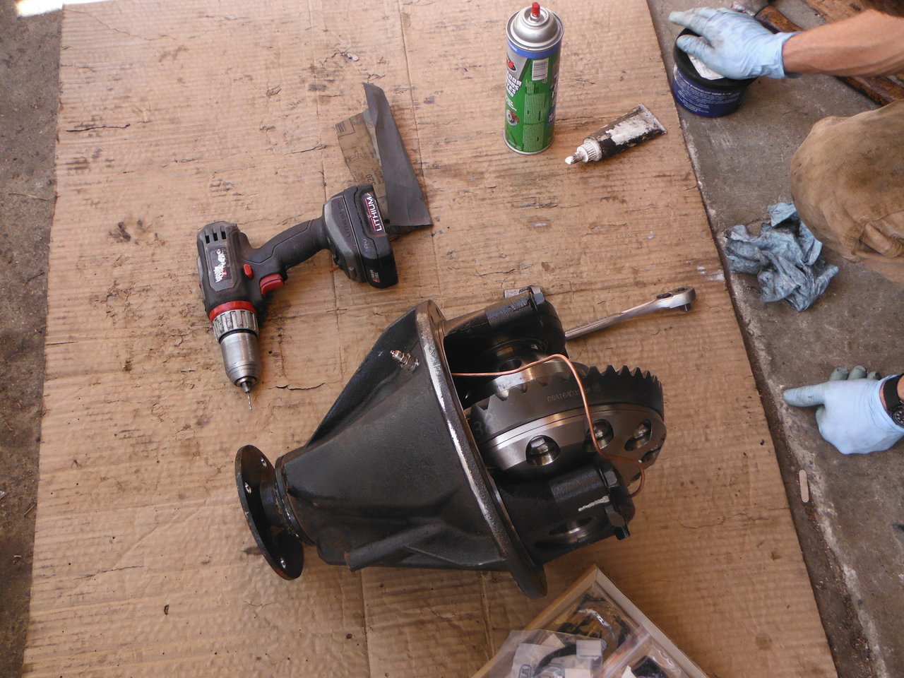

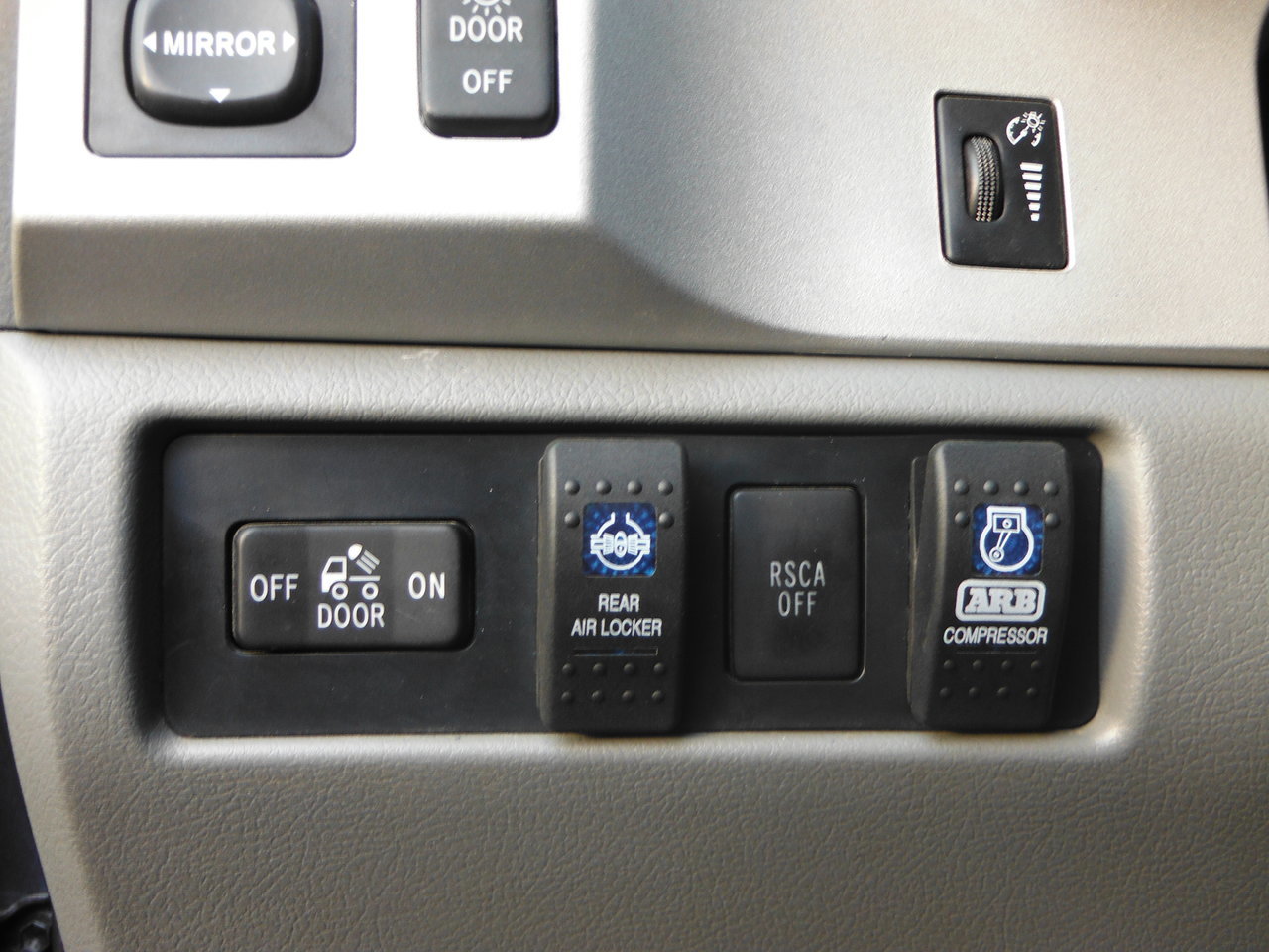

    Lifting a truck doesn't really allow you to run a bigger tire unless you lower the bumpstops to the point you don't have much suspension travel. The tire will still have to go somewhere as the suspension cycles which means that what you really need is a bigger wheel well. Getting some better shocks/coilovers and raising the front an inch or two will do a lot for you. A locking differential is a way better investment than a six inch drop bracket lift.
    Arianna[OP] likes this.
