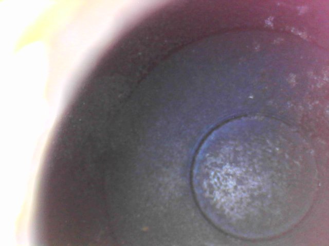

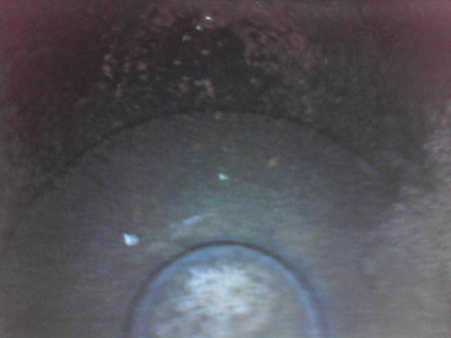

    cylinder 4
    Torspd and TacoSR523 like this.

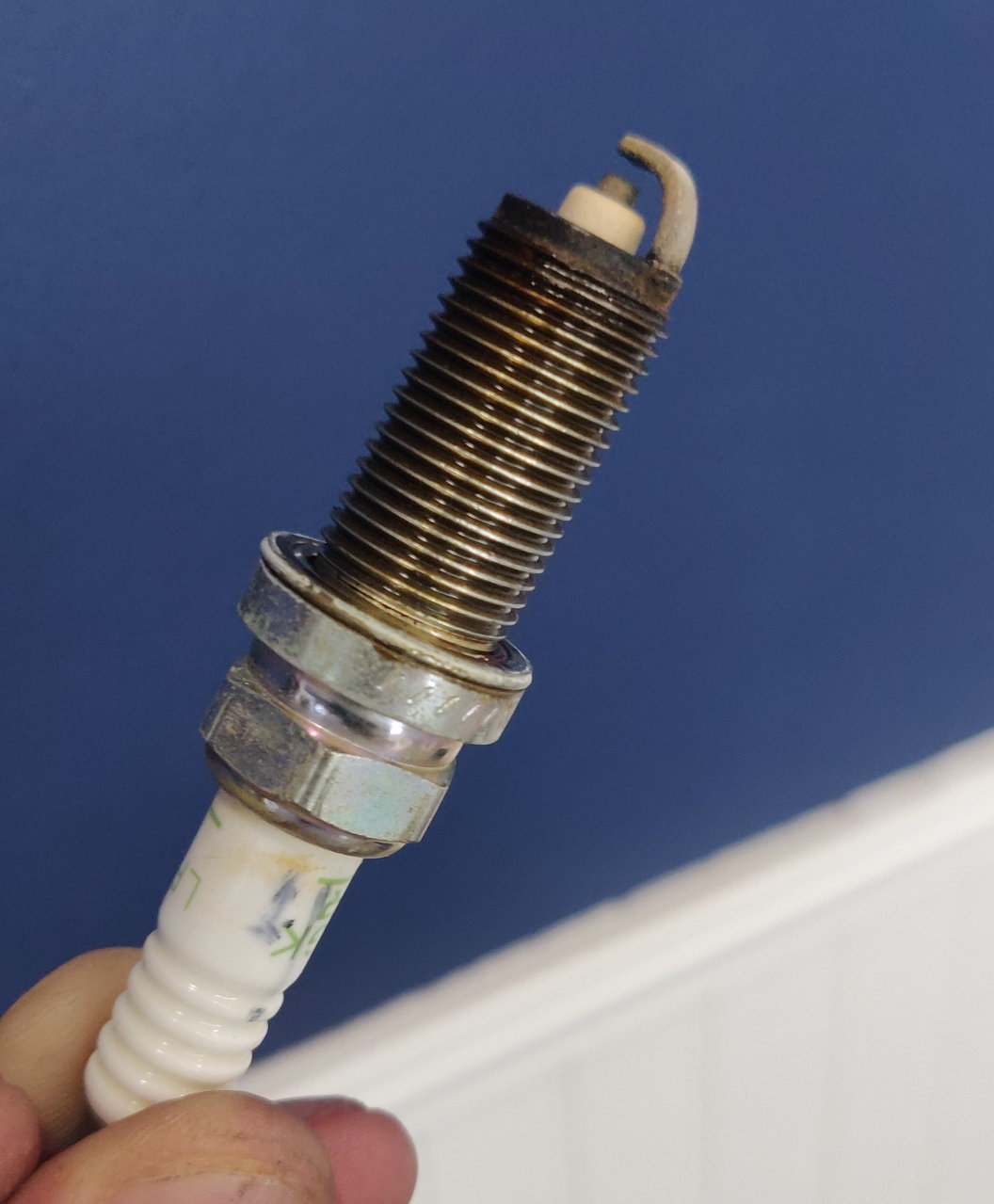

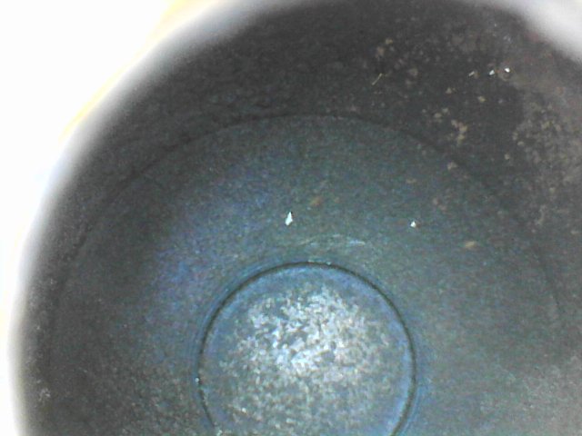

    Cylinder-2

    Also is it just me or does it looked like cylinder 2 and 4 have a different piston?
