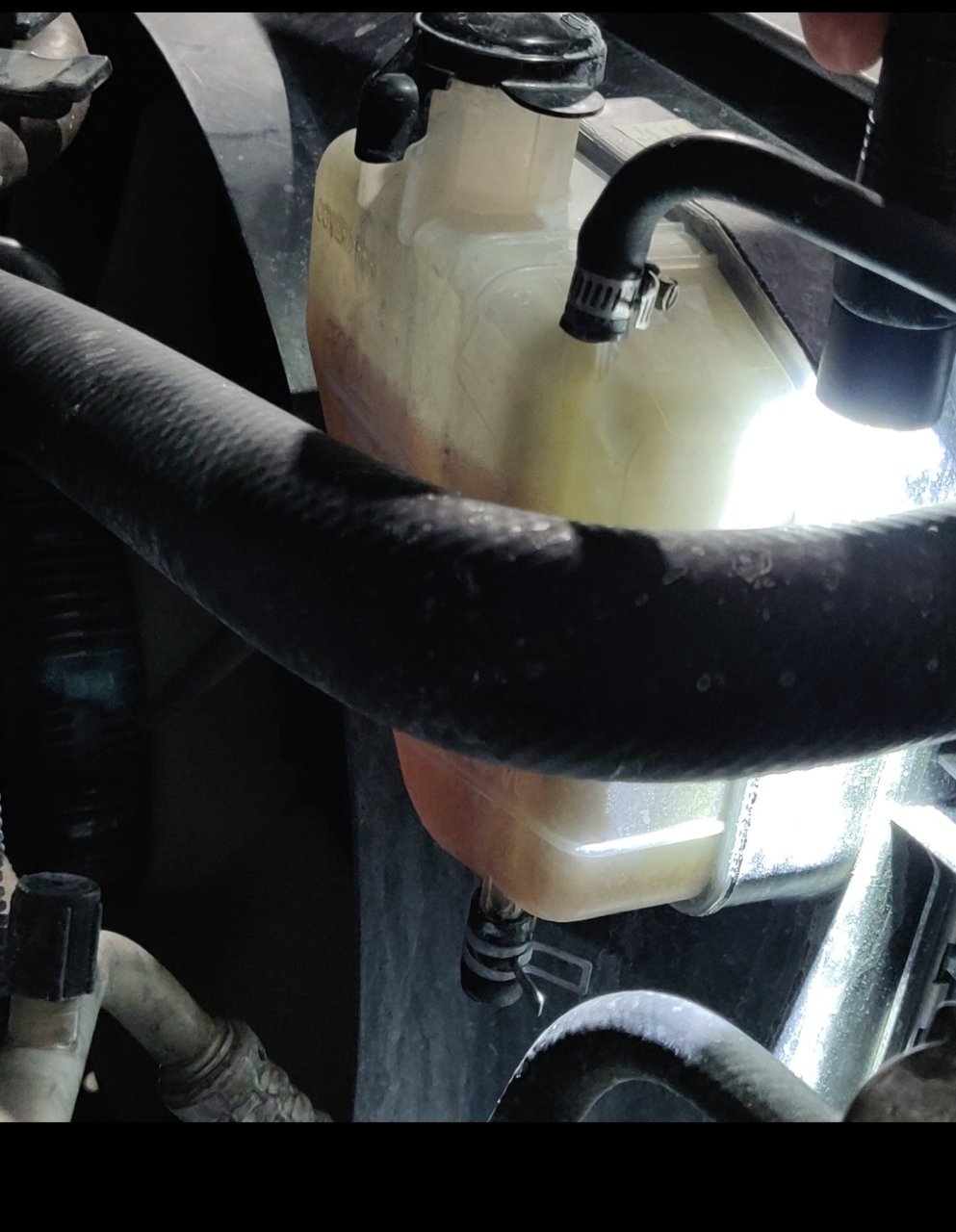

    I just noticed something. After I got the seepage issue fixed and the radiator full again, the whole night I have had the funnel on the radiator fill, sealed with plastic. It's idled for hours, run at 2000, 2500, 3000, 3500 RPMs for periods of time and the level in the over flow never changed the whole time.

    doesn't the funnel adaptor block the overflow port? otherwise it would run out of the funnel into the overflow

    The overflow tank will ebb & flow as the sealed radiator cap sees pressure and vacuum. With the spill free funnel, the radiator is open to atmosphere so it won’t see pressure or vacuum, so the overflow tank level won’t change.
    I still think you have a clog. Somewhere either in the overflow tank, the hose with the worm gear hose clamp, the overflow tank cap, the tube inside the overflow tank, or the hose barb on the radiator neck below the radiator cap. Or your radiator cap isn’t working properly.
