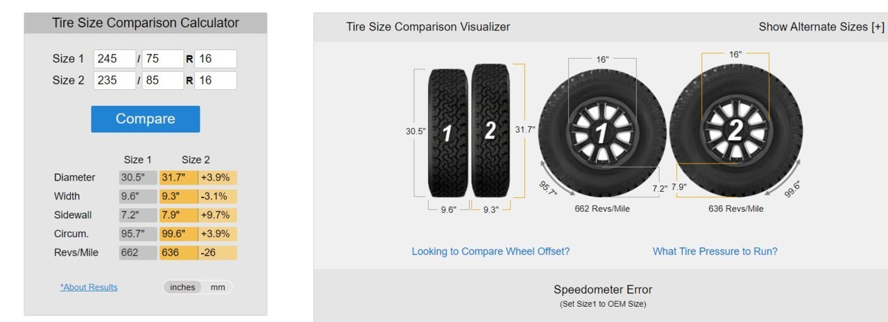

    Interesting. Would 235/70/16s be better or worse than 245/75/16s?
    I've been looking really hard at going with 235s for my next set and am honestly curious for opinions.

    235 70 16 is Smaller and skinnier, its not a valid tacoma size. You'd want 235/80R16 if that even exists.
    I wouldn't go lower than 245 simply due to safety concerns with a tacoma and load ratings.
    My 245's are great but suck at cornering.

    I'm not sure what "not a valid tacoma size" means. Is there some sort of "fixed list" of tires for Tacomas?
    There are plenty of people that run Tacomas on 235s. There are entire threads of people running 235s.
    My current Tacoma was supplied from the manufacturer with "C" load rated tires.
    An "E" load rated tire will more than comfortably deal with the smaller contact patch difference in a 245 vs a 235.
    If a smaller contact patch is better in snow and ice, why isn't it better, even if it's less than a 245?

    235 70 r16 is a rav4 tire size, its tiny. It's not valid.
    235/85R16 is not a winter, nor is it relevant to this conversation.

    You have said, multiple times, that things aren't "valid". How are you defining "valid"? The Rav4 sitting in my driveway runs R18s, so you claiming that 235/70/16s are Rav4 sized is "invalid" because it won't fit on the rim.
    I've seen tons of Tacomas running smaller than stock tires.
    I've seen tons of Tacomas running larger than stock tires.
    I'd recommend you inform Firestone that this tire isn't a winter tire. https://www.tirerack.com/tires/tire...85R6WFLT&vehicleSearch=false&fromCompare1=yes It seems weird that the Firestone Winterforce in 235/85/16 isn't a winter tire. It also seems weird that it's studdable. Summer studs I guess.
    I really didn't want to argue with you.
    I was really interested in understanding why a 245/75/16 was the "best" winter tire. I honestly feel like there are trade-offs, and understanding the trade-offs, for your particular situation is much better than a blanket statement of "this size is best".
    If your argument was that a smaller contact patch is better, we should all be running motorcycle tires, as they have a much more rounded profile, and a smaller contact patch.
    If there were some sort of special unicorn at 245/75/16 that would have been great information. Seems like that may not be the case, which is fine.

    245/75/16 is an excellent snow tire size because it is a stock size and is readily available in an array of brands for reasonable prices.
    235 series that work on 3rd gen Tacomas are typically E load meant for dually pickups, and not really a common size

    235/70R16 is a 29" tire. Let that sink in.
    245/75R16 is the most narrow Tacoma size sold factory.
    235/85R16 is a giant ass tire that makes no sense for winter use. Great job finding one variant.
    Which of these is the most logical?

    I run 235/85R16 winter tires during winter. Nokian Hakkapeliitta LT3's. You can get them with or without studs.
    I run 235/85R16 all terrains the rest of the year, General Grabber AT2's. You can also get them with or without studs, but I feel that the winter specific tire does a better job in winter weather.
    For TPMS, I just use the Autel programmer to swap my saved tire codes. Discount Tire will do it for free as well.

    Suggesting 33" LT tires for winters is not normal.

    No, not normal would be your insistence that you have to be right and everyone else must be wrong. This isn't a situation where there's only one valid solution, just like there isn't one type of winter weather nationwide.
    32" winter tires happen to be the same size as my 32" summer tires. My personal experience is that the larger diameter does a better job at dealing with the road when you need to get out of the tracks that tend to form when there's snow on the ground, like the ridges that form in the center of the lane and between lanes. The extra little bit of ground clearance with the taller tire is a bit of a wash... it isn't that much of an improvement.
    Also, I'll just throw this in here. 235 is narrower (which should be better per your earlier argument) and it's a whopping 1.2" taller... absolutely massive.
    (edited to correct tire size @Bishop84 )
