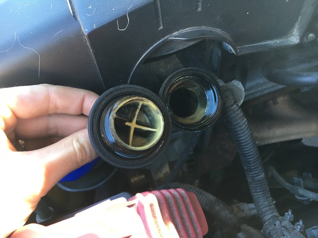

    During my oil change today, I noticed this:
    395F7BCE-34D7-4056-9A75-4166F3BC9F91_zps_77e13de04985334568ae9cd25af74539f3cb53e3.jpg
    After reading a few different threads on TW, I felt confident that this was acceptable. I do a lot of short trips, not letting the engine heat up, cool mornings, etc. It wasn't until I read about coolant contamination being a possible cause that I became concerned.

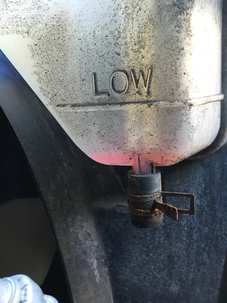

    My coolant reservoir looks like this:
    B15C17AA-E836-4045-A2EF-2B855631B8B3_zps_3be995aaa106fe2f3d5823dd5b0c2fd455d890fe.jpg
    A few months ago during my last oil change, I noticed the coolant level was a hair below the "Low" mark. Three months later, it is far below.
    Coolant in the radiator is normal and oil on the dipstick is not milky or distorted in any way. I do not smell coolant in the exhaust (that I can tell at least). Could the film in my cap and the coolant level just be a coincidence?

    Agree with the condensation in the oil comment. So long as it's limited to the cap. If you see the oil a yellowish color, you've got bigger issues like a blown head gasket.

    Your clamp its rusted all to hell lol

    Pull the dipstick and check the oil. Is the oil on the stick milky? Don't use what is in the cap to determine the condition of what is in the pan.
    Also, ADD COOLANT! When you see that your coolant is "a hair below low", it is a good time to fill it and figure out where it is going.

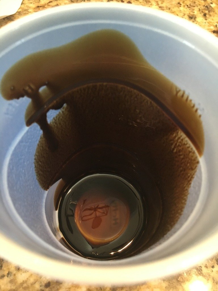

    The stick wasn't milky, but the oil I just drained during the oil change was slightly brown. Not super milky, but a tint.

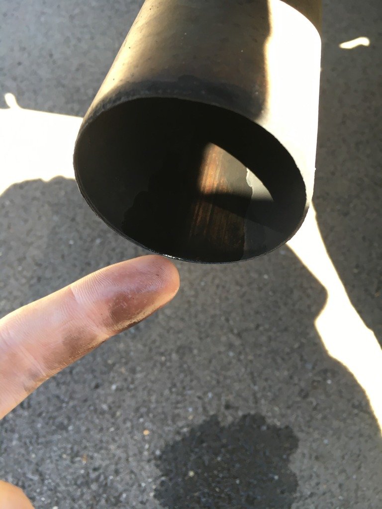

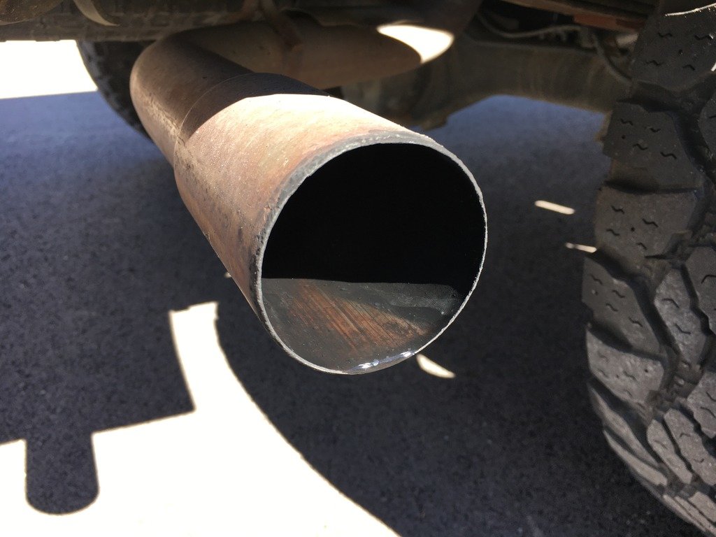

    I let the truck run for about five minutes after I finished the oil change and I noticed the tailpipe was steaming and water was sitting in the pipe. Is this normal?

    Your oil looks normal, and water from the tailpipe is also normal. It's just condensation from the cold exhaust pipe with hot exhaust flowing through it.

    Oil looks normal. Water in the tailpipe is also normal. It is a product of a properly functioning emissions system.
    As for the loss of coolant, start by looking for any leaks. Check your hose clamps and connections. Check the water pump weep hole for any buildup.
    Edit: water in the tailpipe is normal (as is the soot). However, if you have a constant cloud of steam coming out of the exhaust on a day that isn't cold/cool and humid, it is not normal.

    BTW, the oil looks really good. How long has it been since you changed it?
