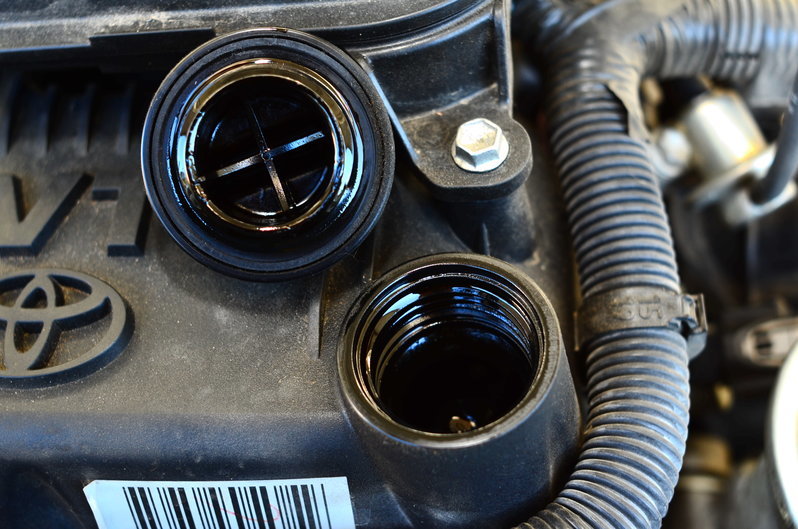

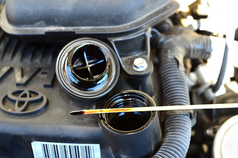

    Yes AmsOil is rated for 1 year or 25,000 miles. As I drive less than 10,000 miles per year I change it once a year. No ugly sludge in my oil filler. I've added pictures.
    Oil filler after oil has been run 1 year and about 8000 miles.
    Oil filler and dipstick, no oil added in 1 year of service.
