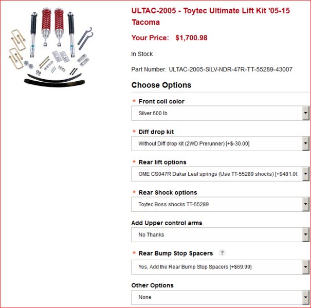

    Ive been reading for months about lifts, but every time I begin the process to build a cart with products I find myself doubting or wondering if I am missing the mark on my goal. Reading through the FAQs etc, I am still unable to determine what I need to get.
    I have a 2013 Prerunner TRD double cab. I'd like to keep the ride quality the same. I also think I should take this opportunity to resolve the rear leaf pack sag with a complete replacement pack (not an add-a-leaf). All I am looking for is a good quality 3" Front and Rear lift. Should this be obtainable within $1,000 to $1,500? I have been browsing Toyotec's site and so far I'm at about $1,700.
    I want to do this right. In past trucks, I have gone cheap and every time I was not happy with the outcome. But I also don't want to spend more than needed. I'm simply after 3 inches of lift to fit 32" tires, not lose ride quality, and attempt to resolve the sagging rear end.

    Easy man...... bilsteins up front with Ome coils, bilsteins 5100s in the rear, Dakar rear leafs. Then new ucas, in your price it's going to be light racing ucas.
    That there pal, will be under $1500.
