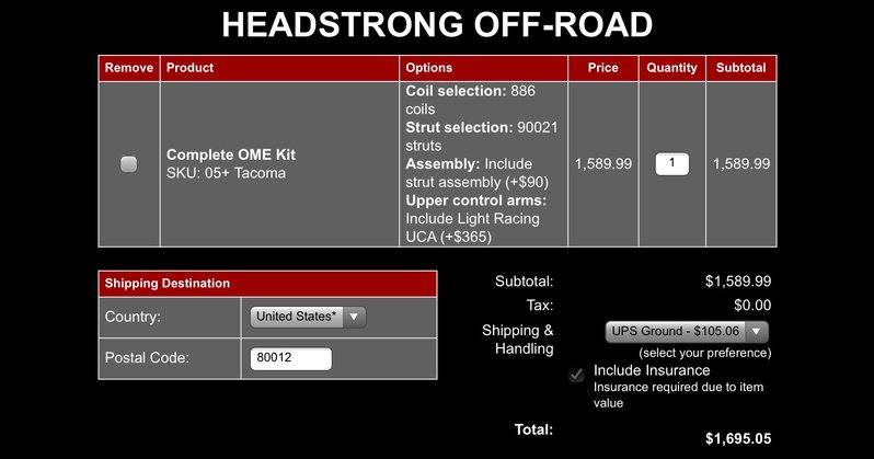

    This looks good, but I would see if I can get it without the dakarsimage.jpg

    I went with the headstrong package, Bilstein w/ eibach coils because I wanted about 2.25" of lift. For what you are looking for I would say that if you are trying to stay on a budget grab the Bilstein W/886 coils to hold the front bumper weight. I believe it would be under $800 to your door.
