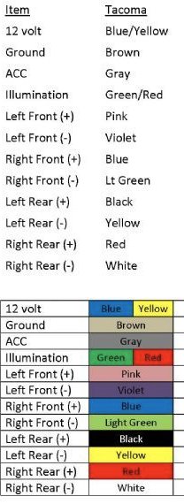

    Bought truck had no audio everything was cut. I guess someone stole the audio. Anyway I install new headunit put a couple amps and subs and new door speakers. So I just had this white and green stripe wire and this green with red stripe wired to accessory power wire. They will turn and stay on (running lights and dash lights). With out that accessory power wire nothing happens no dash or running lights. Even if truck is fully running.

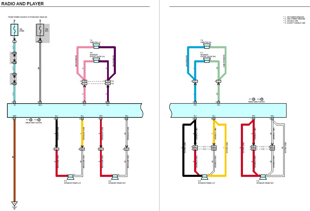

    Here is the wiring diagram from the FSM (a few members have a link to the FSM in their signatures, it might be worth your effort to find and download a copy)
    While that's a little hard to decipher, a quick google search turns up a table:
    Pay attention to the ACC and Illumination wires. It sounds like you've got them mixed up. ACC (Gray) should be telling your head unit when to turn on, so if you have the Green/Red wired to that input on your head unit, it would make sense that the HU only works when your lights/dash are on.
    I don't see anything for White/Green, and it's been a long time since I replaced my head unit, so maybe someone who recently has done some work in there might be able to help you more.
