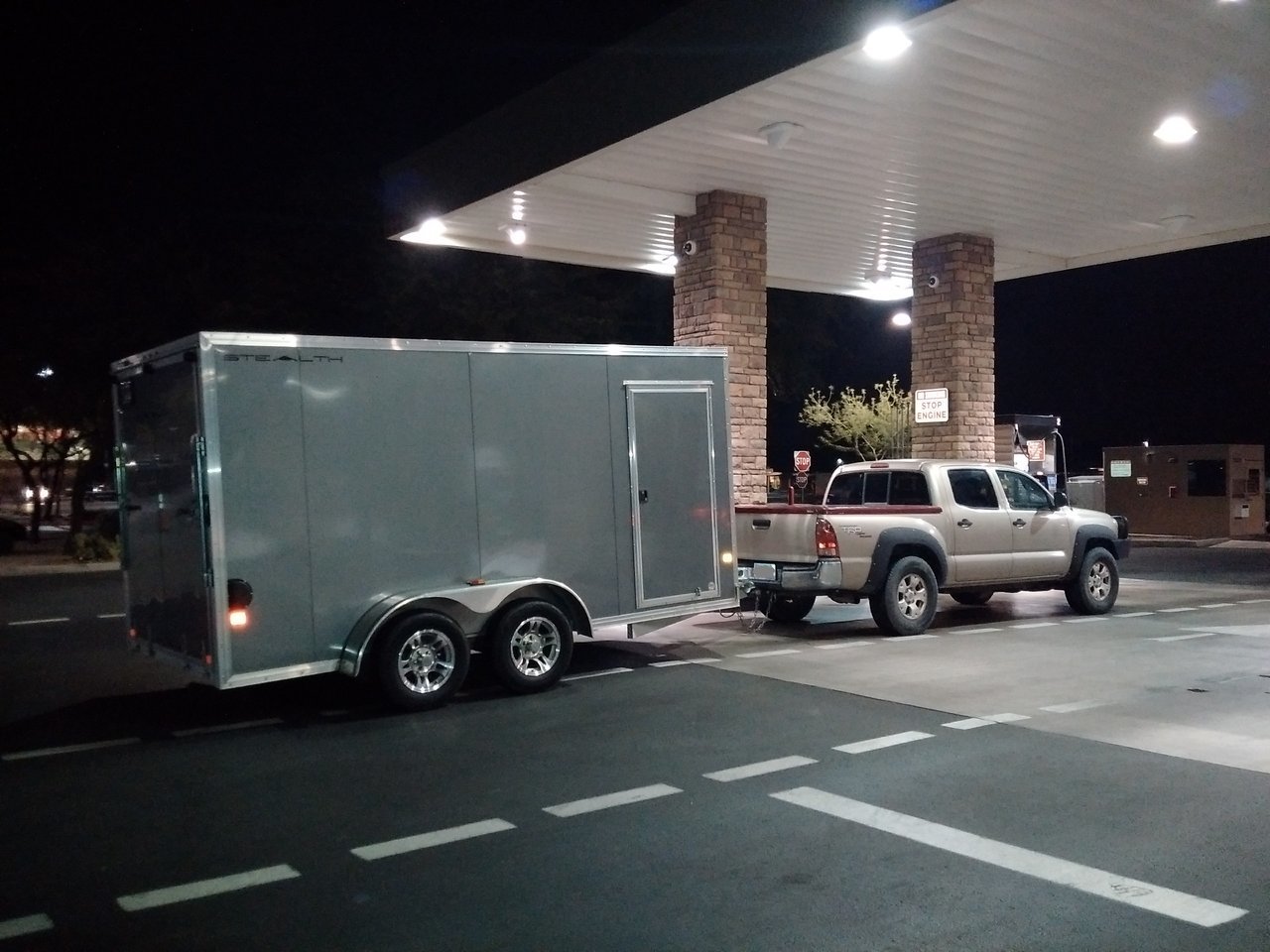

    I'm big on getting out for a couple months a year and traveling around. This will be my first attempt at a DIY camper build (solar, shower, stove, fridge, AC and so on) from an enclosed trailer (I've traveled in a motorhome and done a DIY step van build I traveled in) and this one fit pretty much everything I wanted as follows:
    100 sqft (roughly)
    Dual axle
    V-nose
    All aluminum
    Screwless sides
    Flat roof (for ease of mounting solar and such)
    Tube walls (instead of z or channel or top hat style)
    Super low (for a 7x14) 1,550 curb weight
    Things I wished it had or need to do:
    Diamond plate aluminum floor
    Spring over axle
    Roof rack
    I wish the belly were covered
    I wish the wheels were flush with the trailer
    Wow though, the MPG...ouch!!! I normally get 19mpg, on the way up to get the trailer I got 17mpg because I was doing 85mph the entire way. I tried doing 75mph towing on the way home (in 4 not D) and that dropped me to 7.8mpg, I eased the speed some and got 10.5mpg doing 60mph the rest of the way.
    I will however say that I'm kinda freaking out after towing it home, I know it's like pulling a parachute but I'm used to towing with a F-250 so the Tacoma felt small to me. I'm going to add roughly 3,000 to it so I will tome in at 4,500 and I have the tow package, I'll add a leaf to the rear, a weight distributing hitch, brake controller and so on. All the same, the Tacoma seemed soooo little with this thing behind it.

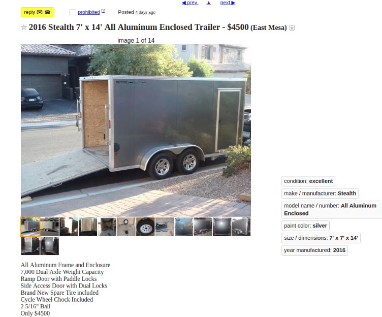

    Also, I ended up getting it for $4,000, I haven't bought many enclosed trailers and couldn't find many like it locally so I don't have a frame of reference and don't know how to feel about the price.
    Thoughts, input, ideals, opinions, criticisms?

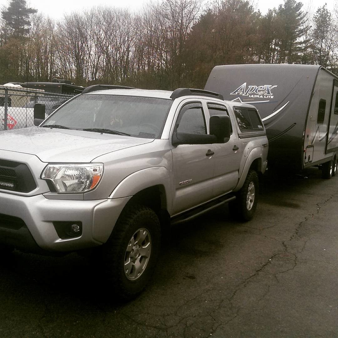

    Towing is fine just not mpg. You just need the proper setup. Weight distribution sway system and bags or in my case Dakar leafs

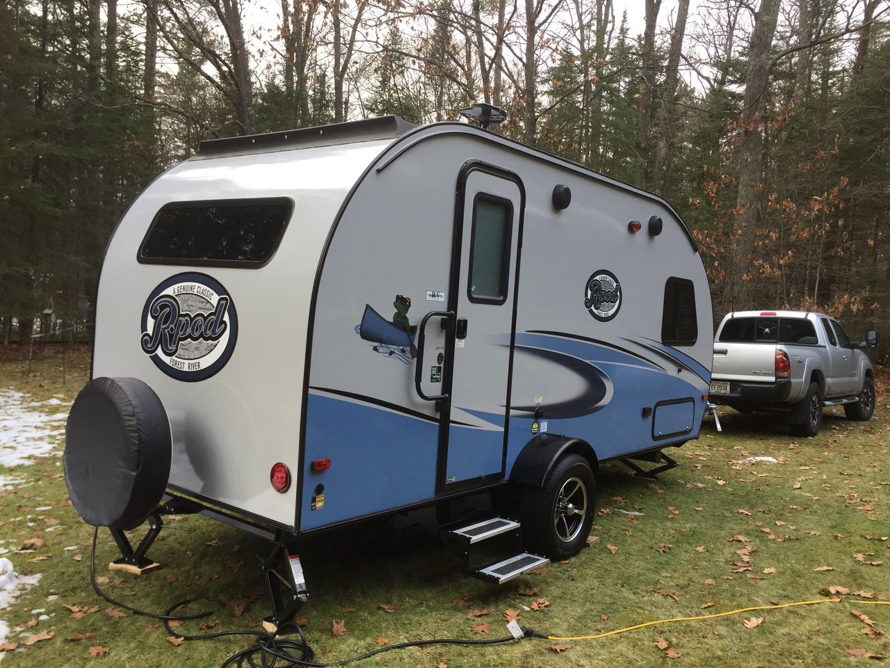

    A motor home pulling a trailer smaller than what your planning on pulling with your Tacoma is not a fair approximation. I just pulled this 520 miles Thanksgiving weekend. 3000# w/electric brakes and a WDH.
    My truck is a 4X4 AC with factory towing package. This is the largest I would go!
    Oh, and you WILL need electric brakes.

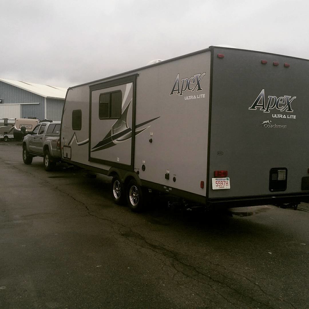

    Trailer is 4600 empty. Packed probably around 5K. Definitely around 10nog. Only mod left to do is upgrade the trans cooler. I put a fan on the factory one for traffic.
