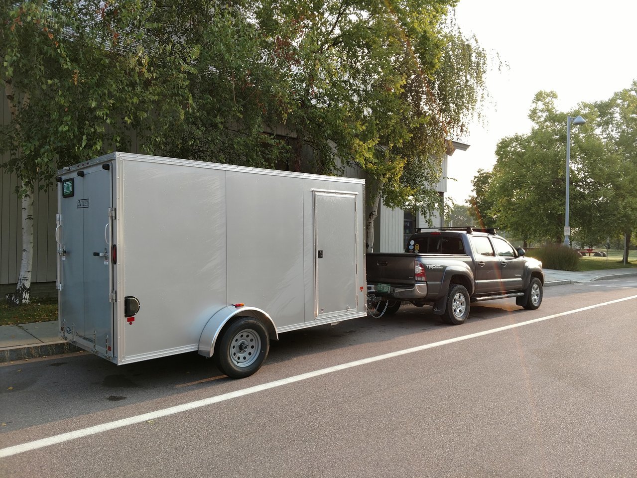

    OP, your trailer hitch stinger is upside down. You're going to be a lot closer to level if you flip the ball around and turn over the stinger.

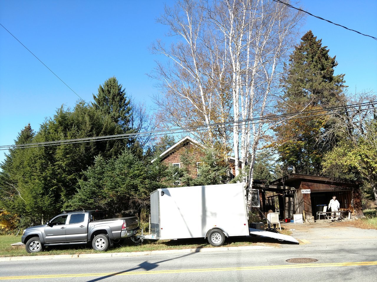

    I have a 6x12 version all aluminum single axle 990lbs. I use it for my business and it tows great around VT and the Adirondacks. I did beef up my rear springs and got my drop squared away! Love the trailer fwiw.
    I had a 2 place Proline snowmobile deck over 7.5x12 aluminum trailer that I towed with my Tundra. I hated it behind my Tacoma. It was a huge sail & drag. Sold it now have an inline.

    I have an identical trailer. Like has been mentioned before, the Tacoma will pull it just fine (but is best suited around town or for short trips). I have had mine empty and fully loaded a few times and have never felt out of control even in some windy conditions. I wouldn't enjoy towing it long distances though on the highway though.
    A supercharger, heavy duty leaf springs, and a big brake kit up front help significantly.

    Drop the tongue. It's not safe to tow with the tongue high like that.
    Pick up a WD hitch and some better leaf springs or airbags to help out when loaded.
