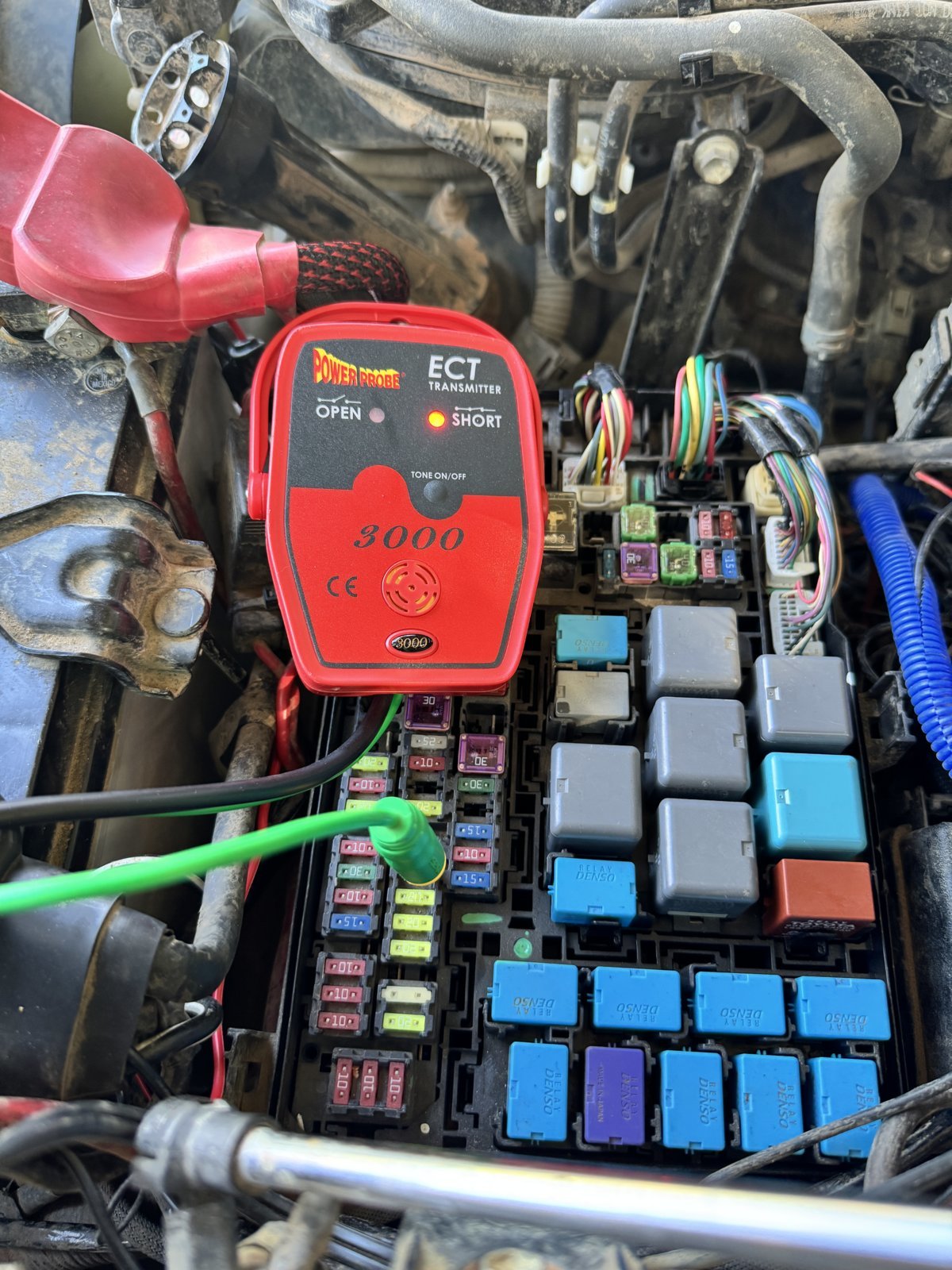

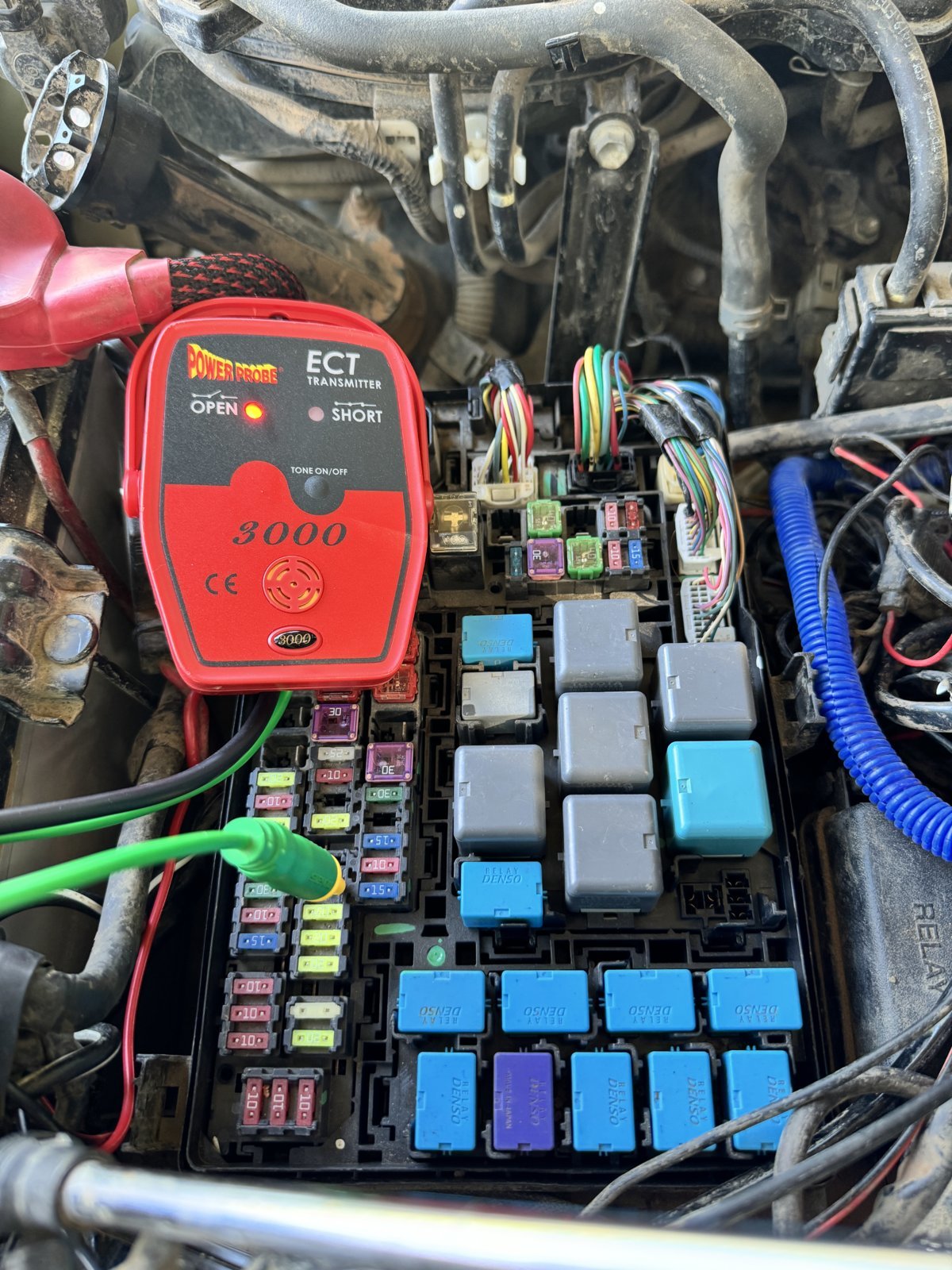

    I've been trying to locate a short somewhere in the stop light circuit for an hour or two most days after work. I keep blowing the 10amp stop fuse under the hood when I press the brake pedal. Most of the Tacoma is taken apart and I've disconnected almost every plug/connector in the truck to include behind the dash. All while using a light bulb in the fuse location with the brake switch hanging to simulate a pressed pedal. The light only goes off when I press the switch/ open circuit. I feel like I'm missing something. I have gone through the wiring diagrams, it's been to a shop that I trust, they cold not find the short.
    Nothing new installed, all my aftermarket stuff is run to an auxbox. There is nothing on this circuit and I disconnected all my aftermarket crap for the diag just in case, it's all sitting in the garage.
    What I have done-- new tail lights and factory bulbs, my housing were broken, removed the 3rd brake light, pulled all my aftermarket crap and have the interior about 50% off to include the dash and the headliner. The trailer plug is disconnected to rule it out.

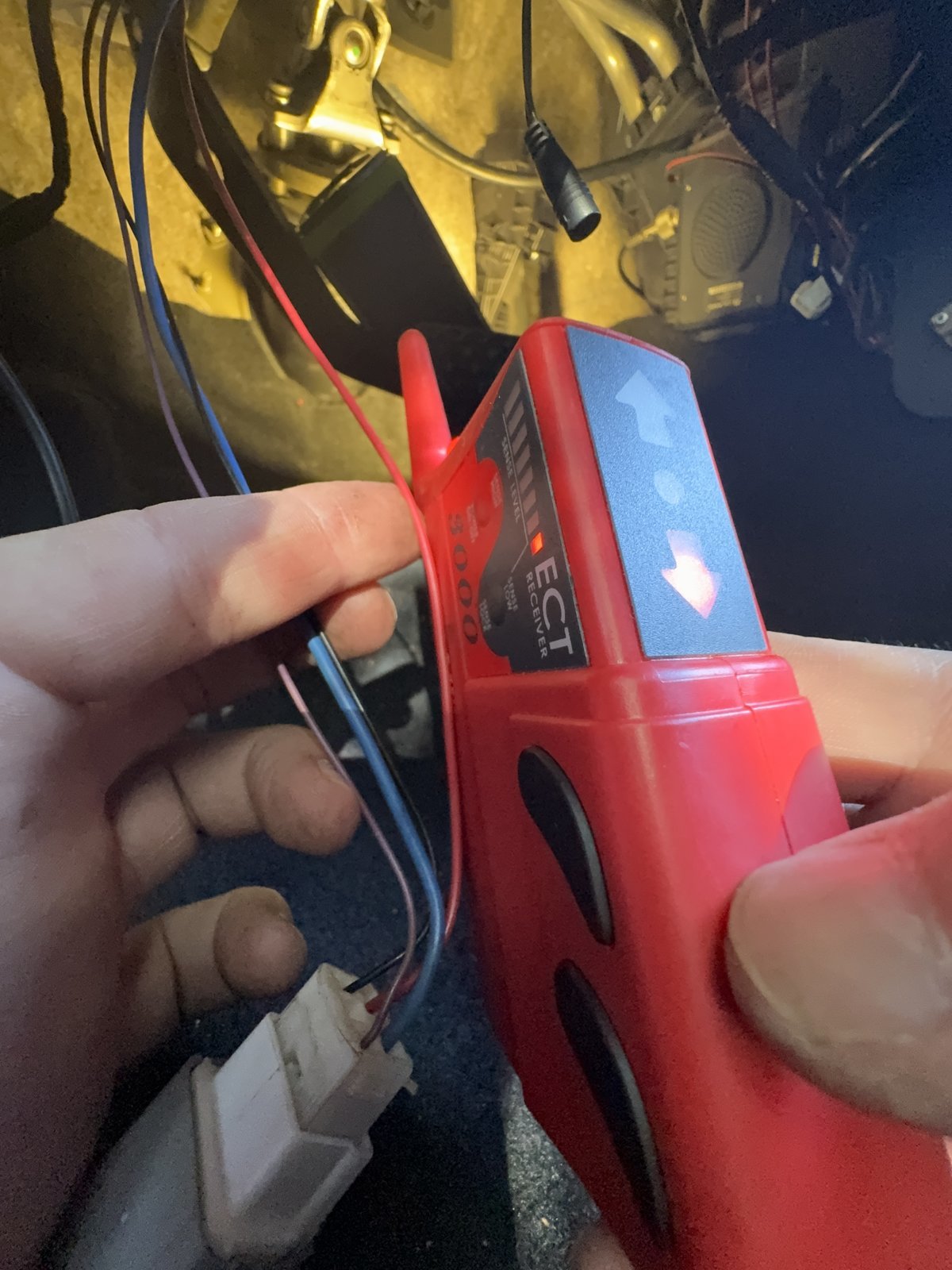

    What I find interesting is with the PowerProbe ECT the signal is changing direction depending on the wire it reads from the switch.
    Blue wire signal points up the wire
    Red Wire in the same location it points down
    At fuse box, in the fuse if I leave the relay in it reports a short
    Relay removed is an open circuit
    I have to be missing something. With the relay removed I get no hits anywhere on the truck using the probe.

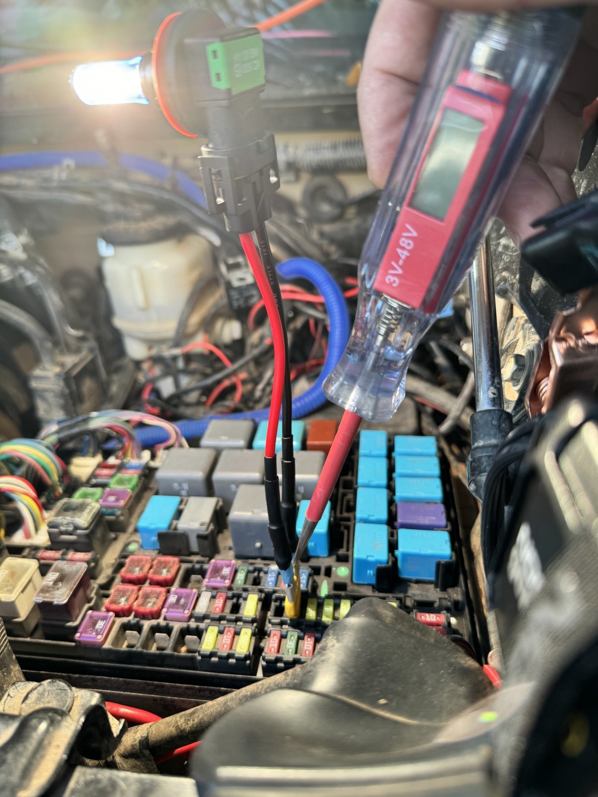

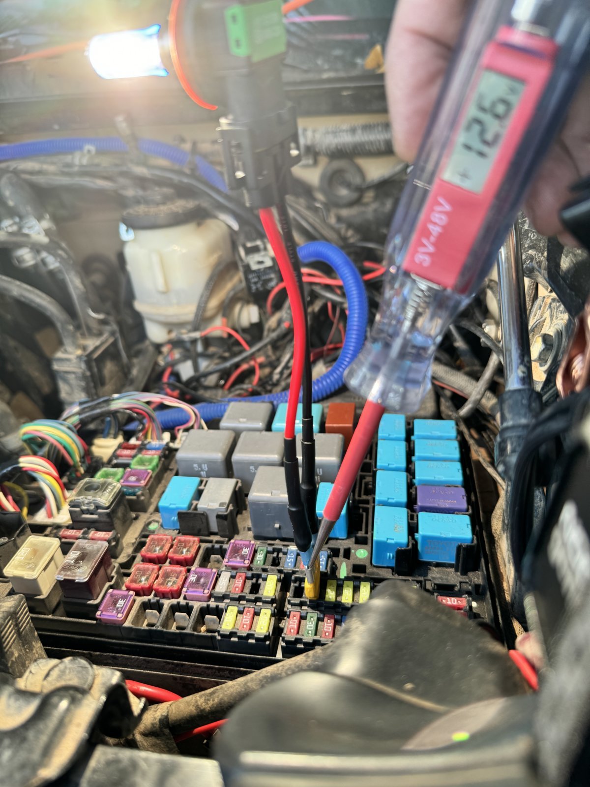

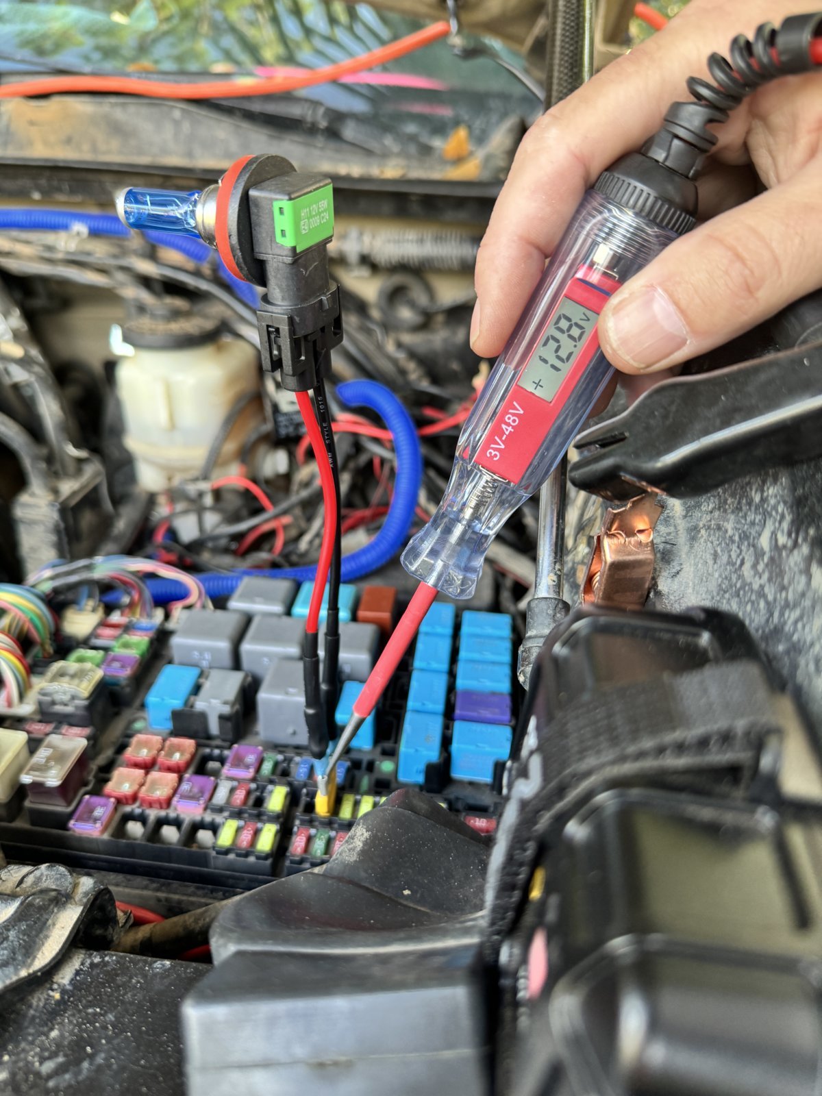

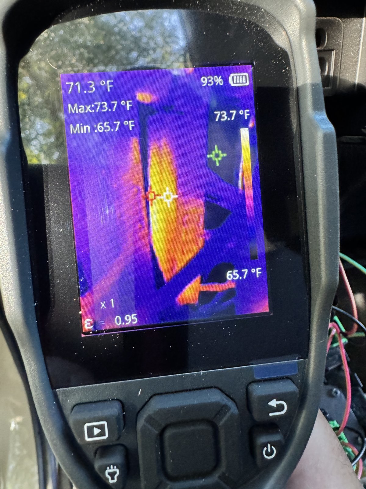

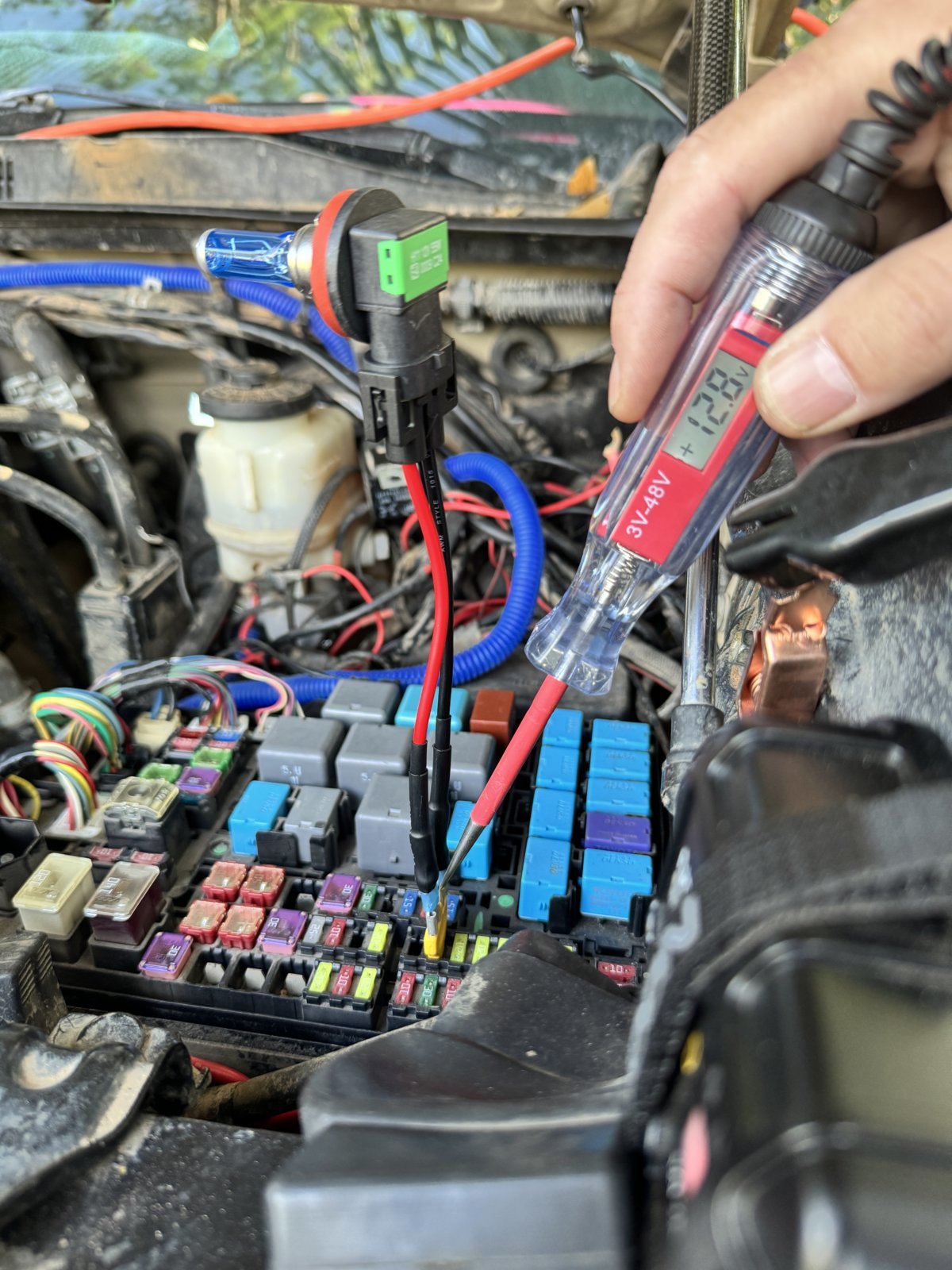

    @Dm93
    @caribe makaira
    Tried the H11 and a thermal cam.
    First 2 pics light off, not stepping on the brake reading 12.8 on both sides of the fuse.

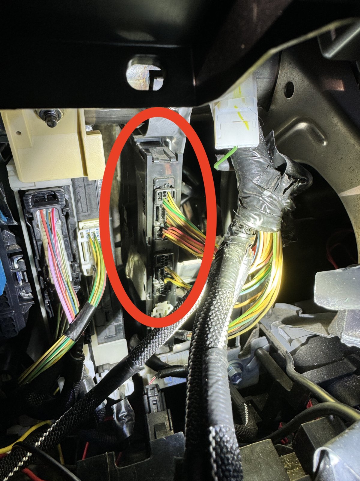

    Next 2 pics light is on, stepping on the brake pedal. It reads 12.6 on the front most side of the fuse, closest to the grill. Then it reads nothing on the side of the fuse closest to the firewall.
    also noticed this with the thermal cam. I believe this is the certification ECU or the main body ECU?
    here is what it looks like
    I'll be getting back into it tomorrow. Any ideas from you guys would be amazing.

  11. Feb 1, 2024 at 3:06 PM
    TnShooter
    TnShooter The TacomaWorld Stray
    Sep 2, 2010
    #42625
    20,869
    Deogee
    07' TRD Off-Road, Auto
    STOCK

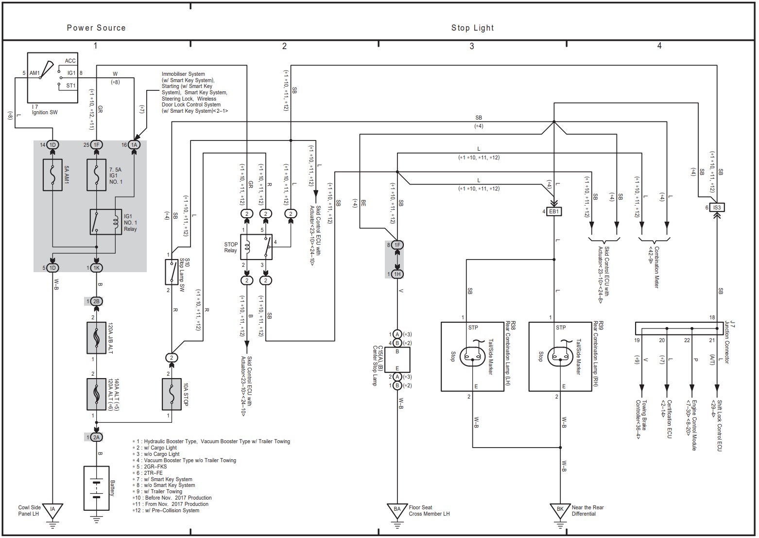

    I looked at the diagrams.
    Power goes to the following AFTER it leaves the brake pedal switch.
    1. Skid Control ECU w/Actuator
    2. Combination Meter (Cluster)
    3. To J7 Connector to the following
    ... 1. Shift Lock
    ... 2. Certification ECU
    ... 3. Towing Brake
    3. EB1 connector to The rear stop lights
    4. 1F/1H connector to the Center Cab light
    Have you disconnected any of those to see if the short persist?
    Test those locations?

    Here we can all be on the same page.

    Thank you very much, I find these diagrams have way more information than the nice colored ones.

    Remove relay again, press brake pedal. Does it blow the fuse?
  20. Feb 3, 2024 at 7:51 AM
    #20
    ClassyTacos
    ClassyTacos [OP] National Treasure 3, Times a ticking Nickolas
    Sep 26, 2019
    #306325
    1,911
    Papalote
    Florida
    2017 TRD Sport 4x4
    Stockish
    Just confirmed, with the relay pulled the fuse does not blow.
    Here is a little data collection on the fuse block at the relay. Is there anything here that stands out to you.
