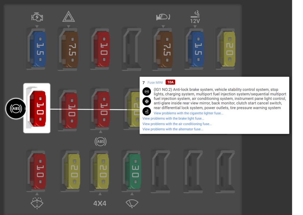

    My problem: I drove a block or two last night without the IG1 No.2, 10A (#7 inside) fuse, now I'm experiencing a rough idle, a significant reduction in power and acceleration causes hesitation, like it's not getting enough fule.

    We put the fuse back in but it's still having the problem.

    Oh k sorry guys I couldn't get the reader to connect so it took longer than 30 minutes anyway the code is P0303 for a cylinder 3 misfire. can I clear the code and have it stop misfiring
    yes I put the fuse back in that number seven spot 10 amp good fuse
