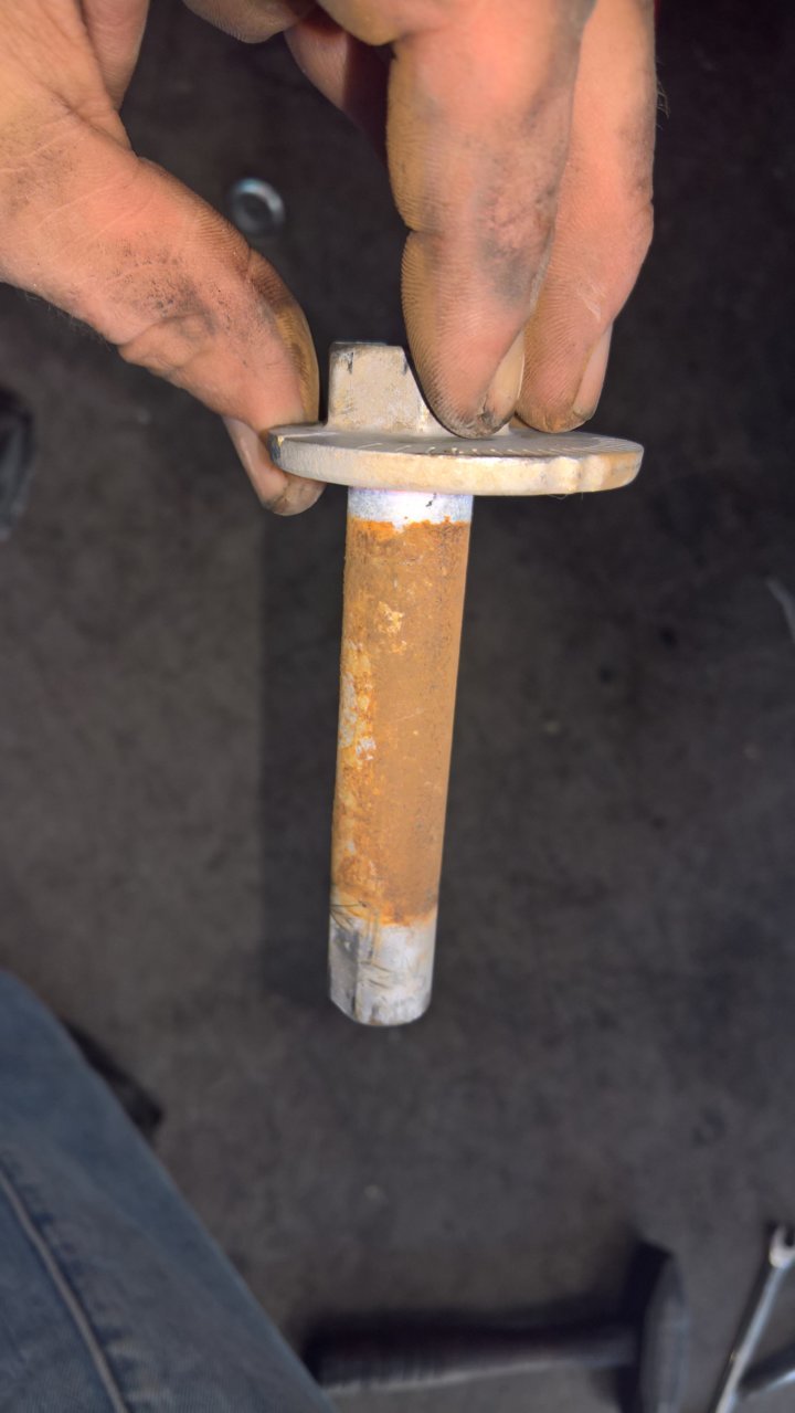

    Here's the problem. The alignment hardware has an electro coating on it that Toyota thought would be sufficient to keep them from rusting. Not the case, the coating isn't thick enough and there's no lubrication so the metal on metal rust welds itself together.

    Exactly.
    I wish there was a "sticky" informing new Tacoma purchasers to have those bolts antisiezed before the truck leaves the dealership.

    It's a no win situation for toyota. If they grease them at the factory then they could back off and loosen up. If they dont grease them they freeze.
    The army of lawyers that work for toyota corporate have decided that not greasing them is best from a liability standpoint

    Not sure if that much thought went into it. The area where they freeze to the bushing sleeve has no threads so greasing that or better yet using zerks on the bolts would definitely help and not cause them to loosen up

    How hard would it be just to spray them with penetrating fluid once a yr. Would that help?

    Maybe a little, it is pretty big bushing, I don't see the majority getting much penitrating lube.

    It would wash out too easily. You need something thick that is wash out resistant.
