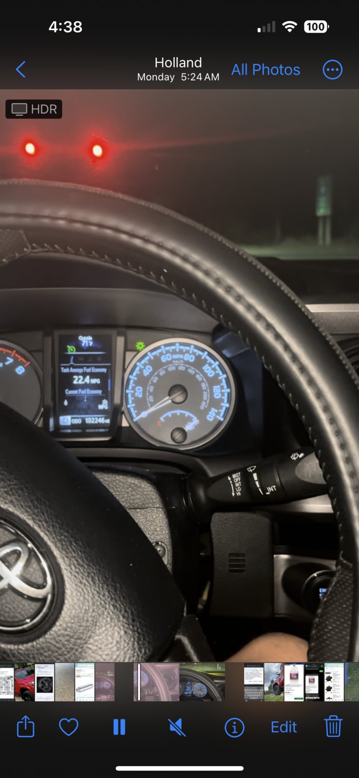

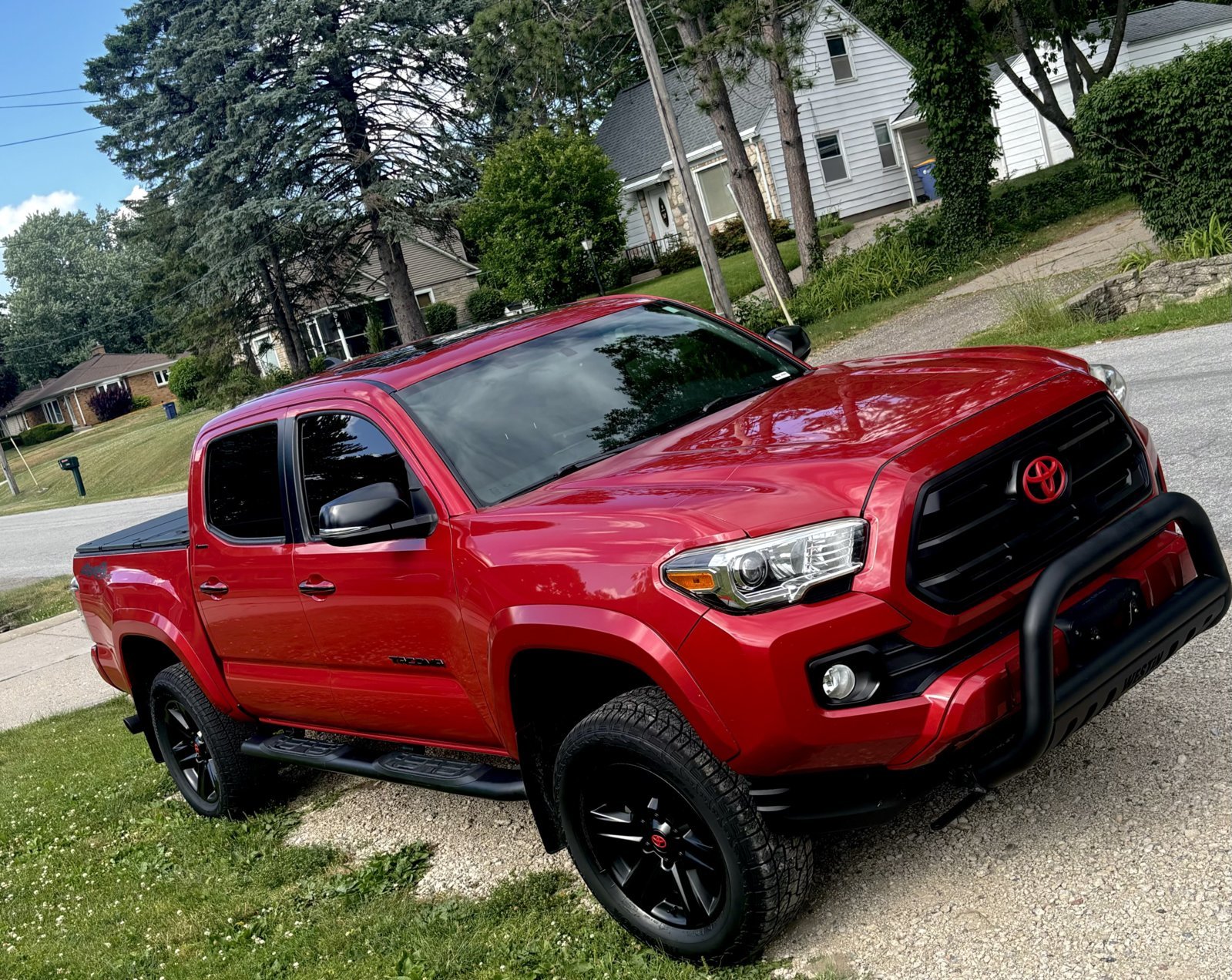

    Bilstein 6112/5100 at 2” (6/8 circlip, 3/8” top spacer, sway bar drop bracket, YotaWerx Black Hawk 2.0 tune, Borla Pro XS exhaust, Freedom Off-Road UCA’s, Alphrex Luxx Series smoked taillights, Westin bull bar, 265/65r18 Cooper Rugged Trek tires, 18x9 Anthem Off-Road wheels -12 offset, 4.5 backspace. Rock Sliders that I fabricated.
    I put a 3/2 leveling kit on mine and stayed with stock size A/T tires and nothing has changed from stock. Still get between 18 and 23 mpg and truck rides and handles great. Welcome to TW!
