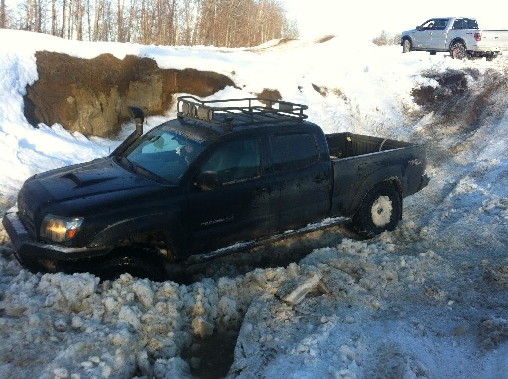

    A big thanks to jkirkpatrick and ignorantly Alberta for getting me out of multiple sticky situations today

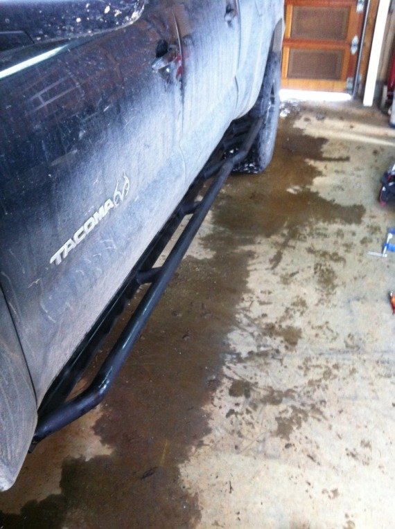

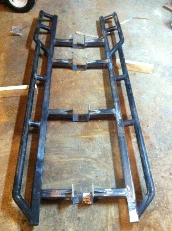

    260ACD7A-261E-423E-B6A4-0C95C059BAA2-426_915606340b834394d6aff05eb9e9a523398ca2d8.jpg
    Ready for paint

    2A2C5D37-31D3-42C8-B716-E41C81209A23-505_5eddc295623c9c76a037faab1065f0e01b4158ef.jpg
    93EF9923-FE7D-4ECE-876C-214229158411-505_7d5f1955a018ac422ac806e0d753dada04b2795b.jpg
    A little paint and they'll be done

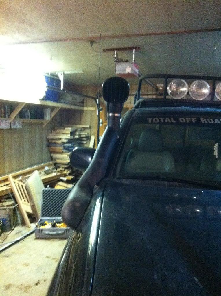

    Well my busy summer is over, soon time to play in the snow again, I ordered my snorkel but it's 4 weeks back ordered

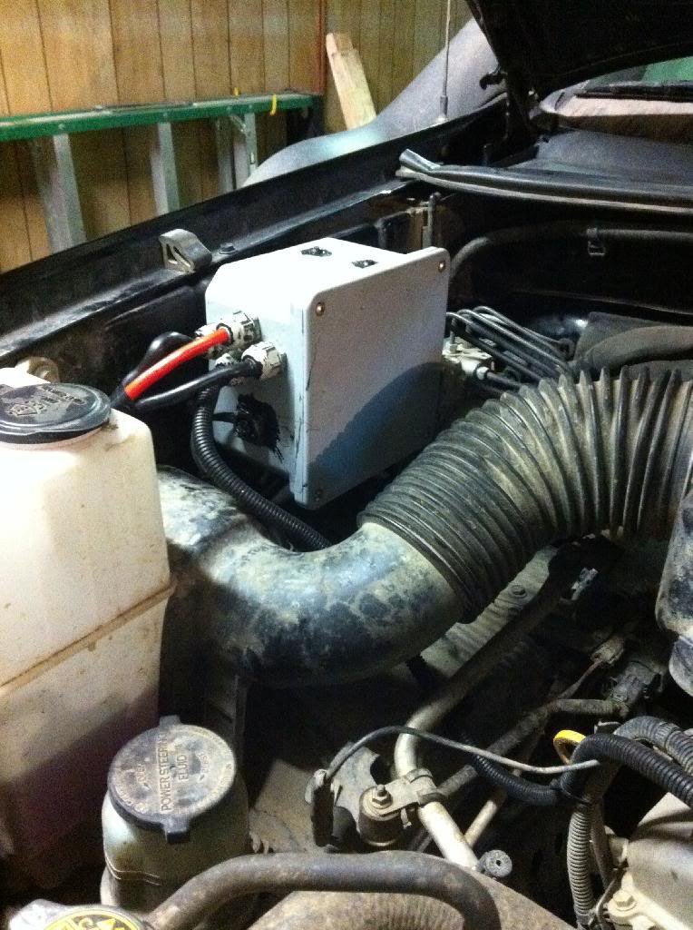

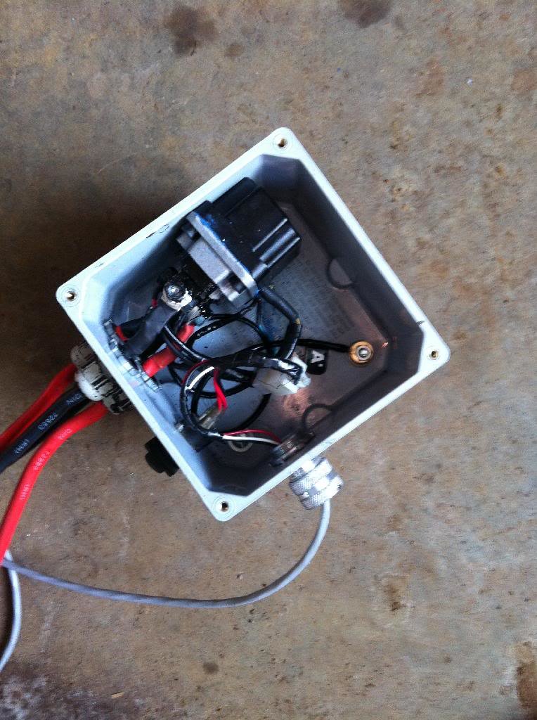

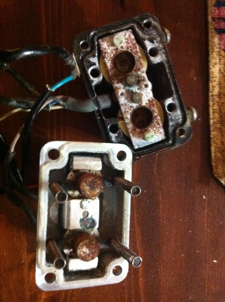

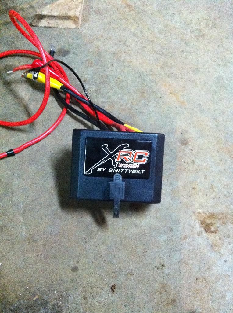

    Finally got a chance to fix my winch, I completely stripped the winch, cleaned and re-greased everything and sealed everything with RTV. Then I stripped the solenoid, gave it a light coating of dielectric grease,sealed it up with RTV and mounted it in a more suitable enclosure. hopefully this will prevent corrosion from getting in again.
    I also added a wire into the cab for a switch in the centre console. My new synthetic rope should be here Monday.

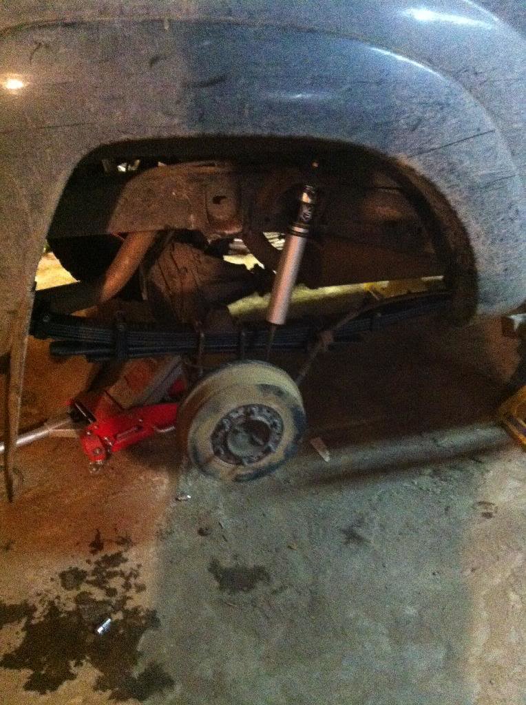

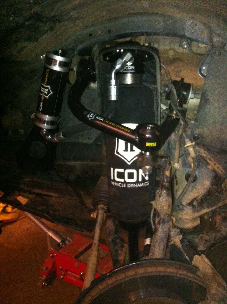

    09 TRD sport

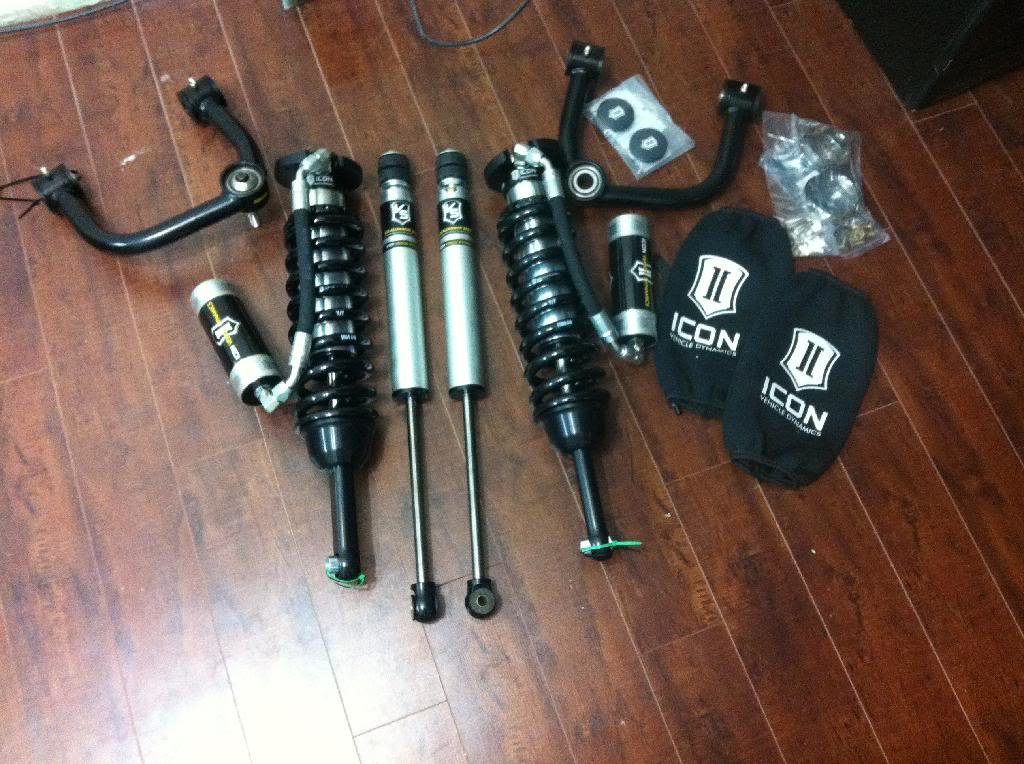

    New goodies, also picked up some Dakar leafs

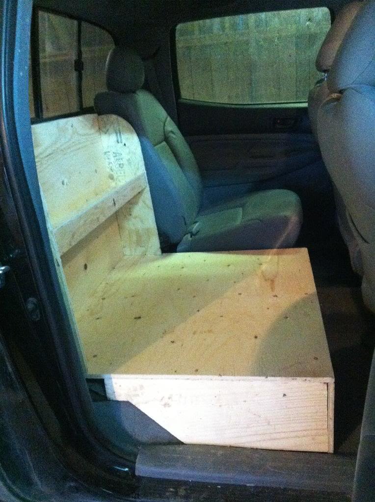

    09 TRD sport
    Built a platform to eventually hold a fridge
