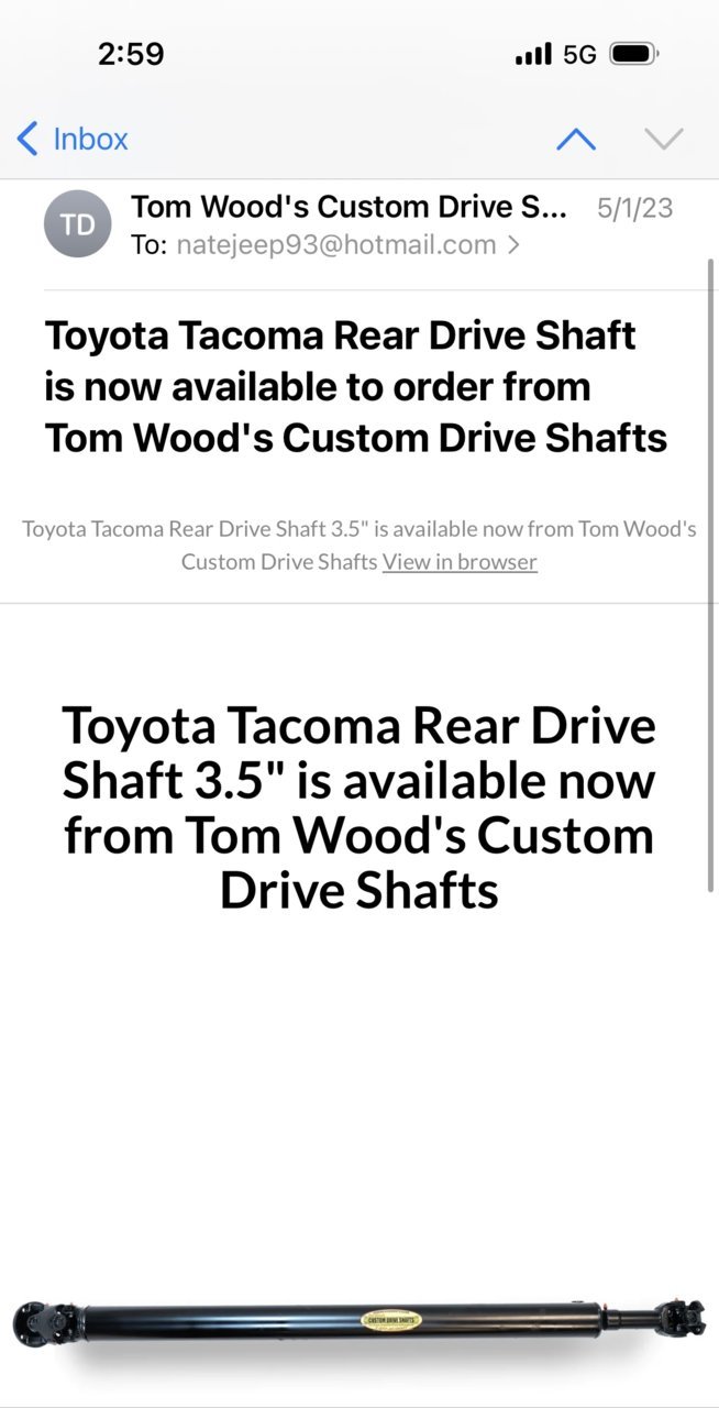

    67339AFD-8816-4B0F-A637-9F3112DE4091.jpg Tom woods just discontinue them?? I was signed up for when they came back in stock and just got notified 5/1..
