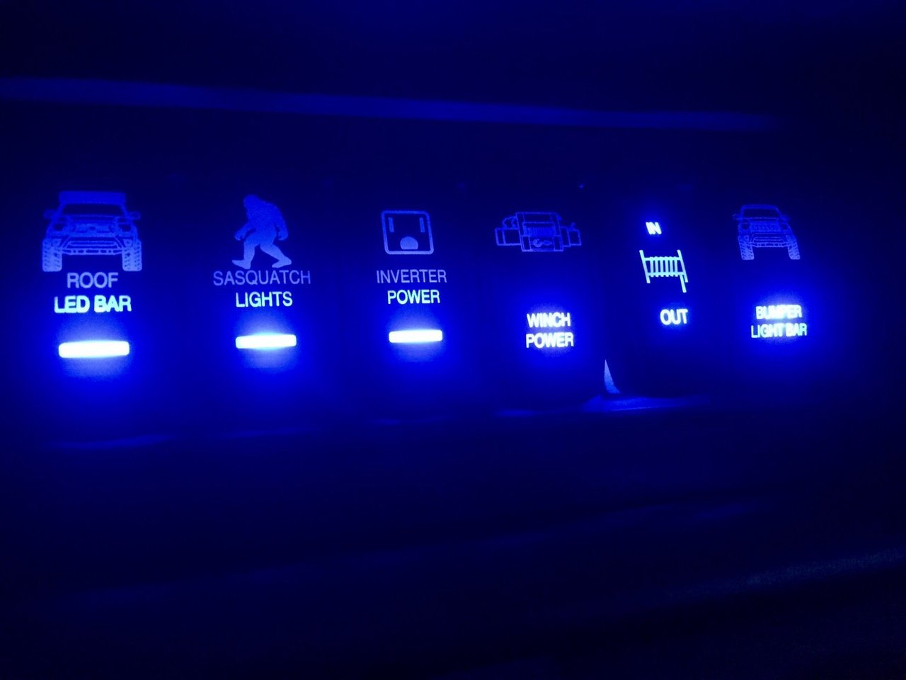

    Heres how Ive got my wiring done.
    Iggy panel for 6. Plus a simple 2 switch holder from Otrattw for the winch controls.
    Then I actually just did this today. The wiring looms arent finished quite yet. (waiting for the weather pack connectors to show up) And its ALOT of extra wire im sure. I did three looms (duh). Two 6 wire looms and one 5 wire loom. I only wanted have to take things apart once so i went for the worst case sort of deal. ie 6 wires as the "power" wires to switch and 6 wires for the "to acc" wires. The 5 wire loom includes my dimmer light power (so switches power on with dash lights), a negative wire, then three wires for whatever else that might need a wire.

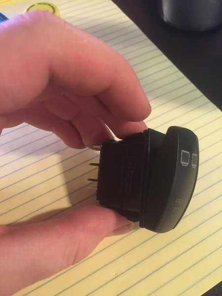

    would they fit a blitzpro switch if I just get the cover?? The blitzpro looks just the same..

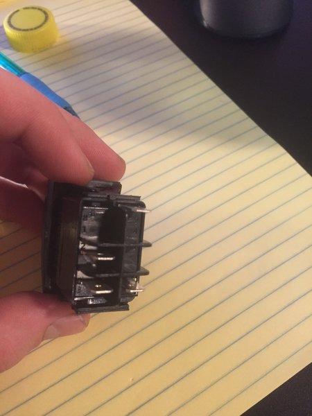

    Can you post a picture of the back? They use contura switches.

    Where the pins are?

    heres the side view

    Haha sorry I meant to say the back of the switch rocker. Or just the front of it.

    It looks like they are the same. If you want to pull it apart you can pry on the side of the switch in the center and they will pop off.

    And yes the ones from Otrawwa will work on yours.
