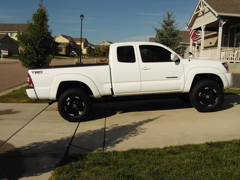

    2.5 Billys, 1.5 AAL....Rides like a dream on some mighty 285 KM2's....My only issue was a slight wobble in the steering wheel at 45-55MPH. Took it in for balance job #3 and bingo. Wobble gone truck feels rock solid and rides as a truck should. 35PSI all around, a bit of creative fenderwell trimmin' its on and crackin'. I'm even running the stock UCA's and the truck has no wandering or driveability issues. No driveline vibrations...Nada. Its all good.
    Why drop 30K on a truck that drives like a Camry? Let the lil' beast that dwells within...OUT!!
