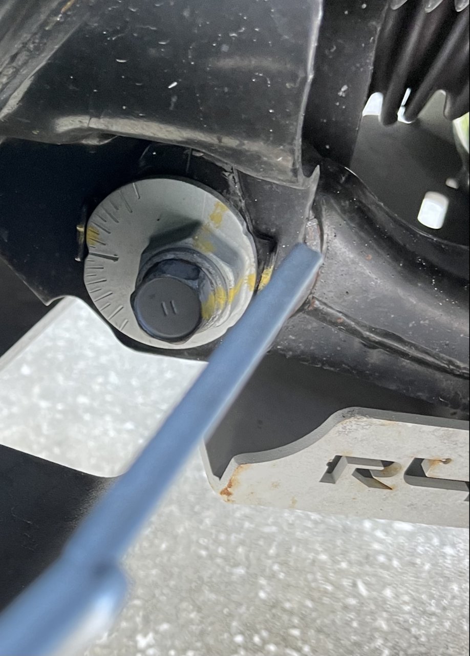

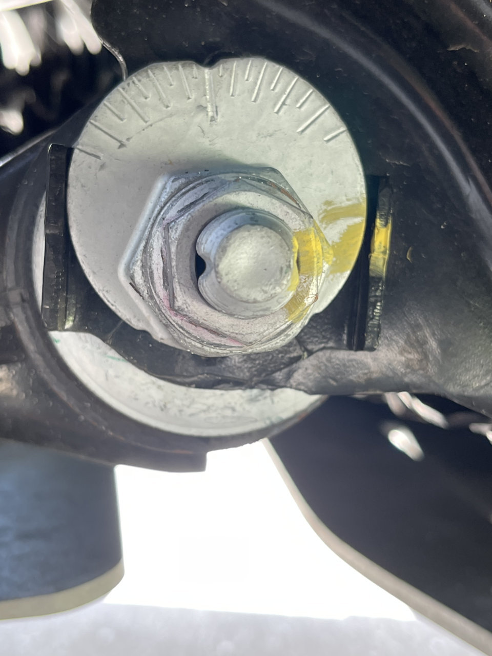

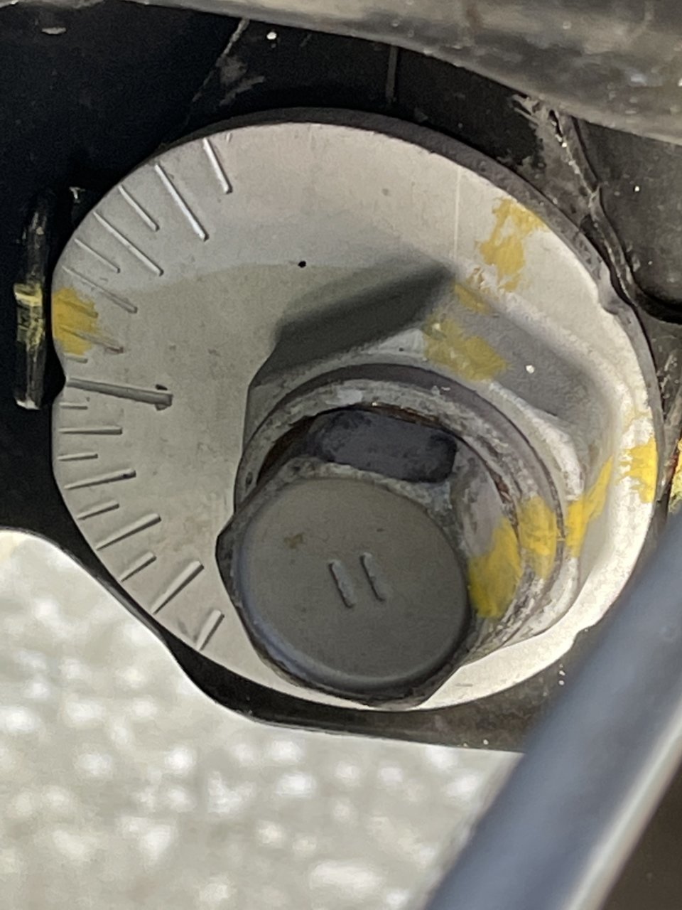

    Is this what you were looking for brother? There’s two of these. I have no idea what they are and what they do but it’s the only thing I can find under the truck that looks remotely like the picture the guy posted up above. Thanks man.

    All of them.
    Which of those is front and which is rear?

    This one is the front on the front drivers side.

    All of them.
    Let's see rear on same side

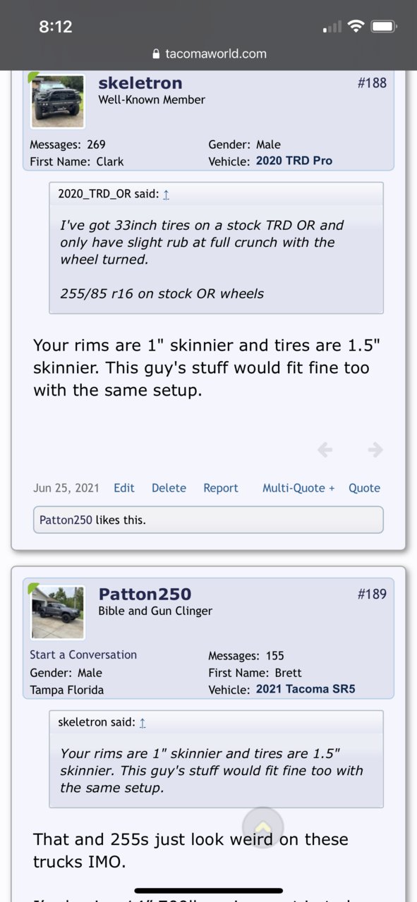

    Yeah you and some other people suggested the 33x10 route and this was the general's response:
    He concedes they won't rub, but look too weird for him.

    Your cams are pushing your tire back. They are pretty much backwards from how they should be
    GSRON, saf023 and Patton250 like this.

    Yeah. The front cam should be turned so the bolt is all the way in. The back cam all the way out. It will push your tire forward like 2 inches.
