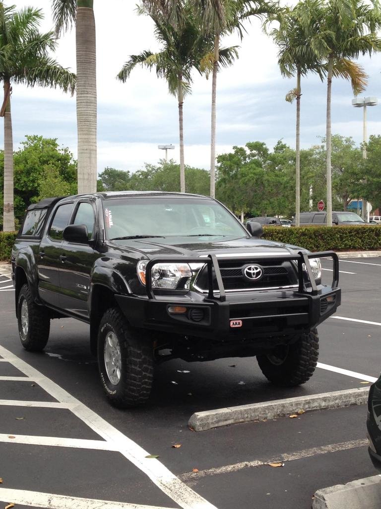

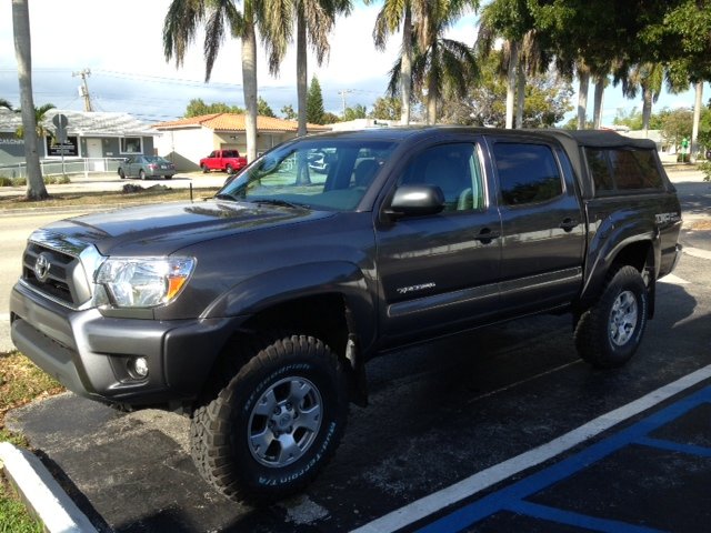

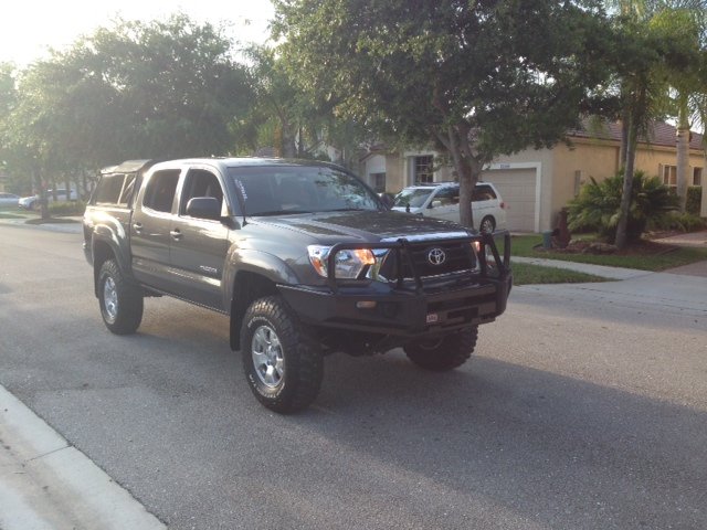

    I would go with Old Man Emu. In my eye's it's the best lift you can do on almost all Toyota 4wd models with out stepping into Coilovers.
    I have a 2014 DCSB 4x4 running OME with the following set up.
    Front 866 Heavy
    Rear Dakar Heavy (R & L leafs have a "+" sing on them, correct me if I'm wrong but I think that means they are heavy lift.)
    Cambrug UCA (Using OE Ball Joints, So far no problems)
    4 OME Nitro Charge Sport Shocks.
    Ride is a bit stiff, but I also don't have the truck fully armored up. Here's a few pictures of mine.
