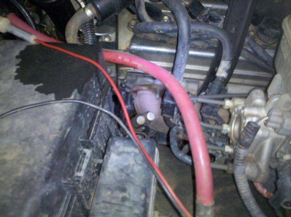

    FYI, While the auto trans might be sealed and not have a dipstick there "should" be a breather on it still. It's that way on the FJ Cruiser and I know one person that found out the hard way that water can get introduced via that route via $6,000 new transmission. The breathers for both the transfer case and transmission are located on the backside of the engine atop the bell housing. They are a bitch to get to. I have extended them on my FJ and would likely need verification of the existence on the Tacoma. , on the second page look at what I've circled. Is that the breather?
    I'd check over the transfer case and look for a breather on it as well. The FJ Cruiser was designed as a more capable rig offroad and with that I if the FJC has breather on the trans and transfer case routed up by the engine I would definitely think the Tacoma has them as well, just not in the same location as the FJC.
    Here is a link from FJCruiserforums describing the Scuba Driver mod and the locations of the breathers

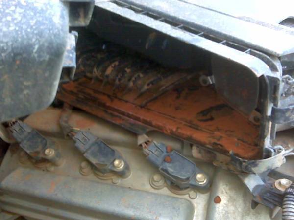

    getting looked at by mechanic. it is the computer must have gotten messed up from the water. interior is fine. he also found a coroded connection leading to the computer. Everything should be good!:rolleyes:
