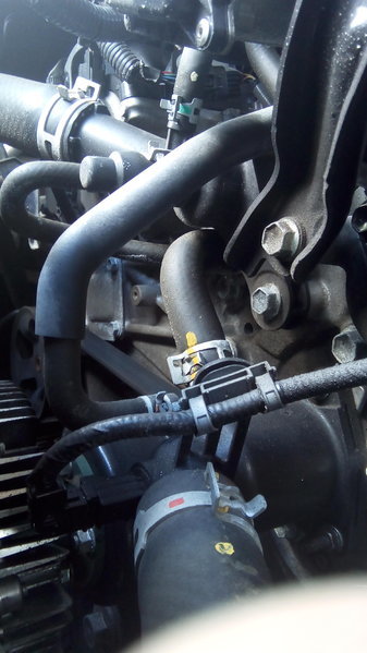

    Mine has a very small clearance between the metal bracket and the sleeve protecting the hose. If the sleeve wasn't on, it wouldn't be close to touching at all. However, it is still rather close and I will be grinding some metal away as a precaution. Thanks for the heads up. Decided not to grind. Put a tie-wrap on it and moved the hose downward a bit. The tie-wrap is around the protective sleeve. Time will tell if it moves or not.

    Toyota will probably revise the hose (e.g. mold a 90 deg bend into it) in 2019 or something...

    Why not just remove the hose, cut 1/4 inch off and put it back on ?
    Then you have clearance.
    You might not even need to remove the hose. Just take a razor blade score 1/4 inch all the way around cut it off and push it down a little.

    That looks like it would work on my truck. I will be showing it to toyota at first service and see what they do first.

    Hey thanx OP... I just performed your mod to the bracket... less than 5 minutes.
    Mine was touching and the "hose protector" sleeve looks like it has rubbed a fair bit.

    Thanks for the heads up OP. Mine is touching so it's time to bust out the grinder.

    Checked mine and it was rubbing. Pointed it out to the dealership during today's routine service and they ground back & painted the bracket.

    It's not the consumers job to play mechanic. This is absolutely a design flaw on part of Toyota.

    glad that issues was resolved for you. My truck is diffetent- lots of clearance fwiwIMG_20170304_151247.jpg
