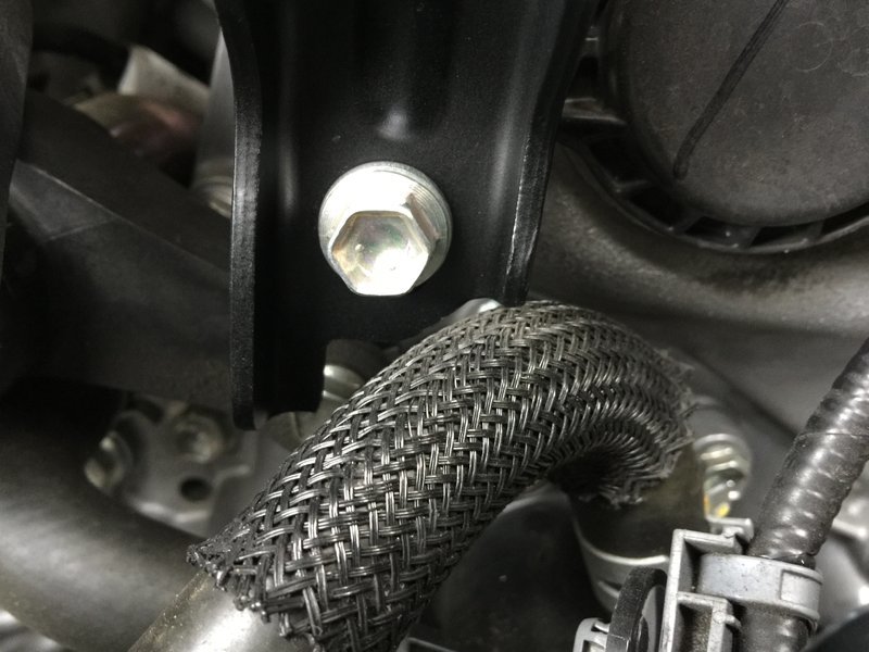

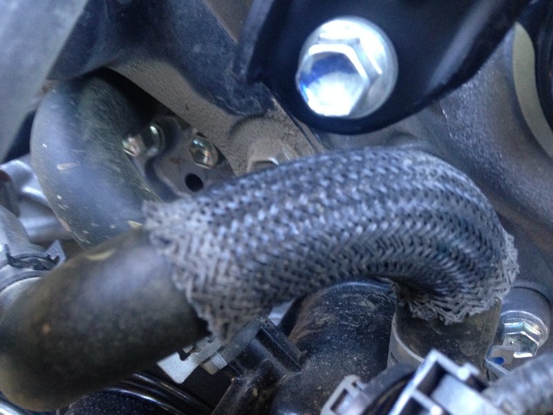

    I'm gonna do mine next weekend. It's just touching the protective sleeve right now, no pressure on the hose.

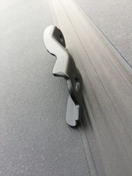

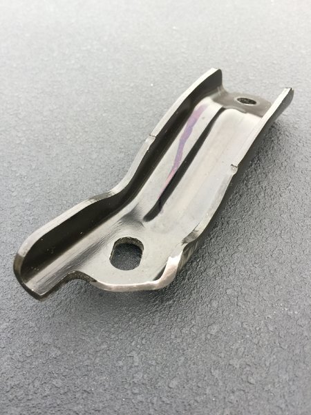

    Screw it, just did it. Didn't even take 10 mins to hit it with belt sander and repaint. Thanks peanut!

    Joe, I think you just outted me... I am actually a Soviet Spy living in Canada and was trying to work my way into the Trump organization, until I realized what a Dumb Fuck he is,.... I'm gonna stay in Canada now...
    Back on topic... took 4.5 minutes to remove grind /paint and reinstall.. No freakin' sweat ...!!!
    I hope you guys check it on your truck, eh...!

    Another "fix it". Gonna be doing this soon, anyone torque it down to a spec? Thanks for the find OP.

    Torque/Smourque... just tighten the M'er F'er..

    Given the size and grade of bolt I'd say somewhere around 25 to 35lbs top
