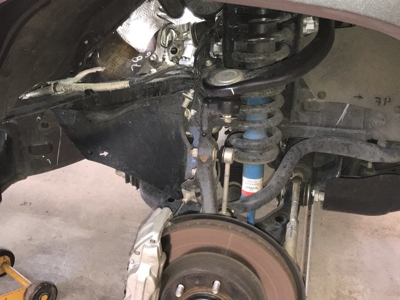

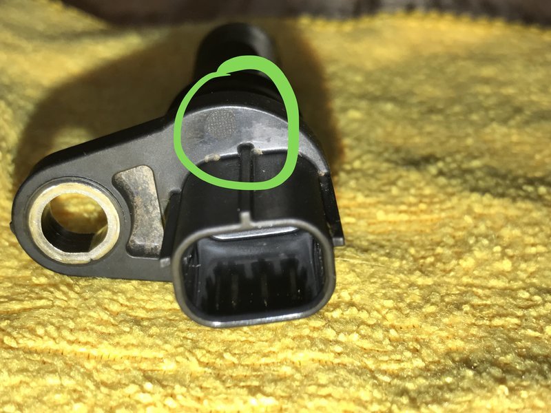

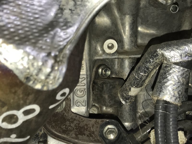

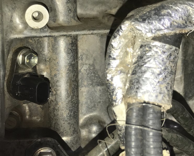

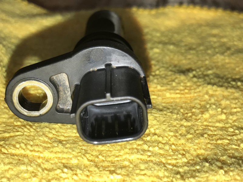

    Okay, so here is my pics from checking mine which is a 2017 DC TRD Sport with a build date of 8/16 made in Mexico. I appear to have the hash marks which makes me think I'm good to go. However, I may replace it anyway for peace of mind AND to have a spare in case it fails as it is EASY to change.
    1). Jack up and remove passenger side wheel. This makes access to the part SO MUCH easier as it is kind of far up in there. Also remove the rubber flap cover with a panel tool. I only removed the two top pins and let it hang.
    2). Locate the CPS sensor which has a protective boot over the electrical socket. (This fooled me first as it's hard to tell it's a boot vs. a sealed part. It's a boot!)
    3). Removed the 10mm bolt and carefully pull the CPS sensor out without damaging the O ring that seals it.
    4). Carefully inspect the part for the said hash mark shown below on mine OR reverse the process at this point to replace the CPS sensor. (Recommended to lightly coat the O-ring with a little motor oil to ease installation)
    5). Torque the 10mm bolt to 7ft-lbs, reconnect electrical connector and re-install the rubber cover. And you're done!
    stealthmode and tomwil like this.

    Good write-up with pics which I was too rushed to do ;) Mine was the same build month as yours from Baja and mine didn't have the hash marks and had a diff part number on the new vs. the old. Those numbers were tiny though and I didn't bother w/ pics :(
    Just in case, I have the old one in my toolbox so in the event this ever causes me a problem I at least have a mostly functioning one to replace it with. Can't hurt.
