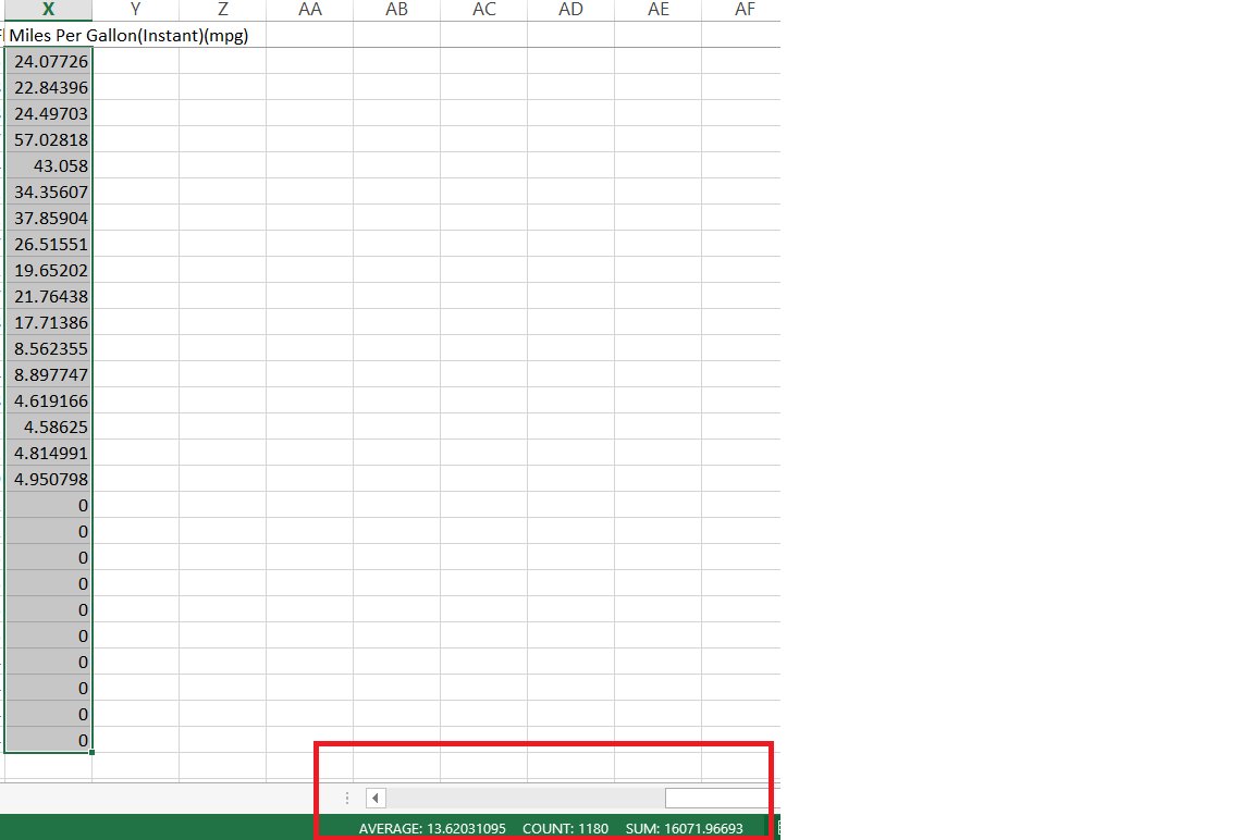

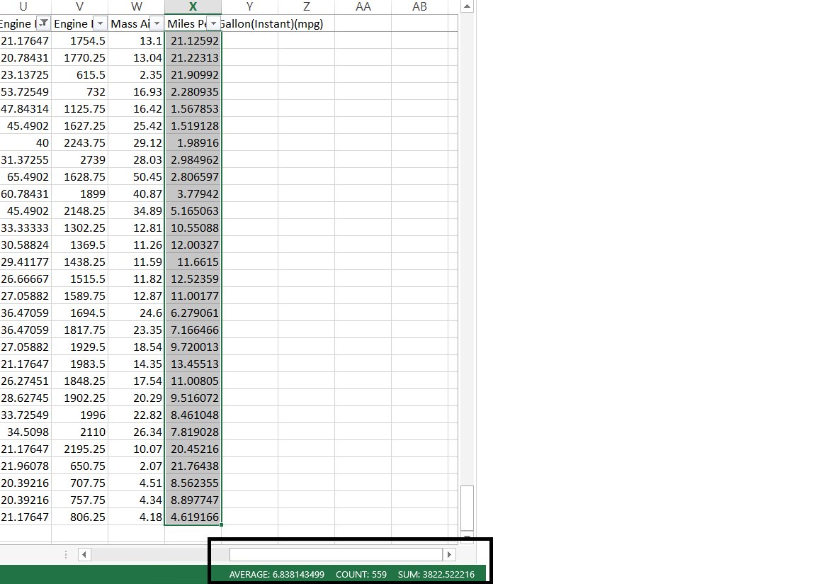

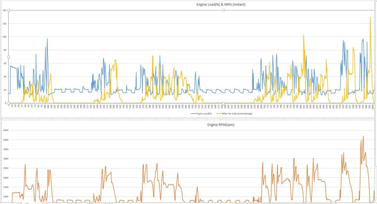

    I finally got the logging to work. Now it's a matter of organizing the data into something that can be meaningfully mined. I am not a gear head, and I only know the basics. If I am approaching this the wrong way, please let me know.
    My factory dash seems to show lower mileage than the Torque app. For example, this trip I averaged 13mpg per Torque app but 11mpg per the factory dash.
    Also, I filtered the data for engine loads that were over 20%, and I found that my average fuel economy (average of MPG/instant) was 6.8 mpgs? People are towing 2000lbs and getting 15+MPGs on this website?
    Engine loads under 20% had an average of 21.7mpgs. (average RPM was 1391rpm and peak rpm was 3963 under in this engine load range). I don't see how people are hypermile'n and getting 25+ mpgs.
