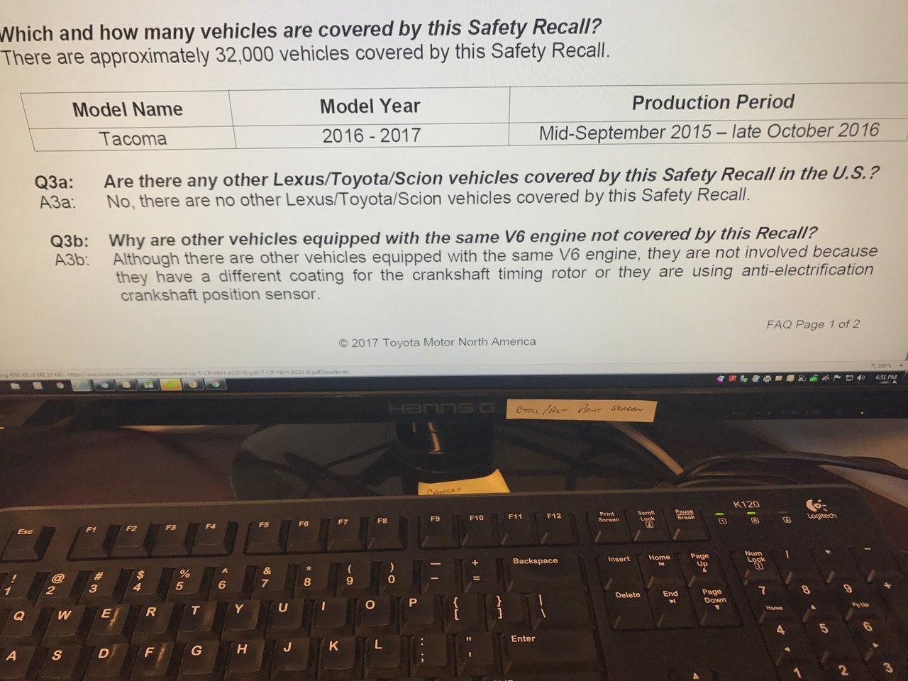

    When I looked at the recall for the CPS, I noted that it was for Sept 17th, 2015 to Oct something 2015...
    I did not know that it included trucks in Feb. 2016.... Where did you see those dates..??

    The recall letter states:
    "MID SEPTEMBER 2015 - LATE OCT 2016"
    See below

    OH crap. I musta missed the "Late Oct 2016" and thought it was "15"......
    Thanx a bundle man... That makes more sense now...
    My bad..! From what I can gather, my truck was made in 09/15....I might have the last of the good CP sensors.... Hope so.
    I just don't know the actual date of birth, as the recall started at sept 17th 2015....
    Mine gets great MPG...(28.8 cdn) on trip to B.C. and back... and has no issues, so I think I'm lucky... (fingers crossed)..
    Thanx again.. :thumbsup::thumbsup:
