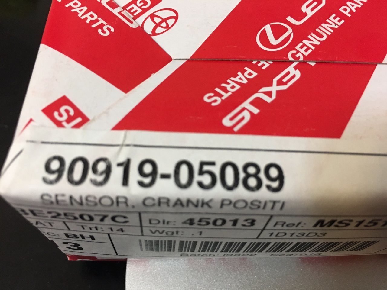

    The part number is what matters....I don't see it on that...the one you want is part # 90919-05098

    The last 2 numbers on mine are 89, not 98.

    That's the old style one, 98 is the new version

    I guess I'll have to send it back (if they'll take it). That's weird that a previous post (pg 12) detailed his change out with the old part number and says it works better with increased mpg. I guess his "new" part hasn't failed...yet.

    Some people including myself had success installing this part. Several months ago, we found out that there was a "new" part ending in -89 that had new markings. I think this was an internal correction before they released the recall.
    Fast forward a bit, recall is out, with the correct fix being the -98 sensor. Who knows if there's a difference between the two, but if you're going to swap it out, might as well do it with the newest component. I wonder if -89 will continue to be manufactured, intended for those trucks which did not get too much anti corrosion coating.

    Some feedback after getting my "new -89" swapped for the "new -98". No noticeable difference. MPGs are unaffected, pedal buzz in unaffected, throttle response, all that good stuff.
    I'd hate to spread bad info out, but I think that as of today, the -89 and -98 are the same part.
    I managed to give my original production CPS back to Toyota, while keeping my -89 with the hash marks for backup.
