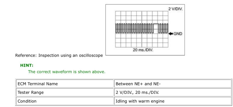

  5. Jul 22, 2016 at 5:11 PM
    #45
    aggie77
    aggie77 Well-Known Member
    Oct 28, 2015
    #167980
    418
    Georgetown, TX
    2016 Tacoma Ltd 4x4
    Lund Nerf Bars Auto tailgate unlock
    Well, here's a normal waveform.
