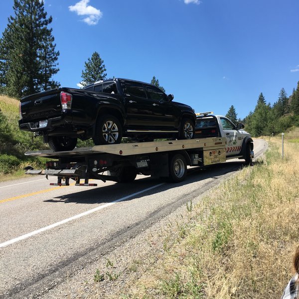

    Mine failed this weekend at 8500 miles. It started jerking and then died. It wouldn't restart. I was 86 miles from the nearest tow and pulling my tent trailer. It took 3 hours to get a tow truck. They had to send two because I had three passengers. Toyota care covered my truck tow but would not cover the second truck required to get my passengers. The lady on the phone said I needed to call a taxi. I'm not sure where you find a taxi in rural Montana but she didn't seem to care. I'm out $350 for towing, $200 for a last minute hotel room, and a day's wage. They changed out the CPS and said it was fixed. Half a mile from the dealership it started jerking again and the check engine light came back on. They decided the CPS failure ruined my catalytic converter and exhaust system. It seems to be running fine now but I don't trust it. I am not happy with the response from the Toyota care people. The local Montana dealership went out of their way to get us back on the road but it was a huge and expensive pain in the ass! I hope Toyota issues a recall so that others don't have to experience the same frustrations I have.

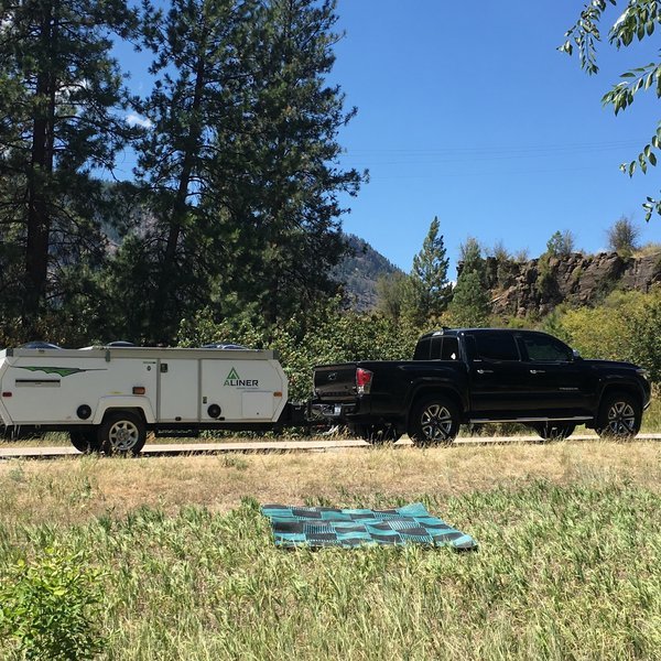

    I would say my experience was dangerous. It died on a two lane highway in the middle of nowhere. I was not able to get it completely off the road with momentum since I was going uphill and pulling a trailer. Luckily a nice farmer let us sit in the shade and brought us water while we waiting nearly 3 hours in 98 degree heat for a tow.image.jpg
