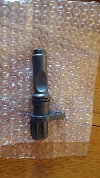

    Well my new CPS showed up today. This bad boy is going in my toolkit incase of failure in a remote area with no cell service, tow trucks, or Toyota's shit service. I'll make a video of the install should it ever go out.

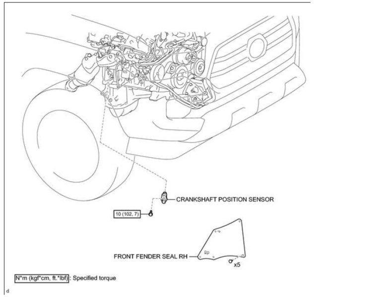

    A couple of weeks ago, I had found a drawing that showed the location of the CPS. I want to heat shield it. I got the material, and now I can't find that damn drawing again. Can anyone tell me exactly where the CPS is located?

    Knock yourself out...

    It says made in Japan...no markings on the part.

    Thanks, Hammer!

    I just ordered one of these sensors from my dealer since my truck is an early build - 10/15. They came down a little bit on price to make it close to what I could get online. I am going to install it this weekend after confirming it has the grid pattern on the bottom and is the updated version. Dealer said there were plenty in stock at the Los Angeles warehouse FWIW.
