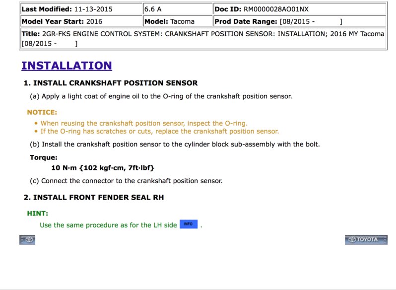

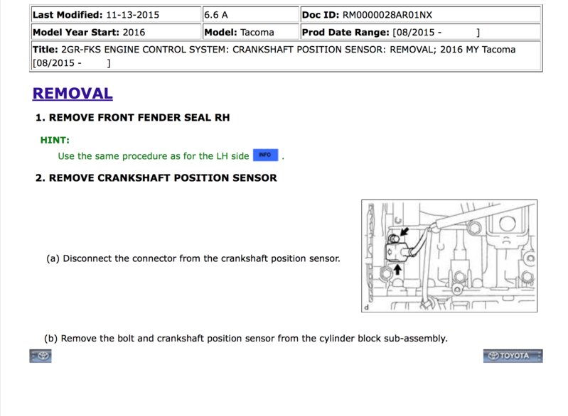

    Hey guys, someone posted details on install...any help there?
    I can't find it for the life of me!
    TIA

    Here you go.
    MTNHABITOVERLAND likes this.

    those two pages and the other one above that shows where it is, is all thats in the manual for it.
    and no worries man.
    Hopefully you never have it fail and need to change it on the side of the road.

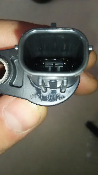

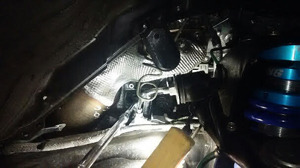

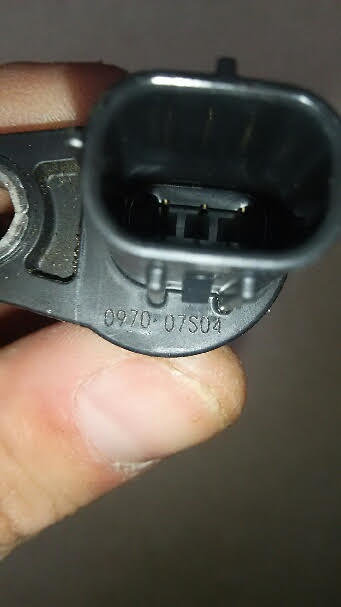

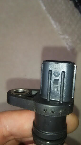

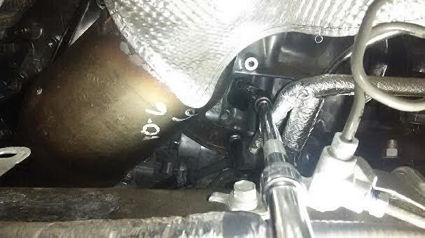

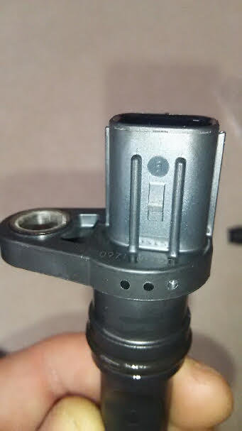

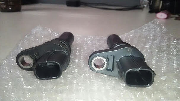

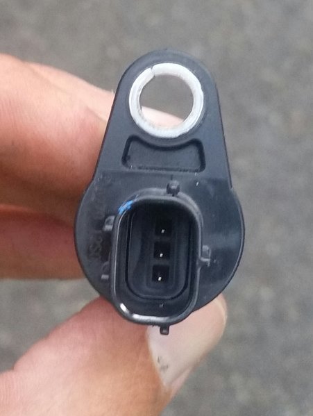

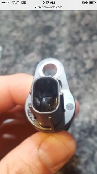

    I swapped mine out hopefully preventing a future failure in a remote place, took 10 min. I know people have posted the hash mark as the new part identifier, but there were a few other differences as well.
    Here is the sensor location, passenger-side-fender-well, behind left rubber flap/splash-sheild. It has a rubber boot on the plug, pull off boot, push in clip on plug, then 10mm bolt.
    FmJ32o1XuVOYWWGmeYhyBs38kBD9h9SNiCMLworo_868a970c2a2535a4b4c929537fc0b3a1f73f2dfc.jpg
    -OB-4IatWr9KEFyUDCwnsxLWyXA-gNuMu5-PpxdS_261383dcb1d1a74d8d7fa1efdf16678b8dfad8e6.jpg
    old on left, new on right (hash mark circle)
    a8-i9wRL-v1_fJoeMt_vM4JQwAoV48oVom1Kd8wl_dabadc6cb10ae4f3720ca8821eb466c4afa8cd6f.jpg
    Old Shows different number than new
    HcT1d93rNlD38_LU1xA-x7vIhbyA4HtKKShdi5CC_7199eec38e5518839597e54f451b827a0a101924.jpg
    New
    r_HKe83MULS5GfwplrYR9wgemTV0_ma6PvaImp_U_98c1f5cf14c40f3ab2e388e481e799a22d5b75fe.jpg
    Old shows 4 here
    rtDEPaolKcAUE2h_s86xFBa5Uesclfw-c9P4xnSj_c2e6c69aa714c9d54f71ffd6cea6741349179b06.jpg
    New shows 8 here
    -PCFkGIgB_gsVnGYSBikg5Y65_D5zM3rFTeLd6ga_555ce861d9689d7dff28b5569377f4590ee25aaa.jpg
    I was going to make another thread so this info didn't get lost in these pages, but figured there was enough CPS threads already.
