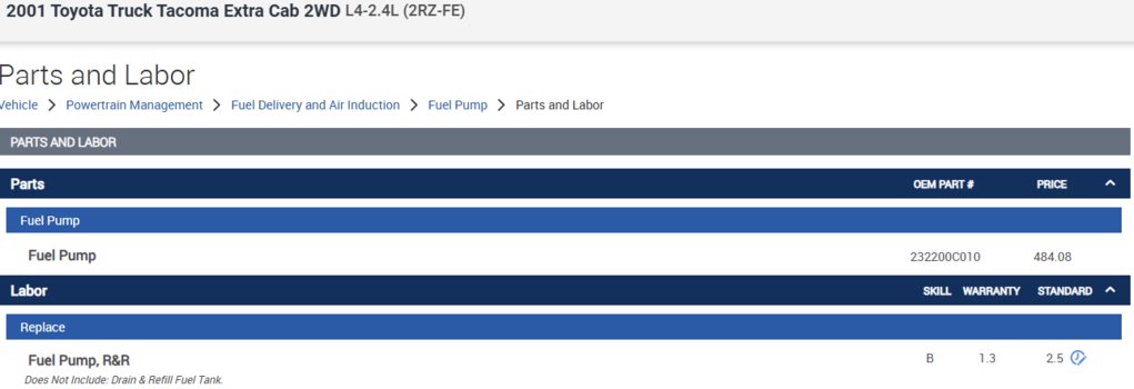

    Huh, alldata has this job booked higher than I would think TBH, certainly in parts cost

    Yeah, 3.5hrs seems steep to me having done a fuel pumps myself on these trucks in around 1.5hrs round trip. But the criminal part is charging $484 for an $86 pump

    484$ is close to what actual MSRP listed is from the yota dealerparts
    Fuel Pump Assembly with Filter #23220-0C010 | Autoparts.toyota.com
    is that 86$ pump you list sketch? or is it the Exact Same part in all ways shapes and forms, minus the fancy Toyota Genuine Parts box lol
