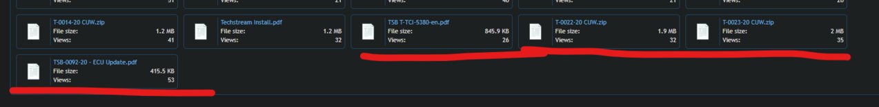

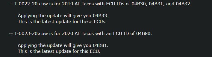

    I have no idea what you're saying here, but attached to the 1st Post are the US and CA TSBs being discussed here and the CUW files for the 2019s and 2020s:
    hotrodder636 likes this.

    In the TSB pdf there is a list of calibrations with a link to the new calibrations. The files are missing on the link to the new files

    Those are not missing. They're on the TIS subscription, Toyota file system data. The other underlined ZIP files are those files. This is all detailed in the 1st Post. Which CUW goes with which TSB, Taco, and ECU ID.

    lol your funny, judge much for asking a question. pdf doesn't state what calibration id's use t-0023-20 vs t-0022-20. I've flashed plenty of cars in the past, but also not smart to just flash without a lack of info to tie everything together.

    As noted, all info is in the 1st Post:
    If you're not going to read, you're gonna struggle. See it before.

    Just a hint, you might want to relabel your initial post on the usb to state "spoiler: attached are the cuw files and description..." Seeing the files below not everyone will click it, but that is where the key information is.
