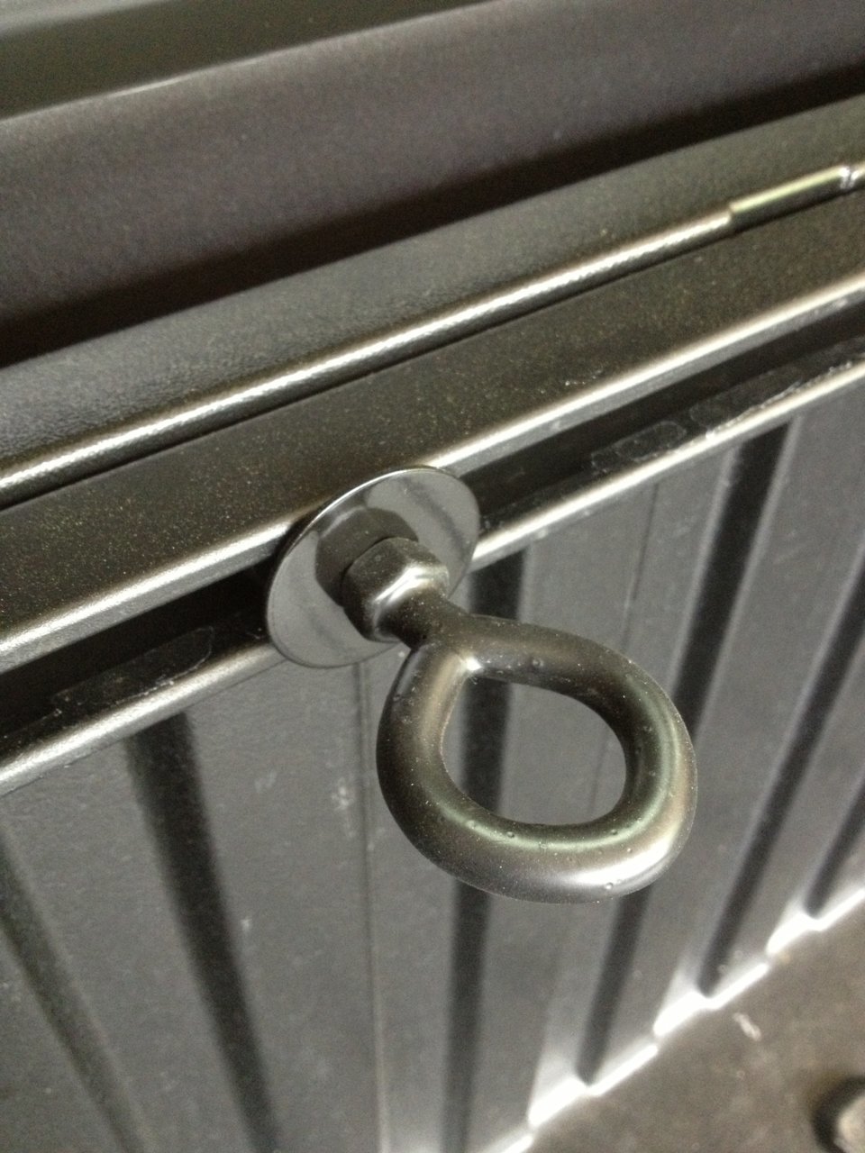

    I found the same issue with mine where I didn't care for how my motorcycle straps connected to the stock cleats. A guy in the 2nd gen section awhile ago created this thread for DIY tie downs on a budget: https://www.tacomaworld.com/threads/additional-bed-rail-tie-downs-on-a-budget.170758/
    I ended up using that thread to create some but I went with eye bolts that I dipped in plastic-dip. I also could not located plastic washers but found some rubber ones I used instead for against the bed rails. A few used the spring nut for the rail slot and some others used the T-nuts that people later located that fit the rail perfectly. Both solutions work. What I like about this is how cheap it is and how I can leave them on the rail and not worry about them being stolen since they are so cheap to replace. The only downside is they do not pop in and out of the bed rail easily like the stock ones do.
