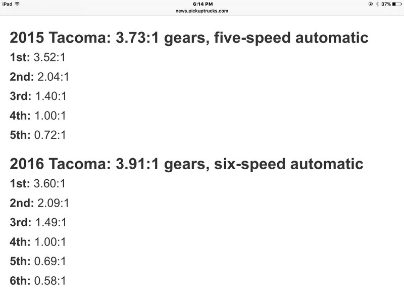

    I mean it CAN...if you call 3700 rpms in 4th gear holding it.
    idk why...gearing, lacking of low end torque maybe?
    If you have it on cruise its almost unbearable, you can control it more without it.

    I'm curious if anyone will make a chip or tuner for this motor cuz with that dual injector system they should be able to really dial in that fuel and as for the 4th gear runs the 5th and 6th are overdrives no vehicle will pull hills or head winds in overdrive
