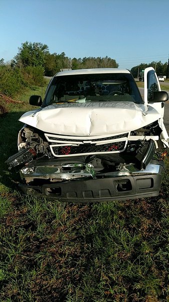

    I bought my first house on Friday May 31st, then Tuesday April 4th I totaled my truck. I stilled owed some money on it, so the remainder of the insurance settlement wasn't going to go far. The house also needs a roof soon and some other work, so I didn't really feel like going further into debt.

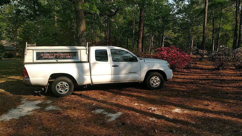

    My Dad owns a small security alarm company and has a couple of trucks for his installers. He just bought his installer a new work truck and this old Tacoma was coming available. He offered to sell it to me for cheap since he believed it might need a motor soon and some other work. I guess he really took pity on my situation, because he sold me the truck for $10.
    At first I thought it was going to be a fleet model with NO options, but was pleased to find out it's an SR5 with power options and cruise control. The truck has 248k on the clock but seems to run well despite burning oil. The brakes feel kind spongy, and the truck sometimes misfires a bit when accelerating slowly from a stop. I work in the medical field now, but used to be a mechanic and have alway enjoyed turning wrenches. I am confident that I will be able to address any issues that arise due to the high mileage. I acquired the truck April 13th.
    The camper top was originally for a S-10, so it leaked and generally just made the truck look like a work vehicle.
    The truck got put to work right away hauling materials from Lowe's for my privacy fence. Even though the truck is not at all optioned how would have picked given the choice, it is certainly a useful appliance. Unfortunately in this state that's about the only good thing I can say about it. I decided to make a few improvements to make it look less appliancey.

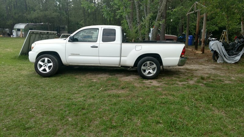

    I found a set of 5 Charger wheels and tires on CL for cheap and jumped on it. They are much lighter than the 15" steelies that came on the truck. They are 17x7, +22mm offset (4.78" backspacing). I'm happy with the fitment, the wheels are nearly flush with the body and the tires don't rub. I think there are some Corolla center caps that will fit. I need to make a trip to the junkyard and try to snag some.

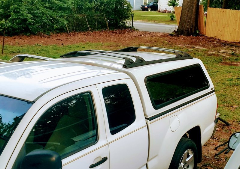

    I wanted to put a roof rack on my camper shell. So I picked up 2 Pathfinder racks from the junkyard for $50. I'll take more pics when I get it attached. The Pathfinder racks has some nice features, I think it will be a good fit. Here is a pic of it laying up there with the crossbars from both racks. This is after trimming 8" off of the rails.

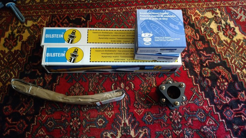

    Suspension parts! Bilstein 4600's, KYB strut mount and hardware, eBay spacer/AAL.

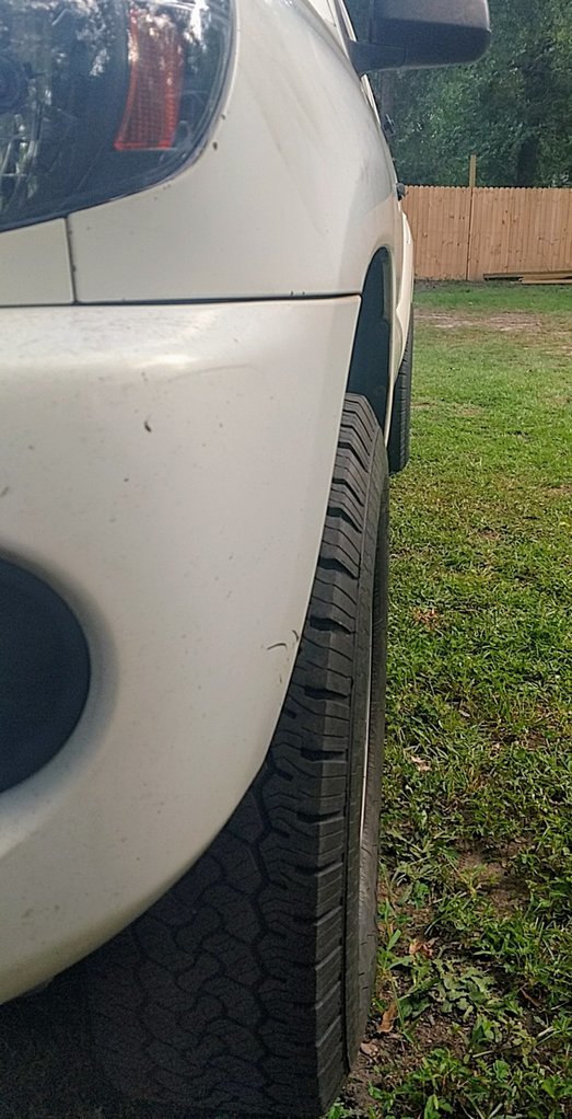

    Finally got the rear AAL done and got it aligned. I'm very happy with the tire offset and fitment. Since the 5-lug has a car-like wheel offset from the factory I decided to with a car wheel (17x7 +22) I also wanted a narrower tire. This way it doesn't look like it needs fender flares.
