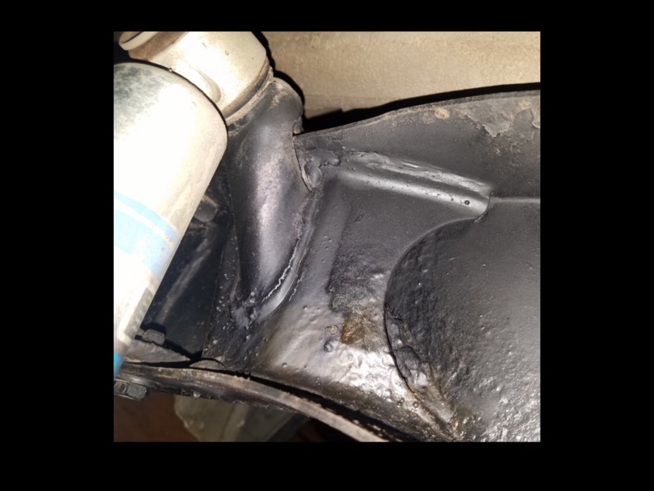

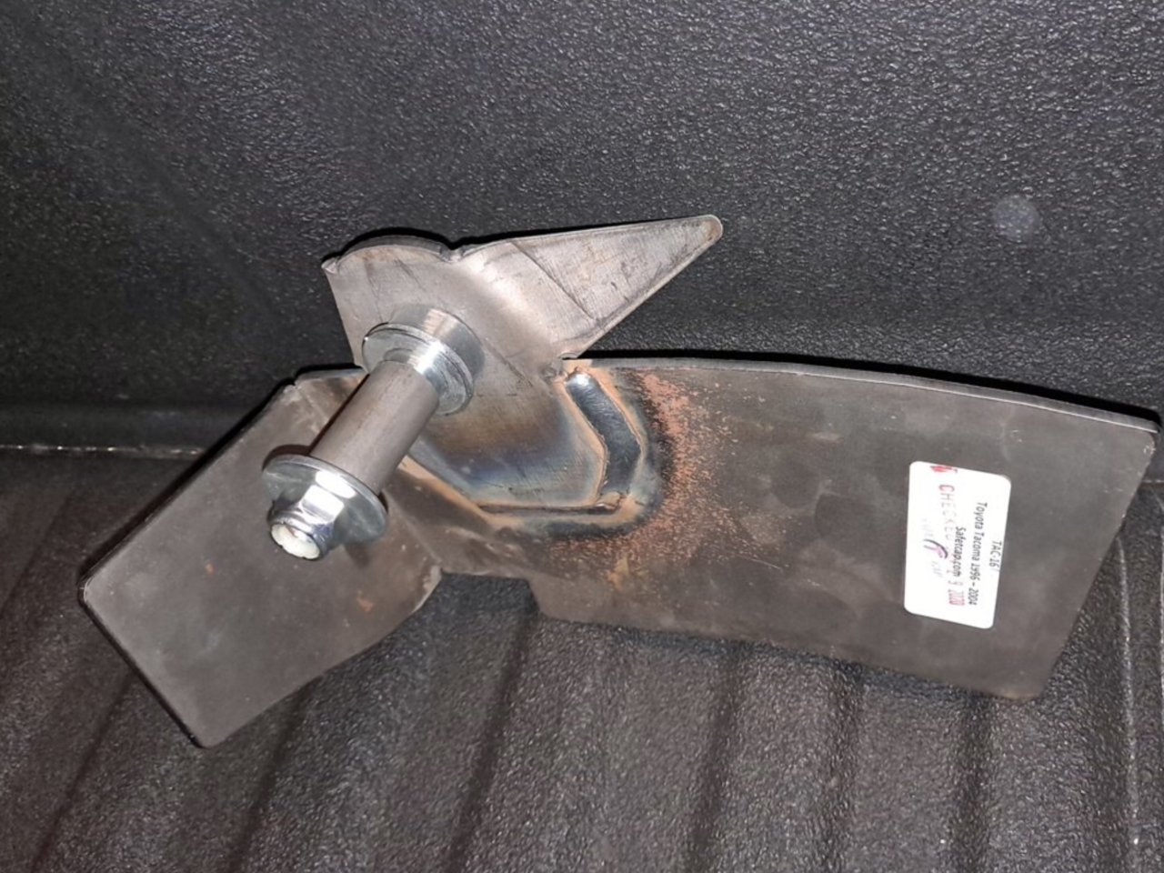

    They don’t, BUT your biggest concern you should be inspecting is the rear shock mounts at the top of the frame
    YOU HAVE TO remove the spare tire to inspect.
    This is one of the 1st place rust starts because of NO drainage.
    My frame had zero rust except for this area so I had to have this shock mount cut out and replace with a different design mount

    Yup, for my truck this mount is like a 1/2 ice cream cone cut in half and welded to the frame with NO drainage
    96BlueTacos[OP] likes this.

    I had the old shock mount cut out and this one welded in,
    Now there is no worries for water to be trapped

    Is the new shock mount from
    Safe T Cap ?

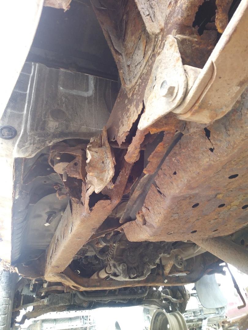

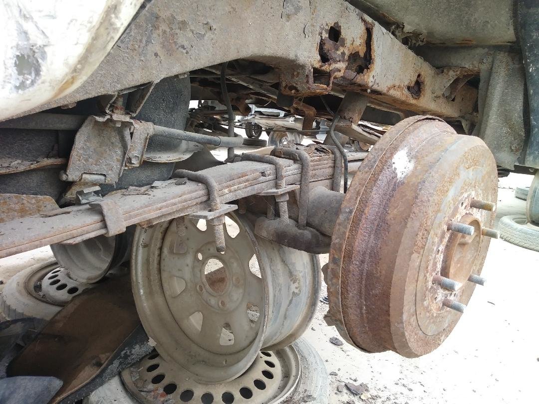

  20. Oct 26, 2020 at 3:16 PM
    #40
    GQ7227
    GQ7227 mw survivor
    Dec 6, 2018
    #275019
    29,298
    J A Y
    you should've seen what they must allow on the roads a state over here, from a 97 3.4 single cab
    i lost something the day i stumbled upon this :(
    driven into the ground, literally
