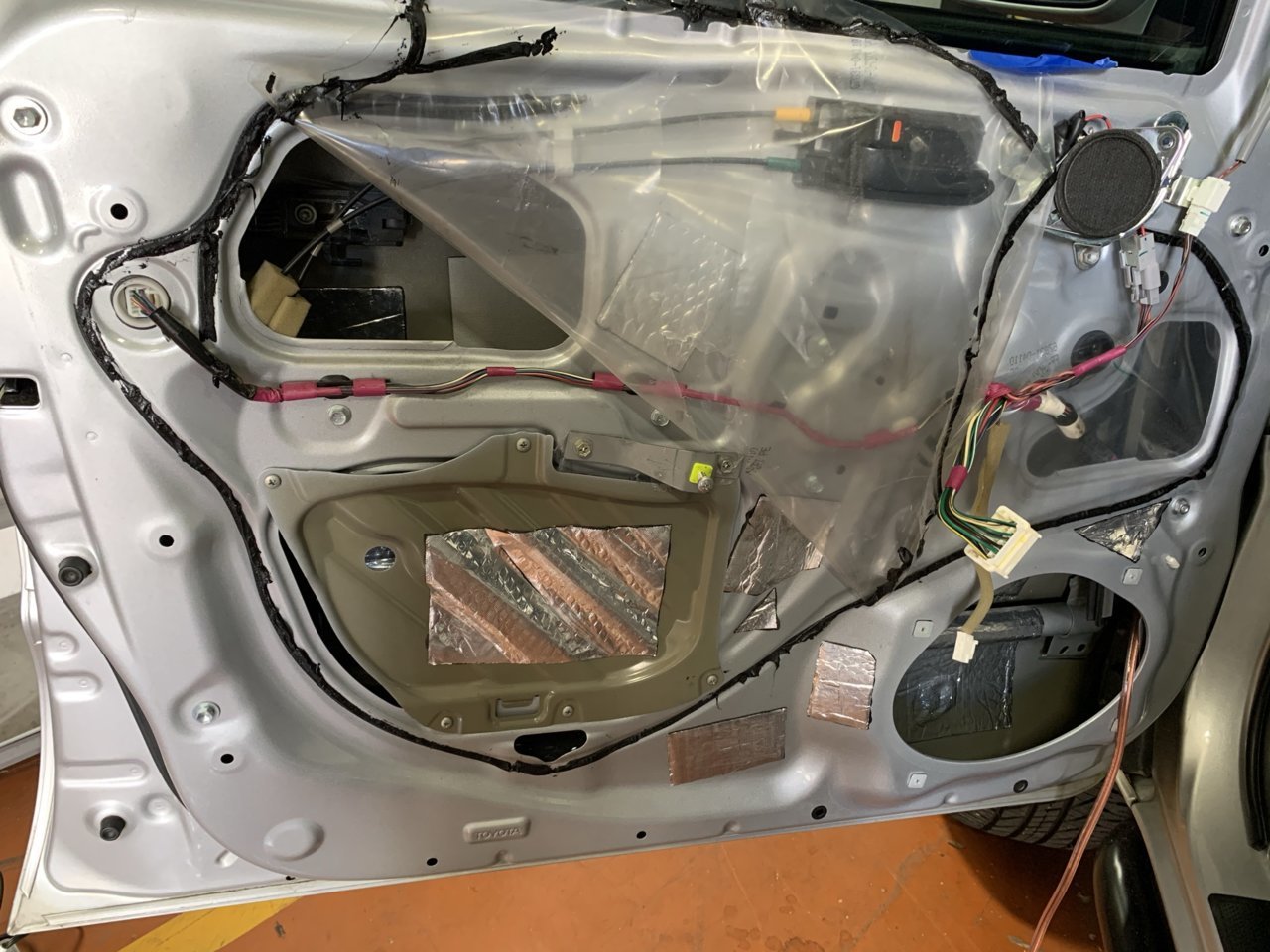

    I just installed a new Kenwood 594BT head unit, and tomorrw my new KENWOOD KFC-C6866S 6x8" 2way speakers will be here tomorrow. I want to improve the sound fromt this system, but I'm not in a position to sound proof my truck right now. so here's my plan
    1. I'm going to put some hushmat around and under the speaker mount on the door, and then put some on the outside door skin under the speaker hole.
    2. then I'm going to put some dynamat Speaker Wave-Breaker Kit material on top of the dynamat under the speaker hole too.
    I want to do this for all four doors. So will this help cut down on door vibrations and better speaker sound, or am I wasting my time and money. these are the 2 materials I'm looking at.
    Not exactly dynamat, but I can get it somewhat quickly
    https://www.homedepot.com/p/HushMat...-1-4-sq-ft-Black-Stealth-Foil-10110/310188428
    and for option 2 listed above
    https://www.homedepot.com/p/HushMat-0-89-sq-ft-Speaker-Wave-Breaker-Kit-82450/310188430
    Thanks for any replies good or bad, and any suggestions you might have.

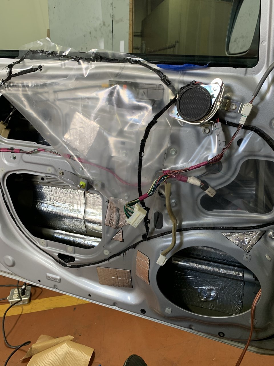

    I did this previously and just finished my rear doors this weekend. I used Noico 80mm sheets and it was a night and day difference. I only have my HU replaced at the moment until my amp comes in to replace my fronts with Morels. I put a sheet directly behind the speaker. A sheet on the upper outer skin of the door and on the lower skin. You can see the silver Noico and where i placed it. I wouldnt use the stuff from Home depot as i think it will heat up and cause a smell in the truck

    I wound up ordering some kilmat from Amazon, and 4 pieces of hushmat for behind the speakers. I notice there are many who put another layer over the door using Ensolite or something similar. might or might not do this, depends on the cost, and I'm on a tight budget.

    You could get a box of Noico for $70 that will be enough to do all 4 doors and the back wall of you plan on adding a sub. Half of that would also be plenty and prob better than the killmat. From what I read the Killmat is hard to work with. A small hair dryer or heat gun for about 20 secs works great on the Noico. You can put the Noico behind the speakers like in my pic. Also get a metal roller to help apply it.
    This will prob be good amount for your doors. It goes a long way
    @CrippledOldMan some fast rings may help as well. What’s your budget? We may be able to come up with something to help. Check the items below
    Noico 80 mil 18 sqft car Sound deadening mat, Butyl Automotive Sound Deadener, Audio Noise Insulation and dampening https://www.amazon.com/dp/B012B5EMGO
    Noico Metal Barrel Roller Installation Tool for Automotive Sound Deadening Insulation Materials for Cars & Truck (Audio Dampening & Deadener Installation) https://www.amazon.com/dp/B015WJH4ZW?_encoding=UTF8

    Thanks for all the reply's , I'm hoping to get started this weekend, maybe sooner. Just waiting on everything to get here. With the holiday season on top of companies being short handed, I hate buying stuff this time of year.

    I agree, you def don’t want blankets etc.. inside your doors. The killmat or Noico will do fine and you can even cut some smaller pieces to put on the inside of the door panel itself to deaden it some.

    I ordered a set of the panel removal tools on Amazon that came with 20 or 25 each of 10 different clips for $16 or so. It had the push pins and the door panel clips I needed.
    I used the Noico 80mil stuff. Cut it with scissors, easy to work with.

    Well I ordered some new Door Tabs from McGeorge Toyota and what do you know, they sent me the correct part. Waiting on ToyotPartsdeal to send me a refund. Still have received the 50 square ft of sound deadening material, but I have a questions.
    On the inside of the door/outer door skin, do I need to completely cover this area, or just under the speaker and move out towards the middle of the door. Second, on the door skin under the door panel itself that has all the holes, it appears most are covering this area completely, correct?
    And last, do I have to wait for warmer weather to install this, or will a 60 degree day be warm enough for everything to stick.
    thanks for all the replies.

    I would prioritize the area behind the speaker, but don't feel like you need 100% coverage. You'll get diminishing returns after a certain point (40-60% ??), my understanding is that the butyl works mostly by stopping vibrations / ringing noises, while the foam materials reduce the intensity of sound waves. I used the Noico butyl sheets on the other shell and on the door skin under the panel. You'll notice a big difference the first time you close the door after install.
    A 60 degree day should be fine, the sheets have a pretty strong adhesive on them.
