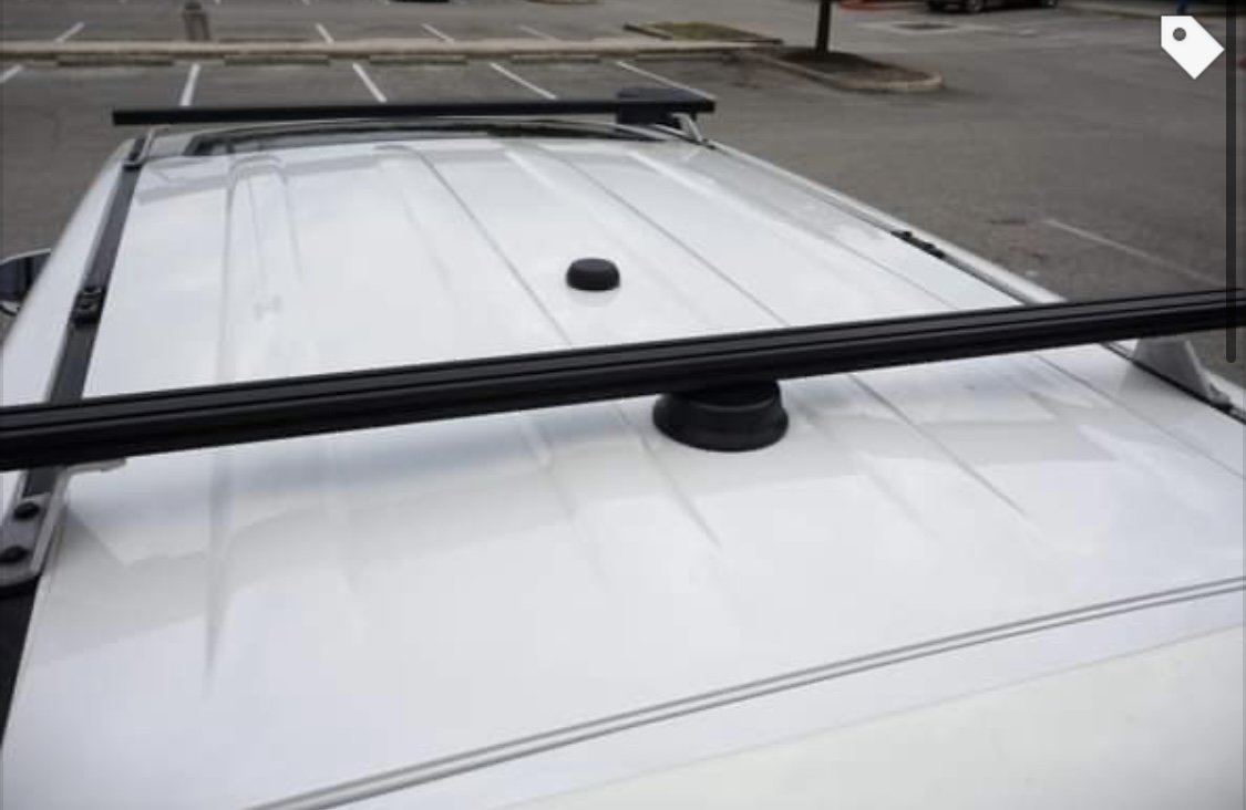

    I ran a Shakespeare sr-50 marine XM antenna on a couple past builds. I painted the top most puck black and flush mounted it. You can take apart the bulky assembly and just mount it using that top piece, a neoprene washer to go between antenna and roof, and a large washer for the interior side and the included nut. The antenna comes with a long cable that terminates with a Sirius tuner style connector, that I guess you could get an adapter for to hook to the factory setup.
    Anyway, I’d bet if you removed the factory antenna it would drop in the same hole.
    https://shakespeare-marine.com/product/siriusxm-antenna/
    My current 2011 had the factory shark fin so I’ve left well enough alone, but the Shakespeare antenna had been the best I’d ever run for least drop outs and best reception.
    Smaller puck is the Shakespeare:

    Thank ya kindly gents. Especially @JdevTac for that outside the box thinking. I'll add that to the list when I get around the head unit, for now I'll deal with it.
