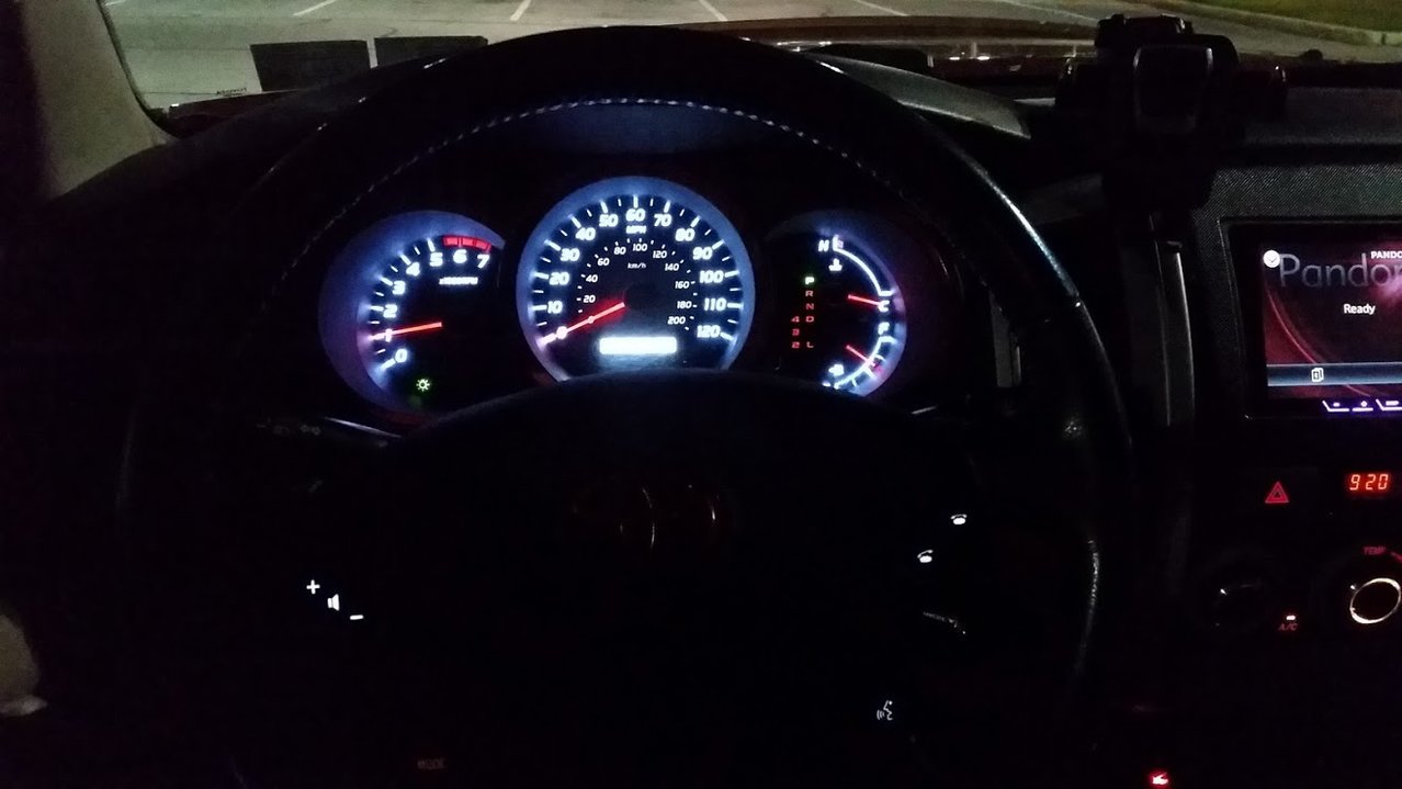

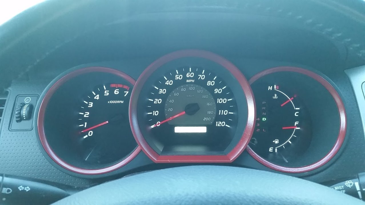

    Do an LED swap. I swapped the amber LEDs for white.
    Before (Day Time):
    After (Day Time):
    After (Night):
    JGO, lynyrd3, Tybee Taco and 13 others like this.

    1 x Soldering iron - $20 - https://www.lowes.com/pd/Weller-Electric-Lead-Free-Soldering-Kit/4734289
    25 x cool white leds (allow for extra) - $15 - https://www.oznium.com/plcc-2
    1 x rosin core solder - $8 - https://www.amazon.com/gp/product/B01LVTTL9E
    3 x hours time and a couple beers
    Total: $43
    $15 if you already have a soldering iron and solder

    After living with it for a little while (+3 months), the cool white is a little much at night at full brightness. I usually keep the dimmer at about 2/3 all the time. I've thought about swapping them again with red, but then they become hard to see in the daylight.
