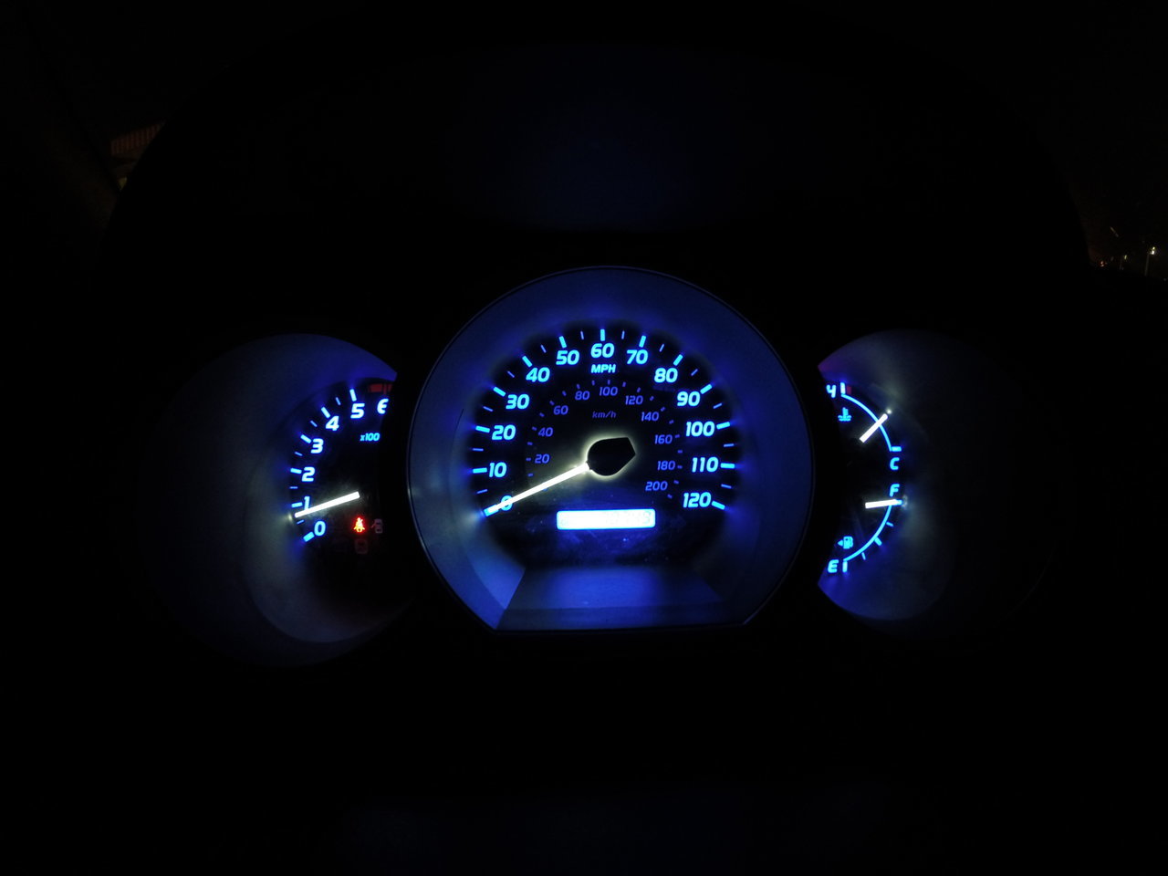

    Strictlytoyz
    Strictlytoyz Well-Known Member
    Jul 23, 2015
    #160147
    2,838
    Charles
    HA\/\/AII
    07 Shitbox
    I've only got a night shot of mine but its a simple mod and helps with visibility of gauges night / day
