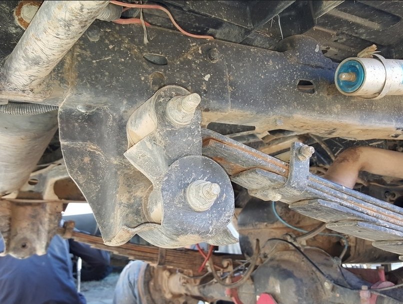

    Circling back to this thread. I ended up doing the Rago hanger kit, Bilstein 5100 shocks in the rear, and the Perry Parts bump stops. Also put picked up some new bronze rims (stuck with 16s) which look great with the Lunar Green. Probably should have upgraded the leaf springs while I was at it, but didn't think that far ahead. It all took a couple of afternoon/evening sessions and I wrapped things up last night. Only did a quick drive on the road but sure seems to be a pretty big improvement and more planted over the small road bumps I went over. The hanger was a pain, but getting the old hangers off wasn't as bad as I thought it would be. Found that using a metal blade on my Saw-Zaw and cutting what rivets I could reach with it flush and then drilling them out before popping them off with an air hammer worked best for me. For the rivets I couldn't get to with the saw I drilled and then hit with the cut off wheel. Getting everything put back together and doing a little troubleshooting took at least as much time as getting the old hangers off. I will say that this 53 year-old body is feeling it today though! Can't count the number of times I had to crawl and slither under the truck. Would be nice to have access to a bay or a lift.
    I do have a couple questions that came up during the process so hoping to get some input:
    First, when fitting the hanger on the passenger side I quickly realized that the rear exhaust pipe hanger had to be removed so I cut it away and my pipe is now hanging with no support. It actually feels pretty solid, but I know I need to do something with it. What are my options here? I have seen some people just cut it back to where it is pointing down behind the cat. Seems easy enough and I would be ok doing that as long as there are no potential issues it would cause. Alternatively, is there an easy way to add a new support/hanger without having to weld? I could bring it to the local exhaust shop and I'm sure they could weld something up for me, but I would prefer to just get it done on my own if possible. I would be open to doing a new cat-back pipe, but it could not utilize the rear hanger since it's now gone - and I really don't want to spend more than a few hundred if I go that route. Anyone else deal with this? Not sure if it is an issue with any of the other hangers or just the Rago. Oddly, I couldn't find anything on the internet about it.
    Second, on a couple of videos I watched for the Rago mount it said that when doing the hangers you should extend your brake lines. However, the hanger doesn't seem to really change my ride height and I don't have a lift other than the 1" factory lift that is standard on the TRD OR. An AI result from a Google search said you don't have to replace the lines, but not sure I trust AI that much yet. Does anyone know if I need to extend the brake lines? Or can I tell for myself by jacking my truck up from the frame until the wheels are off the ground and checking if there is slack in the current lines? I don't plan on doing a lift and would prefer not to have to change the lines and bleed the brakes if I don't need to.

    I can't help much on the exhaust hanger other than to say having your own welder is a nice thing. If you think you might start getting into other (more-involved) mods like this on your truck, it might be a worthwhile investment to purchase one and then practice on some metal scraps until you get good at it (mine's paid for itself several times over already).
    As for the brake hoses, you certainly can check by lifting the truck up by the frame so that the suspension is hanging. Just be sure to lift a little at a time though (checking each time) so you don't find out too soon that you didn't have enough slack after all. Note that you can bend the rear axle brake line bracket upward some to get an additional 1.5-2" slack in the OEM lines (a spacer on the bolt holding the bracket is another option as well).
    Lastly, your TRD OR isn't the one with the factory "lift" (it's the same height as the SR, SR5, Sport, Limited). You're thinking of the TRD Pro with it's Fox shocks that has the 1" higher stance.

    Replacing the stock hangers is one of those mods that made me very skeptical of the reported benefits. However after installing some Hammer Hangers I swear by them. I can't believe they made as big of a difference as they did.
    Bamf, Rago, Archive all make them, well worth the effort. Those rivets are a pain.

    You can just cut the exhaust tip off right after it turns down after coming over the axle. Then there is no need to re-support it.
    You shouldn't need longer brake lines until you replace the leaf springs with ones that give more droop. Even then, the shocks usually limit the droop. In the meantime, if you're worried about it, you can just leave that bracket that supports the hard lines on top of the axle unfastened so that there is a bit more play. You can easily test this yourself, but just jack one side of the truck/frame up so that only the one wheel droops. That's the more likely scenario compared to having both wheel completely off the ground (pretty much have to jump it for that to happen naturally).
