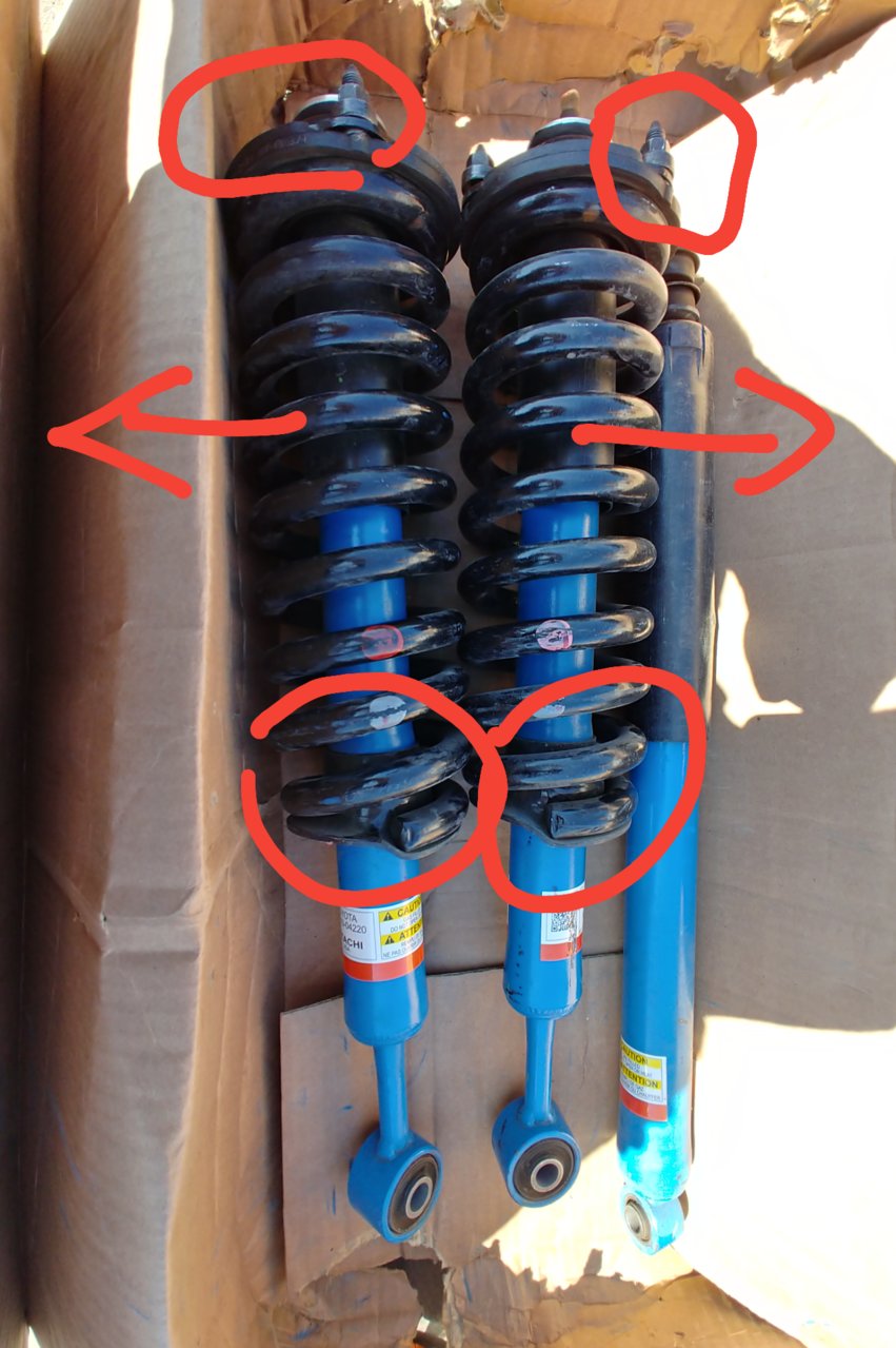

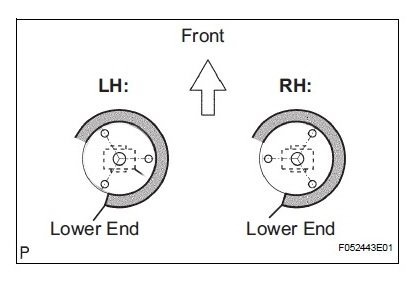

    Ya I told the shop to install them based on this chart from another thread on here.
    Coil seat clockwise, driver side the two top studs face out (right) and the passenger side the two top studs face out (right).
