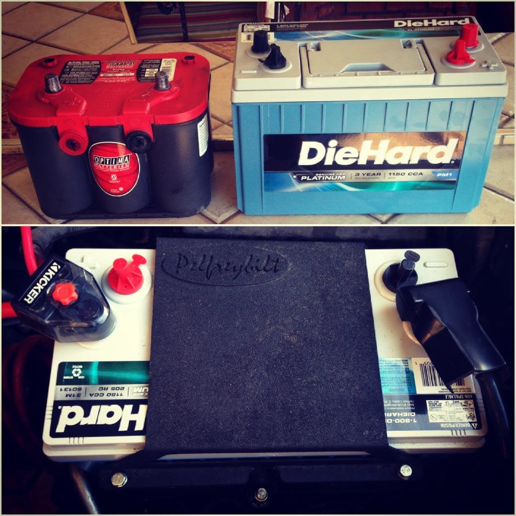

    Thinking on relocating my battery to the bed to have better weight distribution. I already have the pelfreybuilt cage for the 31m battery. Lets see how you guys mounted up your batteries in the bed.

    This is the battery I want to put in the bed

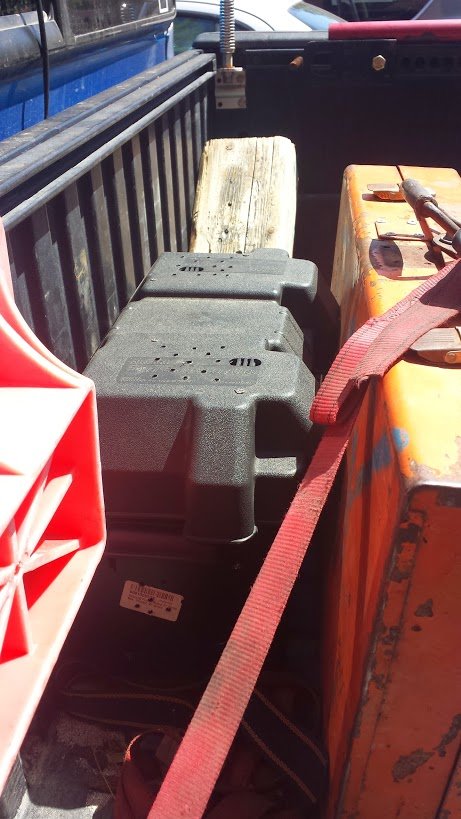

    Kinda messy but here is my dual battery with the battery in the bed 20140512_105325_a886f1d251423e32f4d67f50aa93fa60245777fb.jpg

    So the battery is inside that black box?

    Im going to go out on a limb and guess that the batteries are in the battery boxes ha

    I didn't know theses are battery boxes lol

    yep in the blackbox.

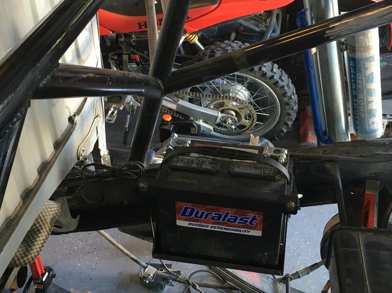

    Mounted mine to the inside of the frame. So far so good. Don't worry, I'm getting rid of the Duralast soon haha.

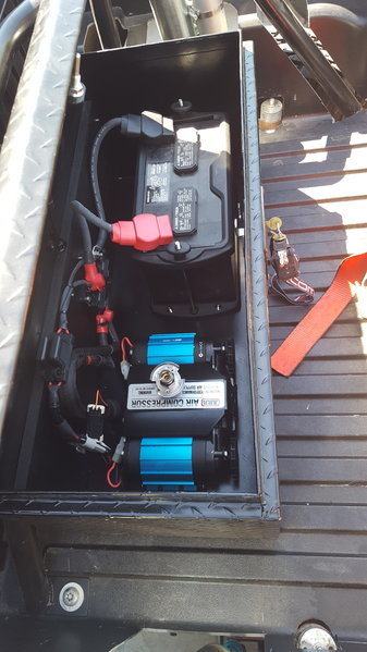

    I grounded mine in multiple spots in the frame. Helps get better grounding paths with all the random chassis grounds. But I just welded bolts to the frame and than ram the wire from bolt to bolt with the last one being up in the engine bay.
